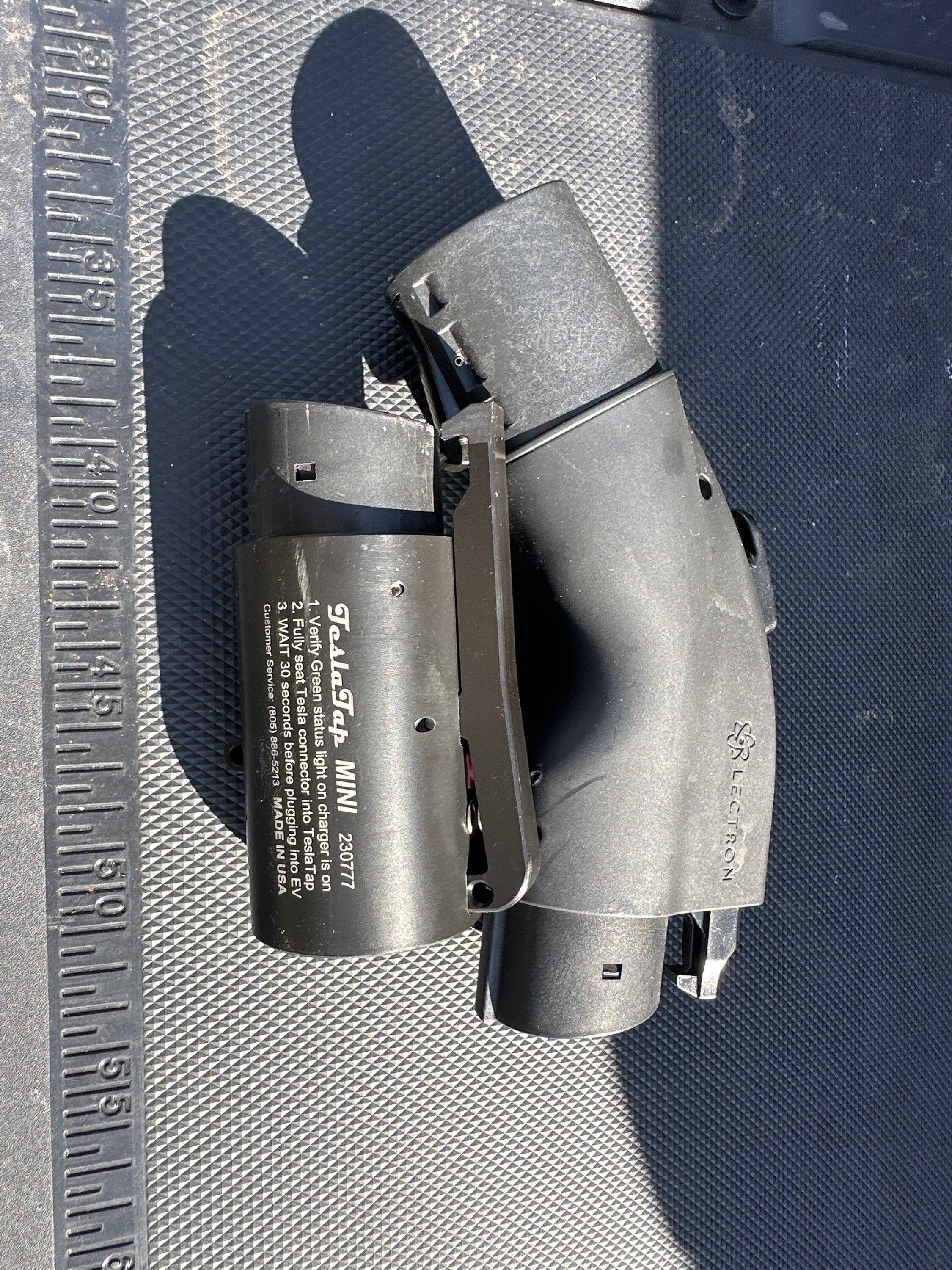

Since he's got a ER Lariat, I would recommend against the 48A Lectron. It's easy to forget it's only 48A capable and can cause a panic when you realize you're inadvertently charging at 80A...ask me how I know.
I have an ER lariat and it charges as fast as the Tesla will charge which is 48 A
3,812
6,962
He's commenting on the adaptor.
Since the truck can charge at 80 amps, and the adaptor might be used somewhere other than home, it would be safer to use an adaptor capable of handling the highest current the truck can handle.
That’s exactly it. I went Lectron to save money, ended up with a Teslatap anyway for the 80A.
