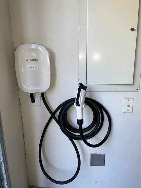

I am keeping my travel charger in the frunk for travels as I just installed my EVSE - 48A L2 w/ 60 breakers in my garage to share with my wife's PHEV and my incoming Lightning.
