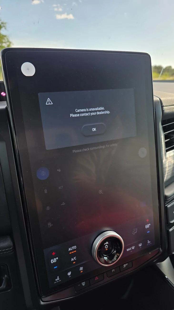

2025 F150 Lightning Flash
Lead Repair Technician
This is the second time within a month and 650mi that the camera system has done this. System works fine after doing a start/stop. First time was when the truck was brand new right off the dealer lot.
Anyone else have any experience with this issue? I do plan on taking it in tomorrow.

Weird one, contact the dealer I guess.
I had the chmsl camera fail and it doesn't give a fault like that. Other people have had other cameras fail but no message, just blank. They'll have a code so hopefully can get it fixed quick.
