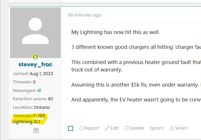

My Lightning has now hit this as well.
3 different known good chargers all hitting 'charger fault ' and red ring.
This combined with a previous heater ground fault that disabled the vehicle make it tough to want to own the truck out of warranty.
Assuming this is another $5k fix, even under warranty. It does not inspire confidence.
And apparently, the EV heater wasn't going to be conveyed by the EV warranty?
What year is your Lightning?
