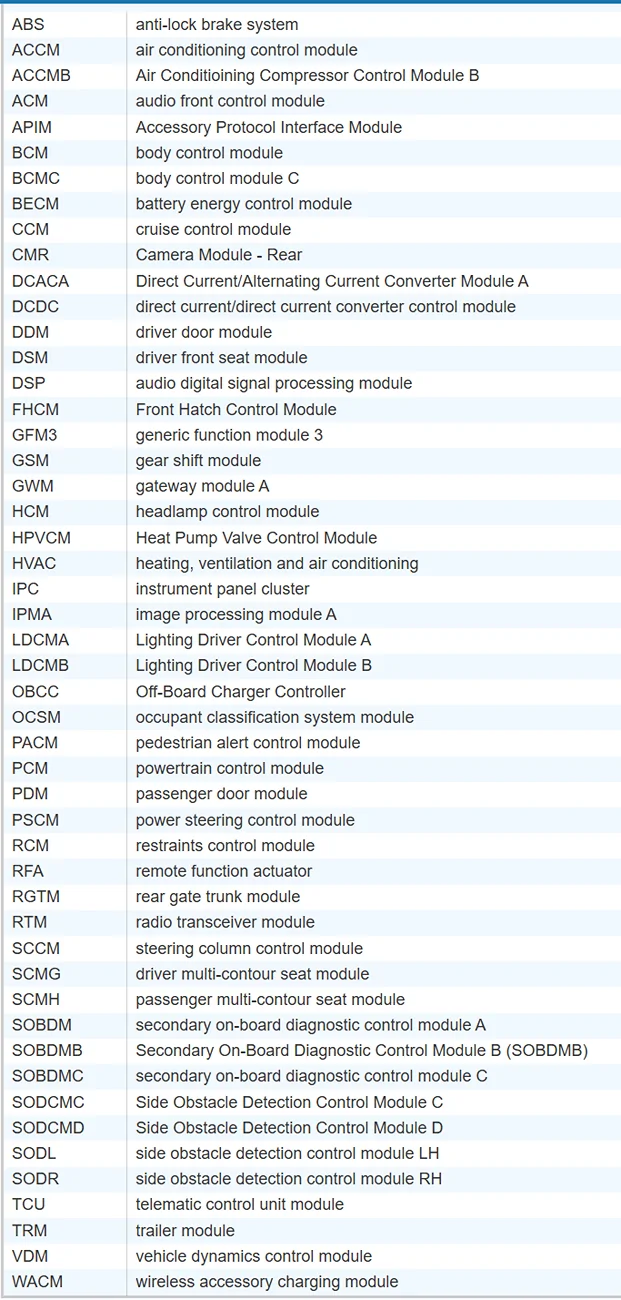

I guess we need a comprehensive list of all the acronyms and their functions?! :)
here is a list of the modules on a 24 Lightning
Ford F-150 Lightning SOBDM Failure 1776027754380-xn
But The SOBDMB and C are the Motor controllers.
Sobdm A On Board Primary Charger
GFM3 7.2 Inverter
GFM2 Second On board charger for 22-23 trucks

Sobdm A is the on board Charger..
SOBDM B and C are the electric motor controllers(Maybe the wrong term but they are the motor invertor /controler?I dont know but they are related to the electric motors.).
GFM 3 is the second inverter for 9.6 pro power
GFM 2 would be the second on board charger that enables 80 amp charging
Thanks for clarifying. The manual kept calling B and C inverter controllers (ISC) and I wrongly assumed ProPower. But yes the motors I believe are AC and so there would need to be an inverter that converts the DC to drive them.
