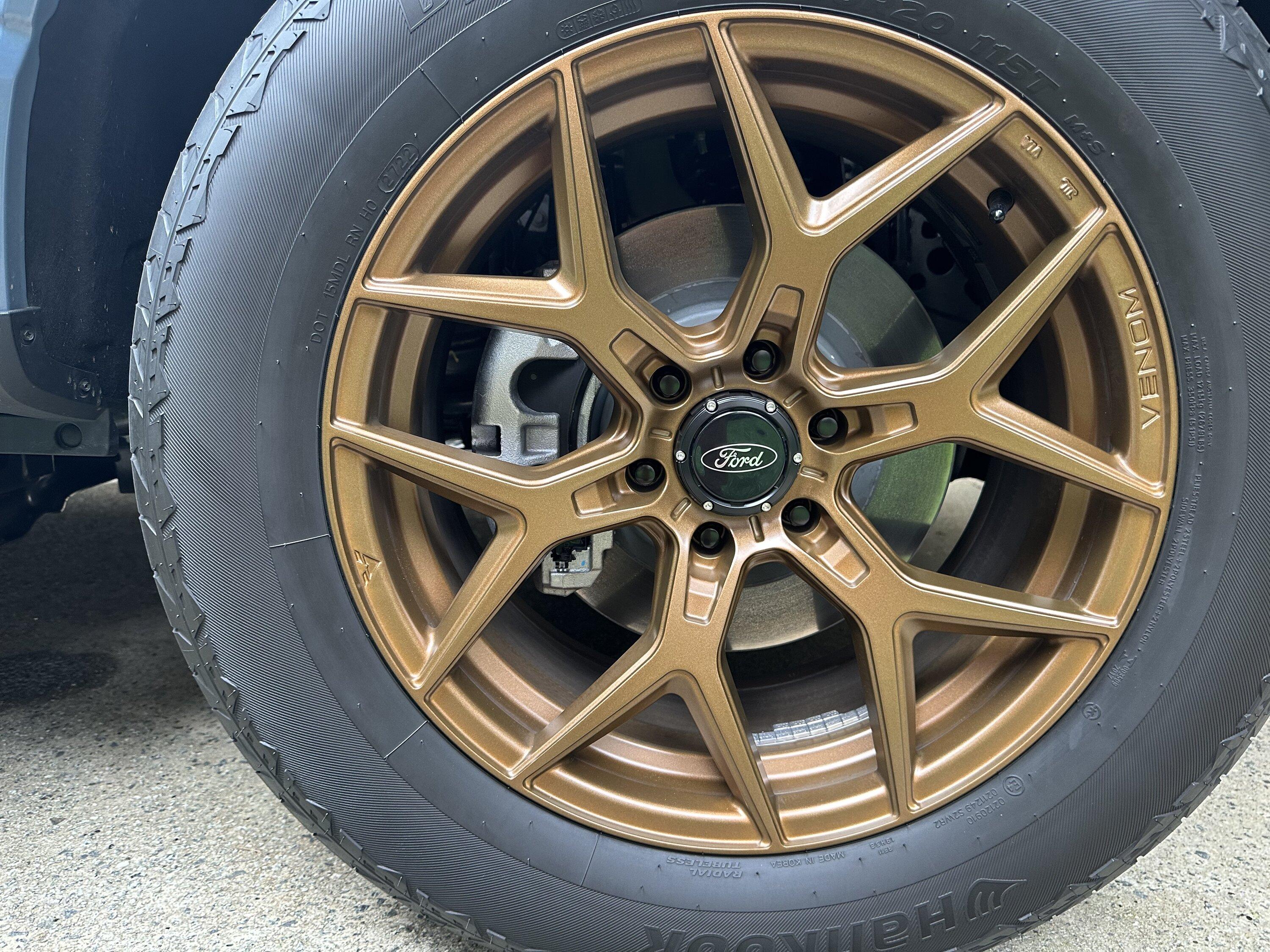

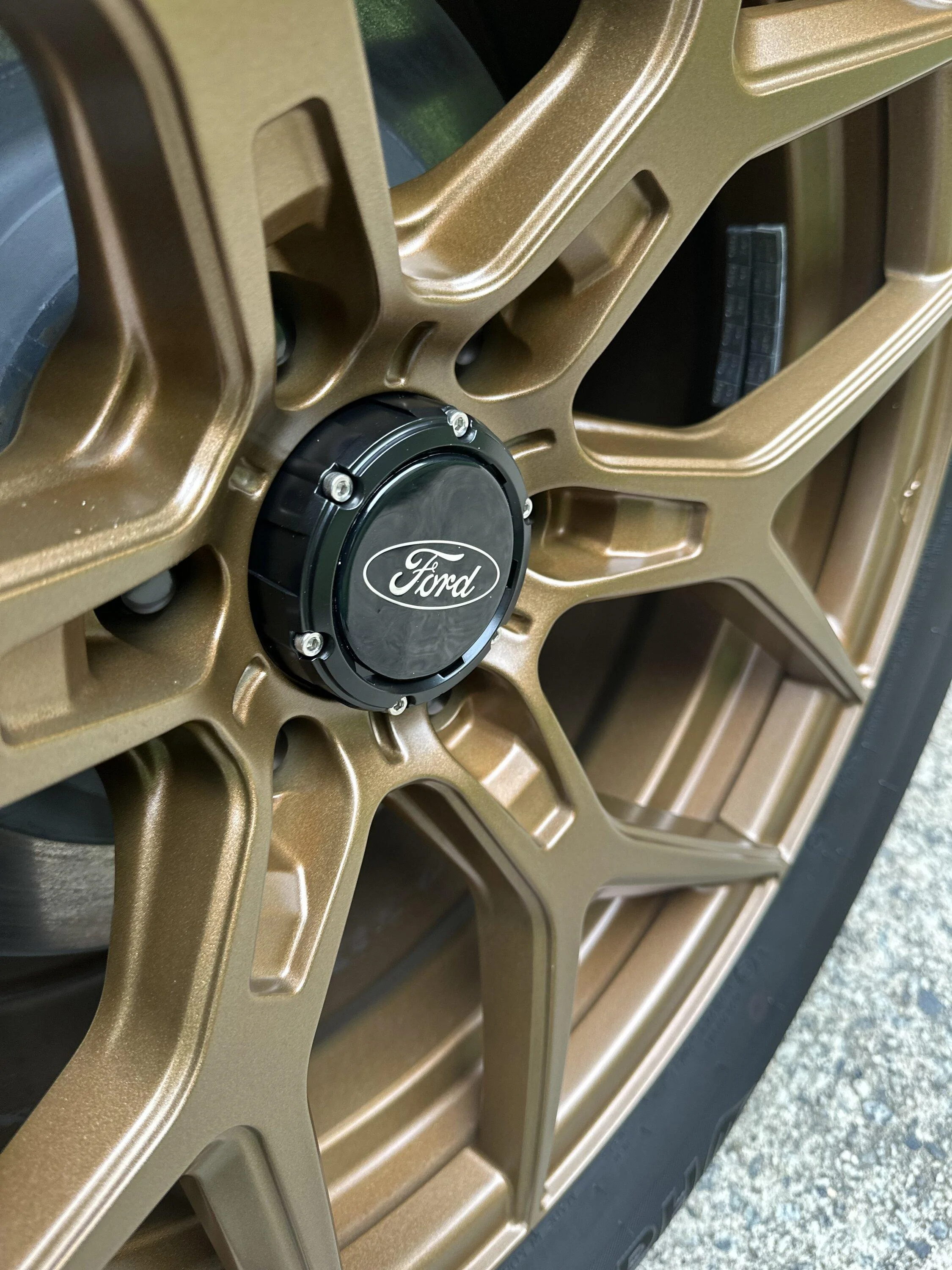

FYI, OEM Ford center caps perfectly fit the centercaps of VenomRex VR601 wheels.

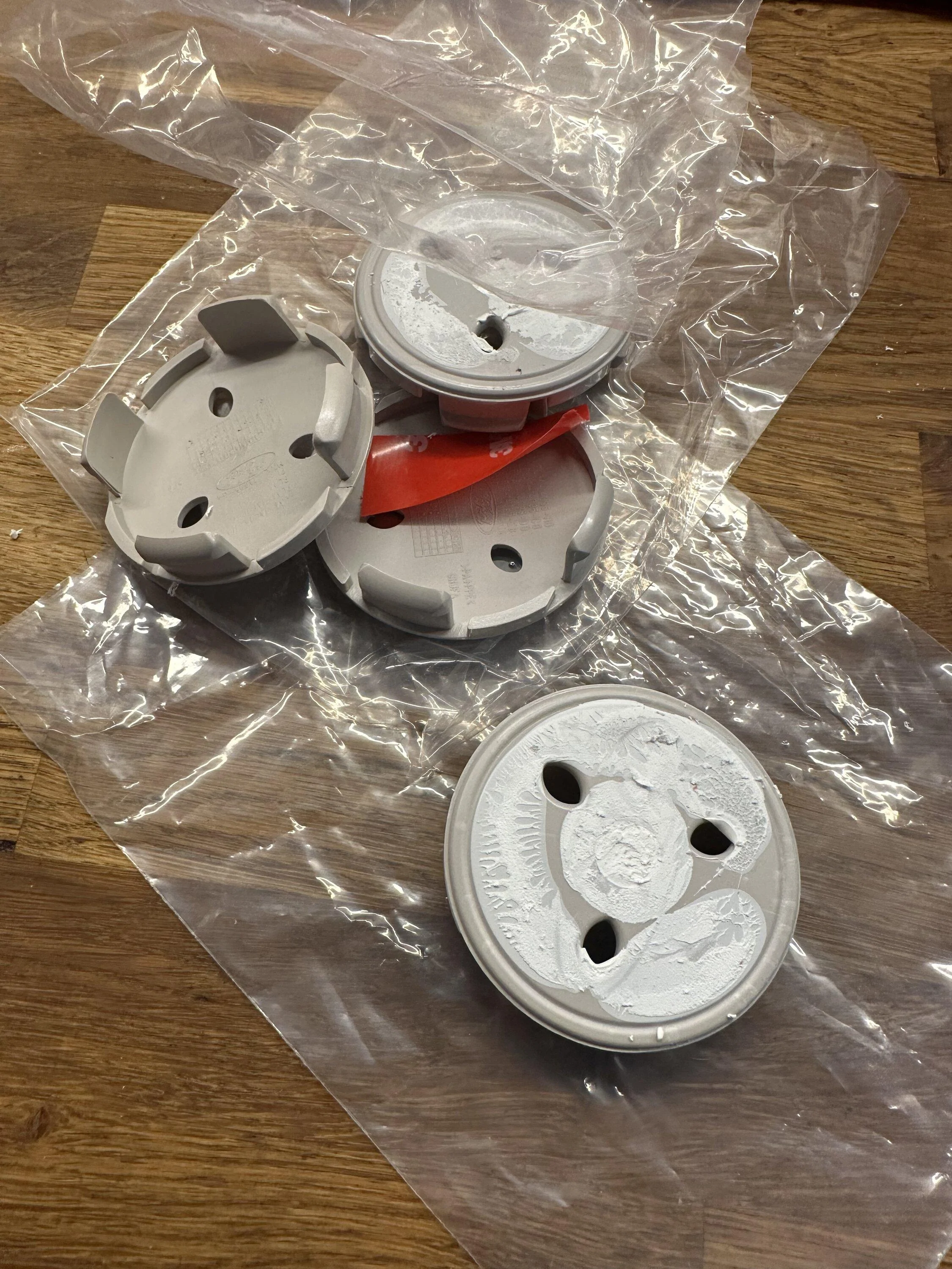

It requires a bit of modification because you have to remove the original backing. I used the heat gun and a plastic trim tool, and the metal FORD plate comes off. Be careful, go slow.
I then used a few layers of double stick automotive tape and it bonds right on. The size is exact. Very pleased with the OEM look of aftermarket lightweight wheels.

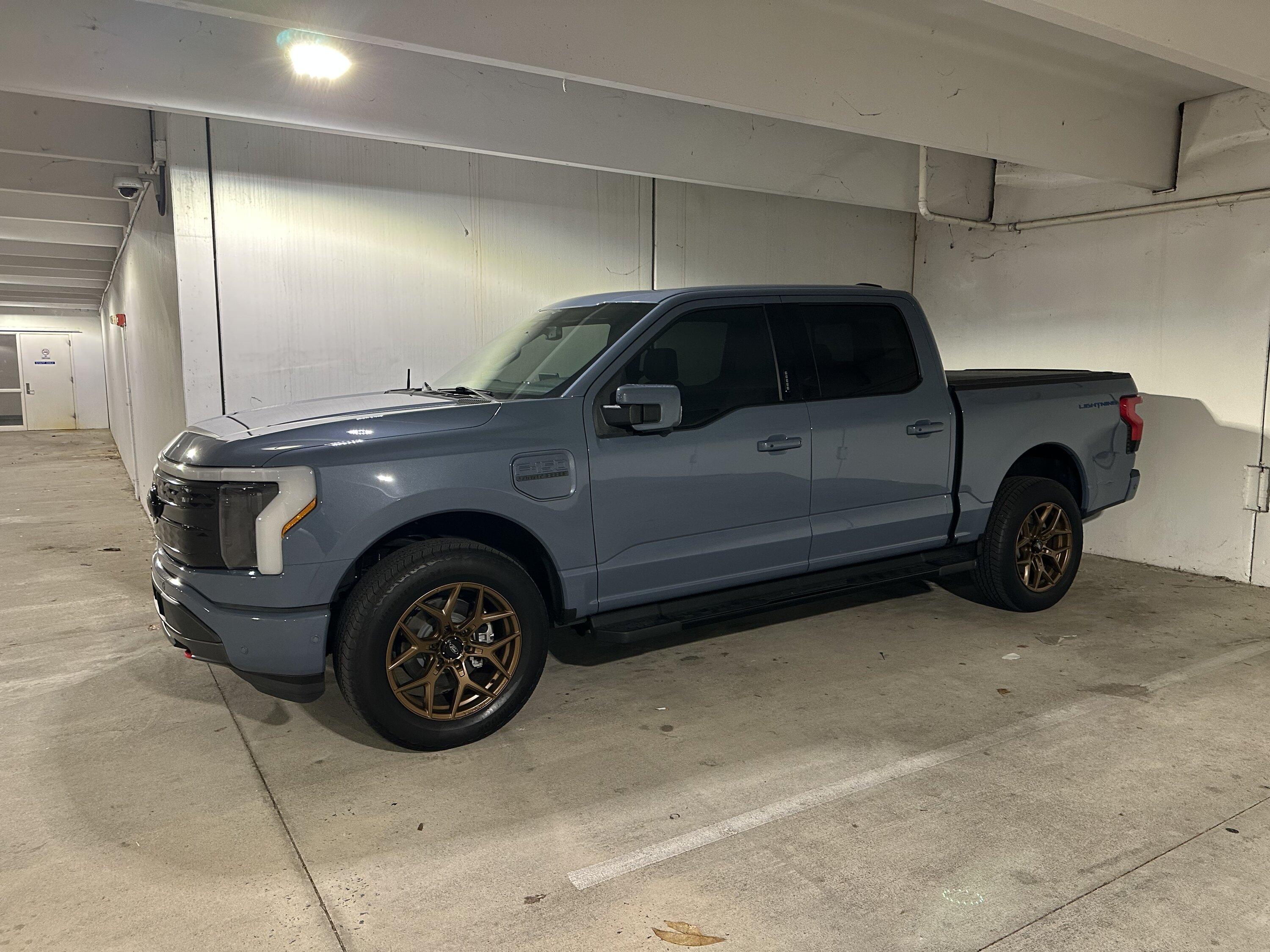

20" there is only one width. Stock tires fit perfectly! Saved 13lbs+ per corner. Exact same mileage. Look great

12mm I believe. The stats are on the website. Barely noticeable but do look better than stock with a better stance
