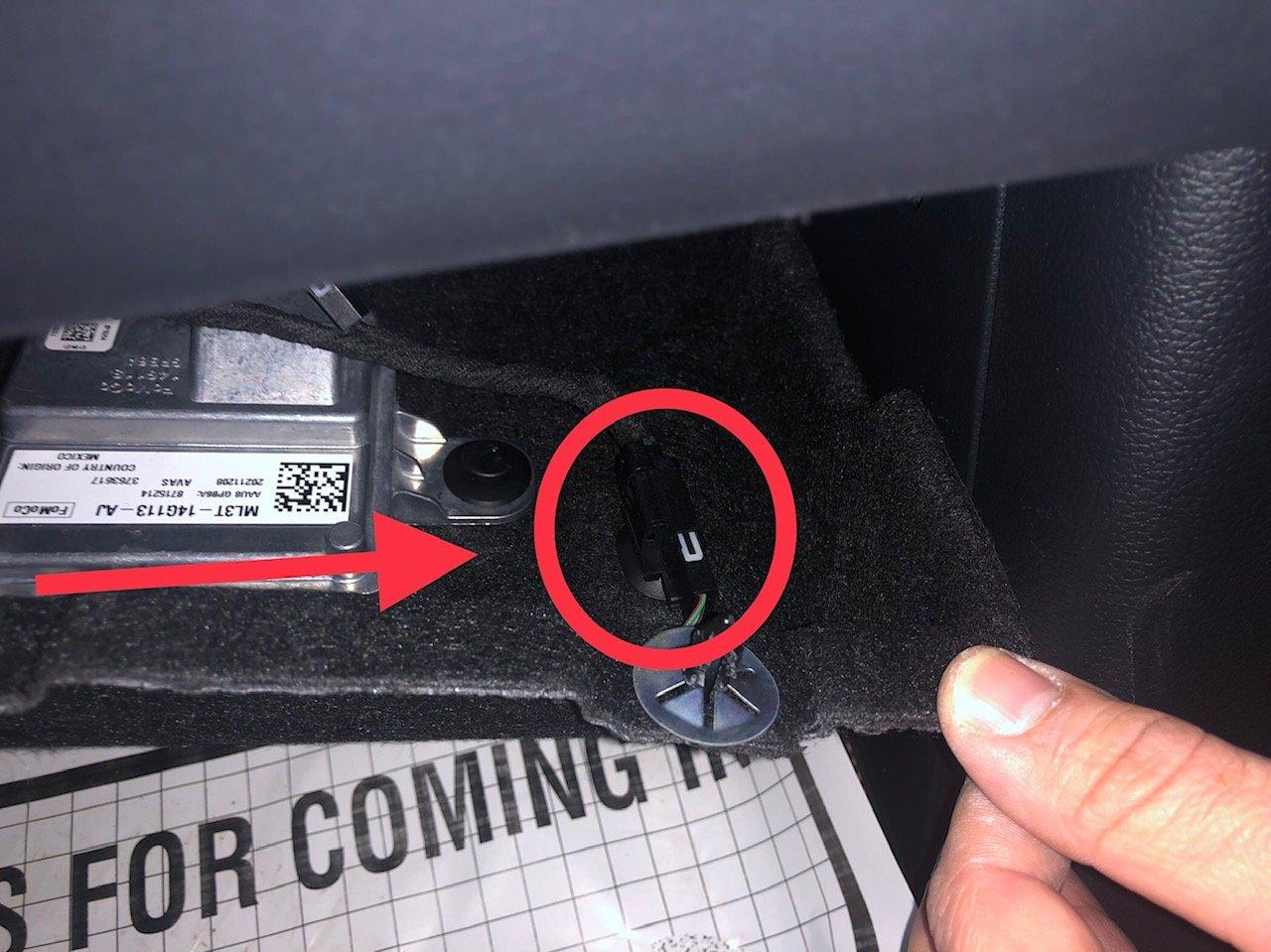

15. run the harness that now has a T in it to the ambient light in the foot well(see picture below)

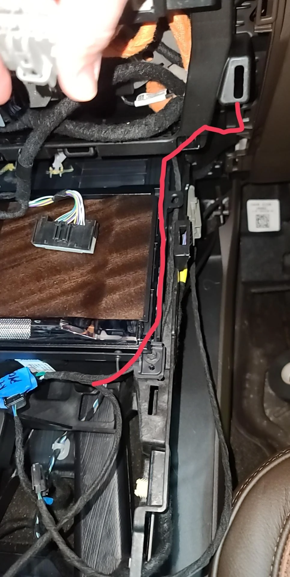

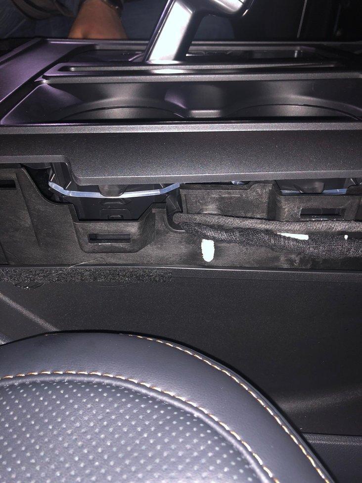

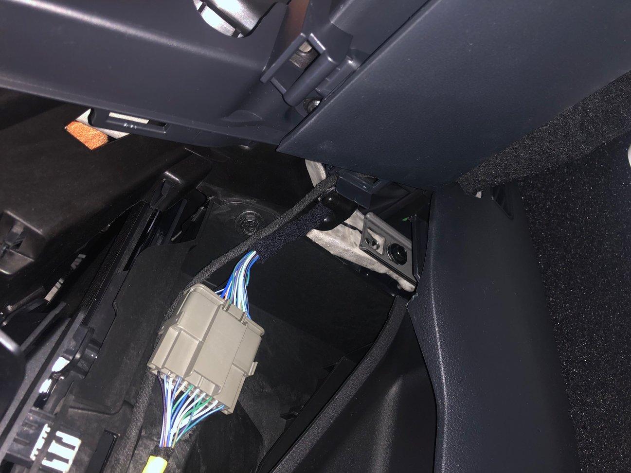

now route the harness over towards the center console and fish it through along the side
Ford F-150 Lightning Cup holder light installation/media bin light/glove box light img_1622_7d306dc10701eb1c818b770111b2170b6a2ff9f2
route the harness down along the side like this
Ford F-150 Lightning Cup holder light installation/media bin light/glove box light img_1623_e0225f0857ed012c02c2dad5ffbaaf3c98b56d34

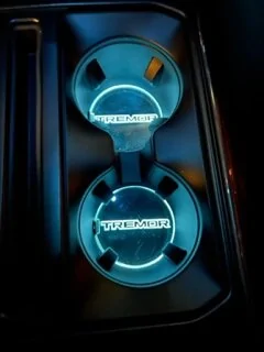

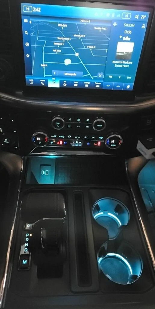

plug it into your cup holders and test everything, to turn ambient lights on for testing i always turn my parking lights on and then go into ambient lighting menu and turn them on to max bright. and heres the finished product

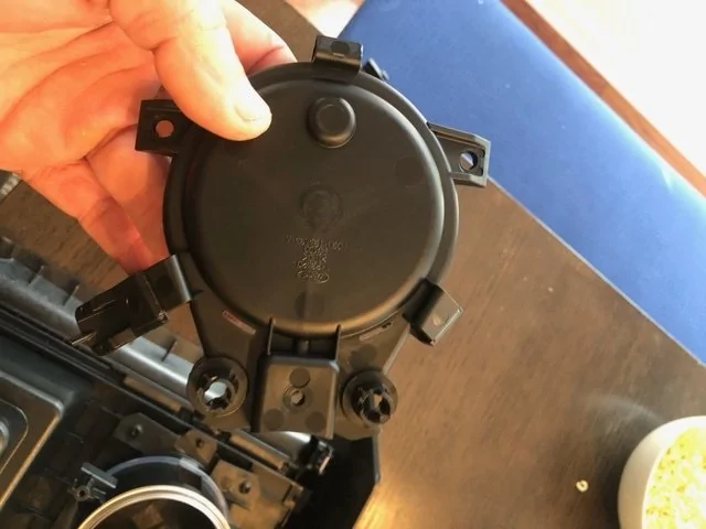

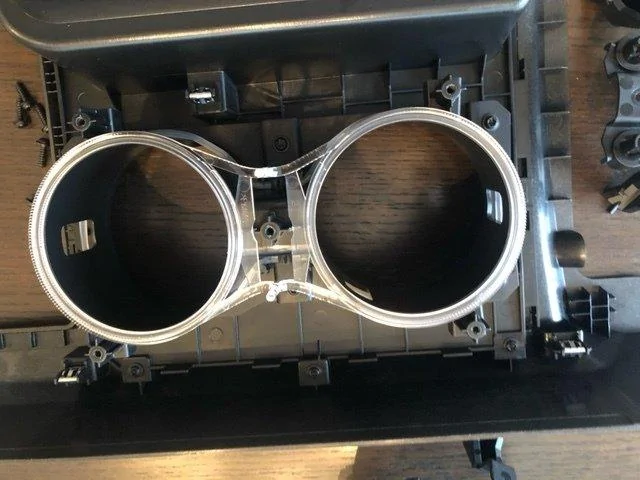

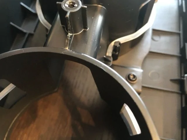

with your cup holders taken apart youre going to install the light ring
Im not fully aware about the F150 but on the super duty cup holders you have to trim the plastic around the center screw like this it will allow the light ring to sit flush.
on the super duty we have to bend the cup holder holders so they will grip the cups again properly here is where we have to bend ours on the super duty, the F150 might be the same which is why im putting this in here
img_1308_f6e798065108535bac92b7941a682a93d0e65f5d_3b70e3f3baae836dfef72cafacff31610f7ccb34_e19...jpg

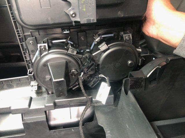

now that you have all that done put your cup holder back together and attach the lights like so

now for the cup holders this harness is very easy to run. drop down the felt liner in your passenger foot well like this, youre after the connector I have circled here, unplug it and the harness will T in between it.

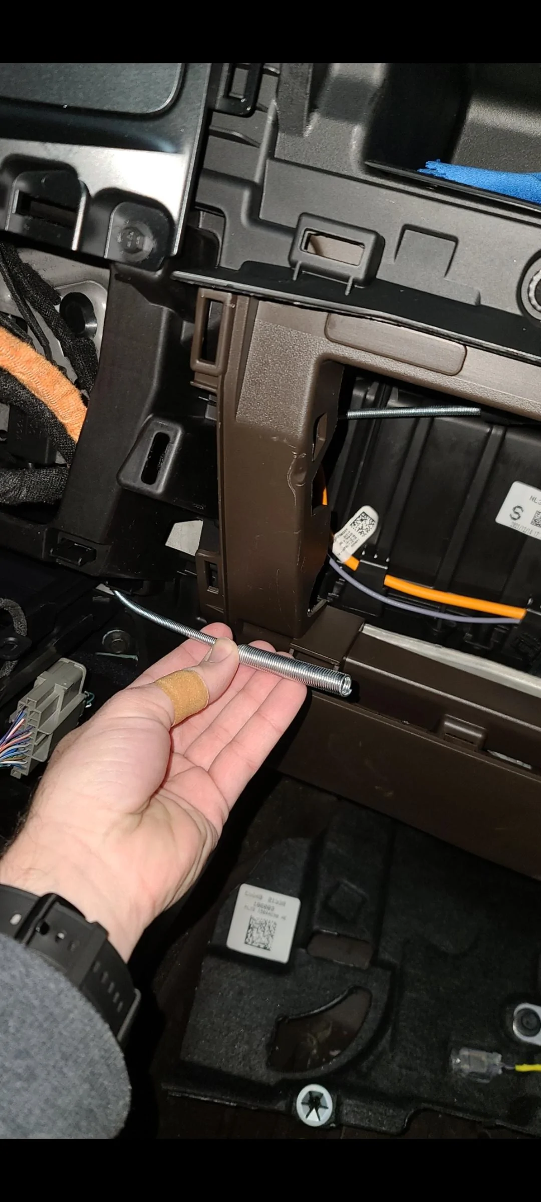

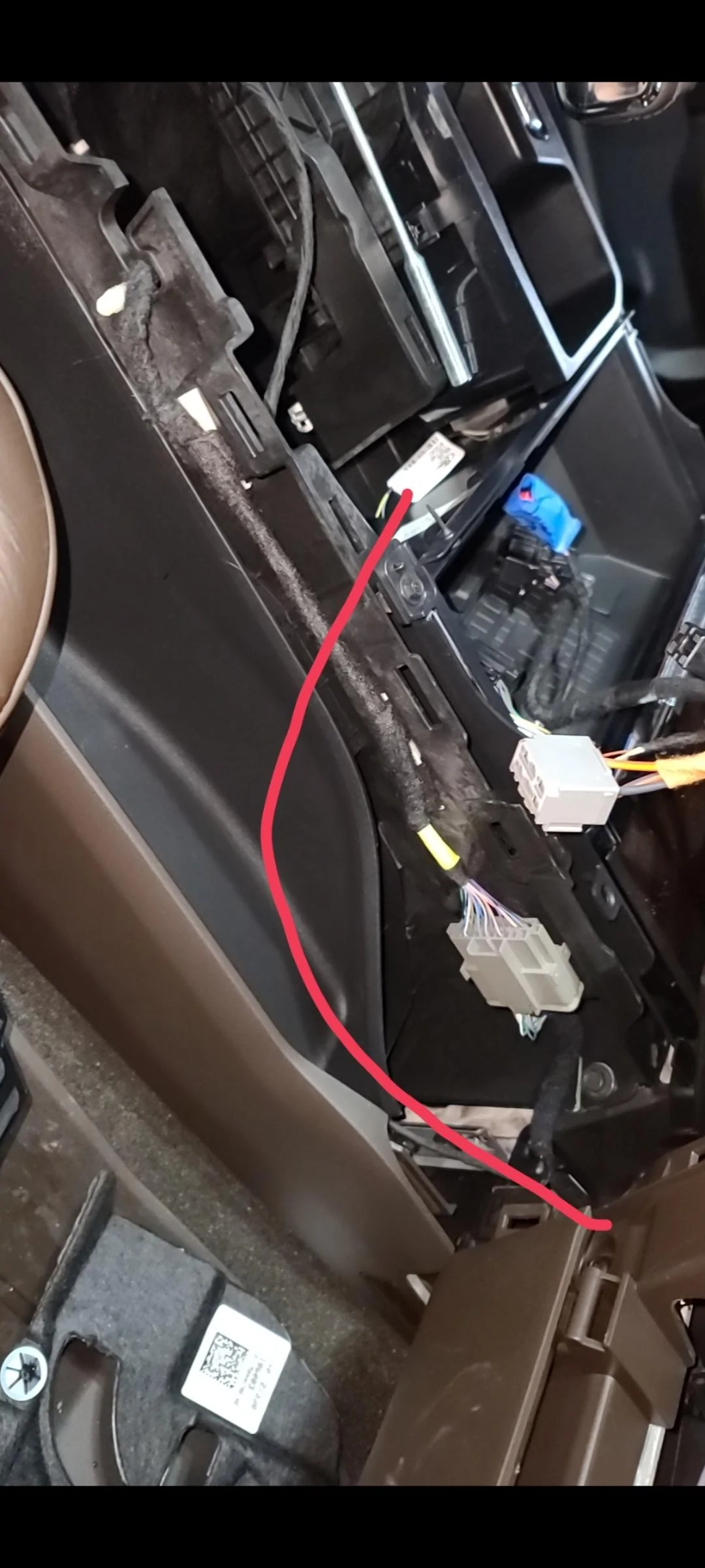

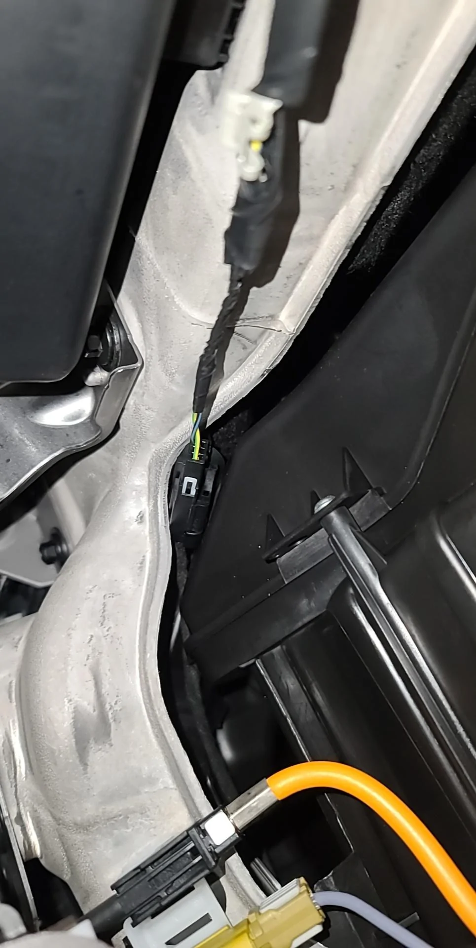

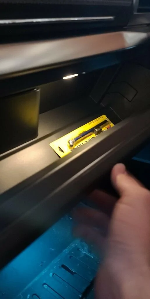

There are 2 ways (that I saw) to fish the wire to the glove box. I was using a "prototype" harness that is a tad shorter than what he's building now, which is why I ran it along the media bin sliding cover as he showed above (the red line).
This requires snaking it around a corner under the main touchscreen. I accomplished this with a flexible grabber (see first pic below), which wasn't fun.
A slightly less unpleasant way would have been the red line on my second pic. Run it down under the side cubby (you can partially un-clip the trim piece between said cubby and floor carpeting), and you can push the connector under the cubby, and then up into the glove box.
I recommend using the push clip attached to the glove box light to hold it up against the steel that frames the glovebox to keep the wire from interfering with the glove box closing (this was especially important on mine, as my glove box has always had an issue staying closed... It fell open on my first drive home from the dealer even...)
