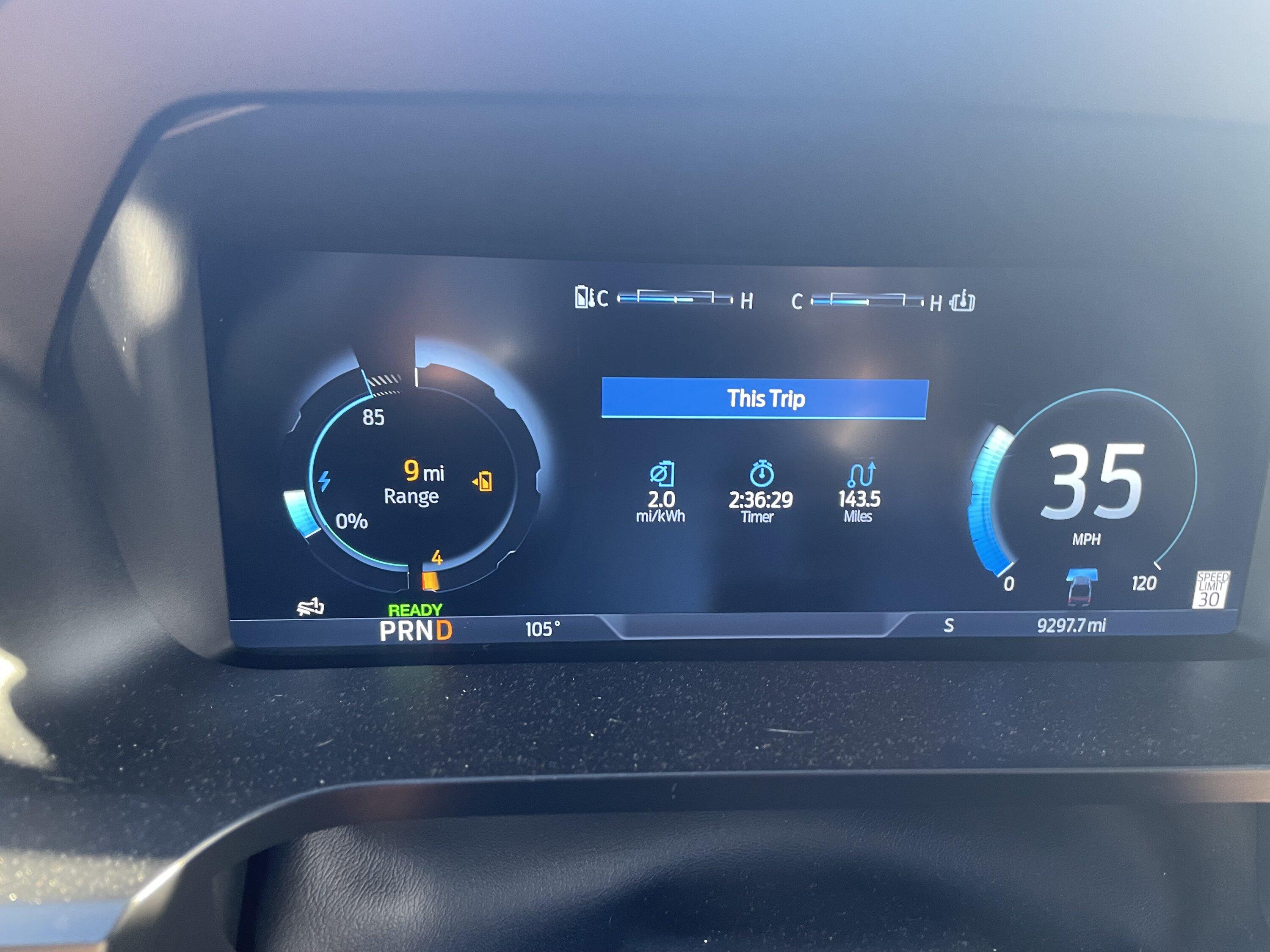

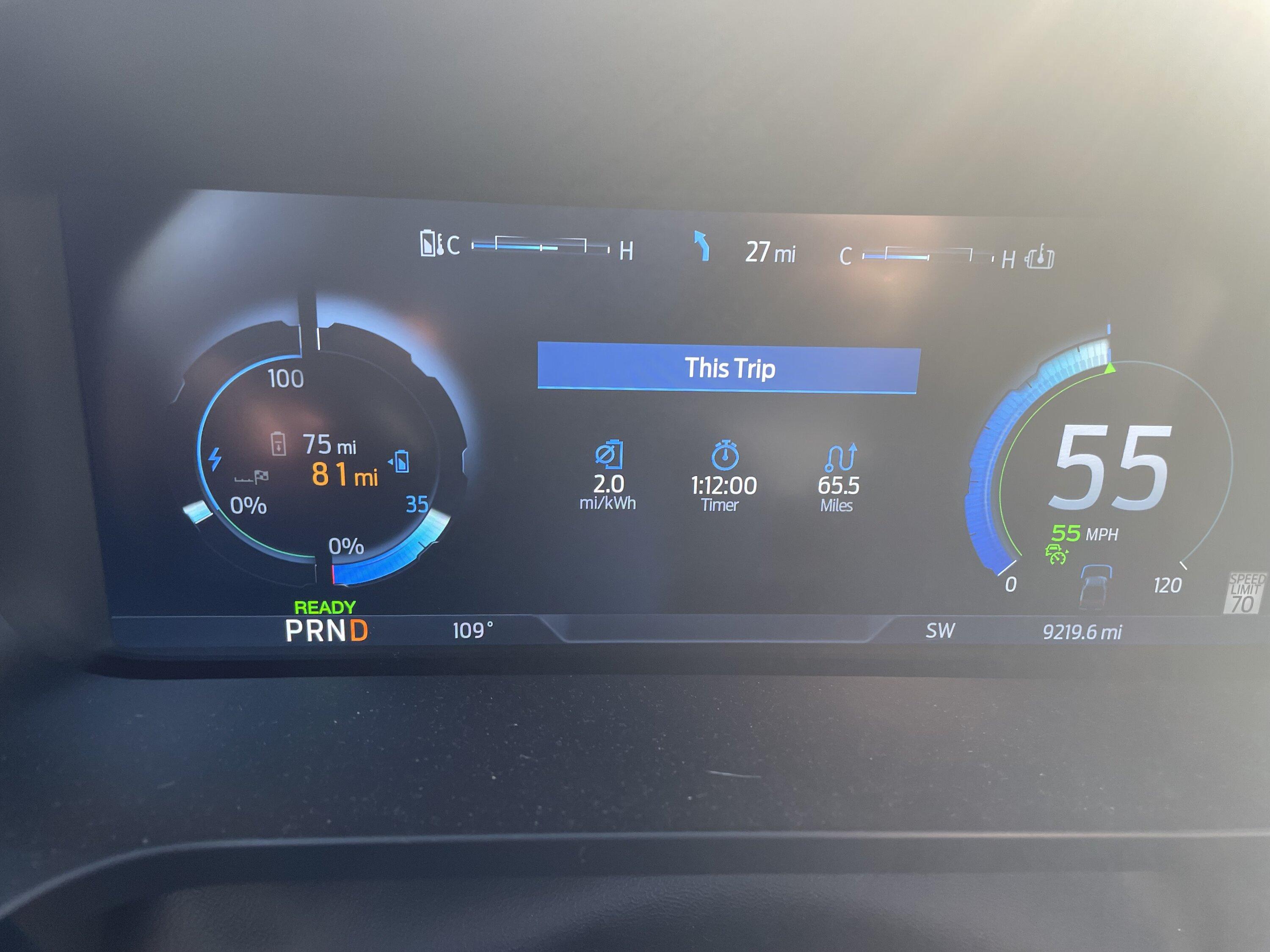

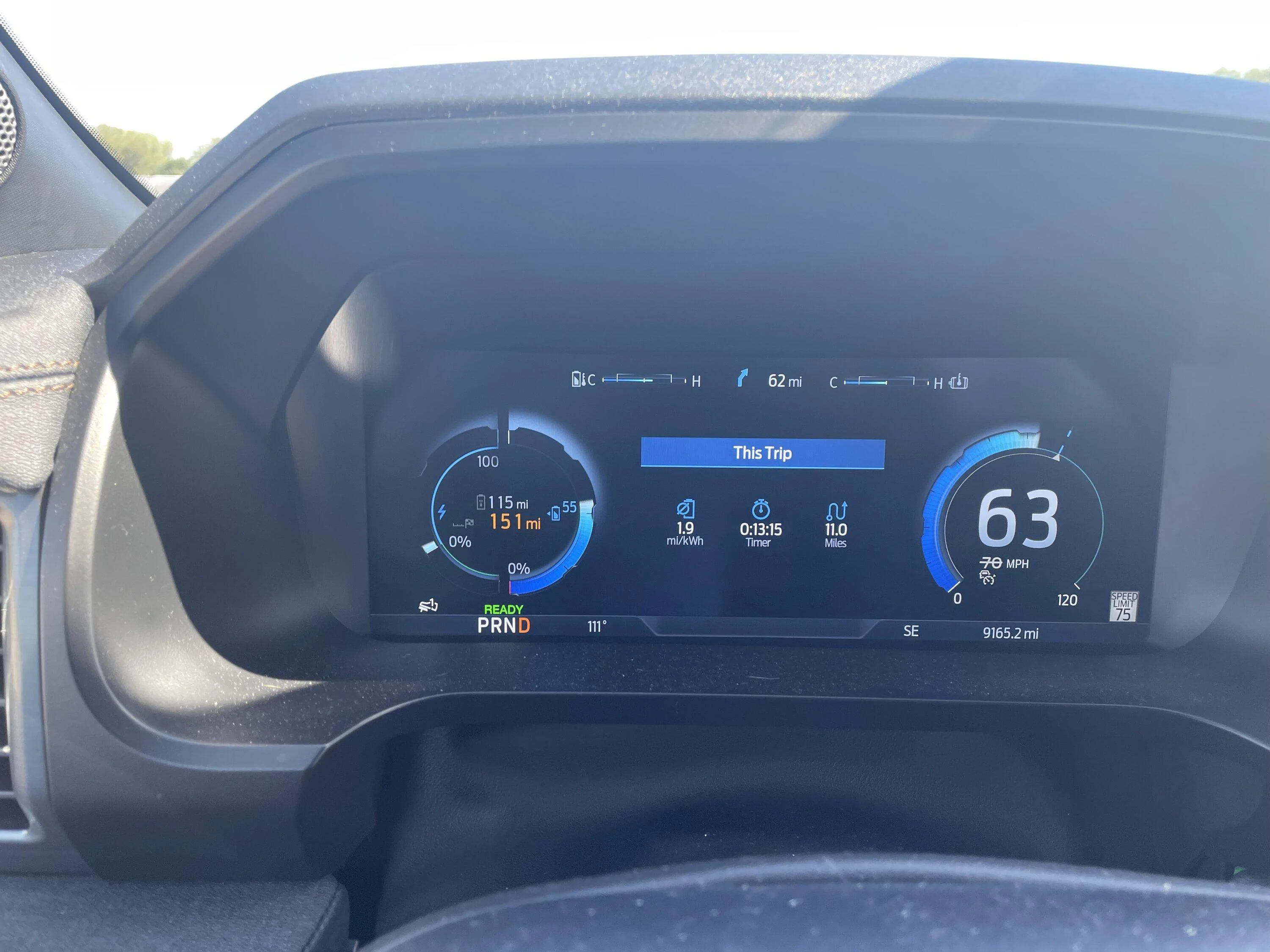

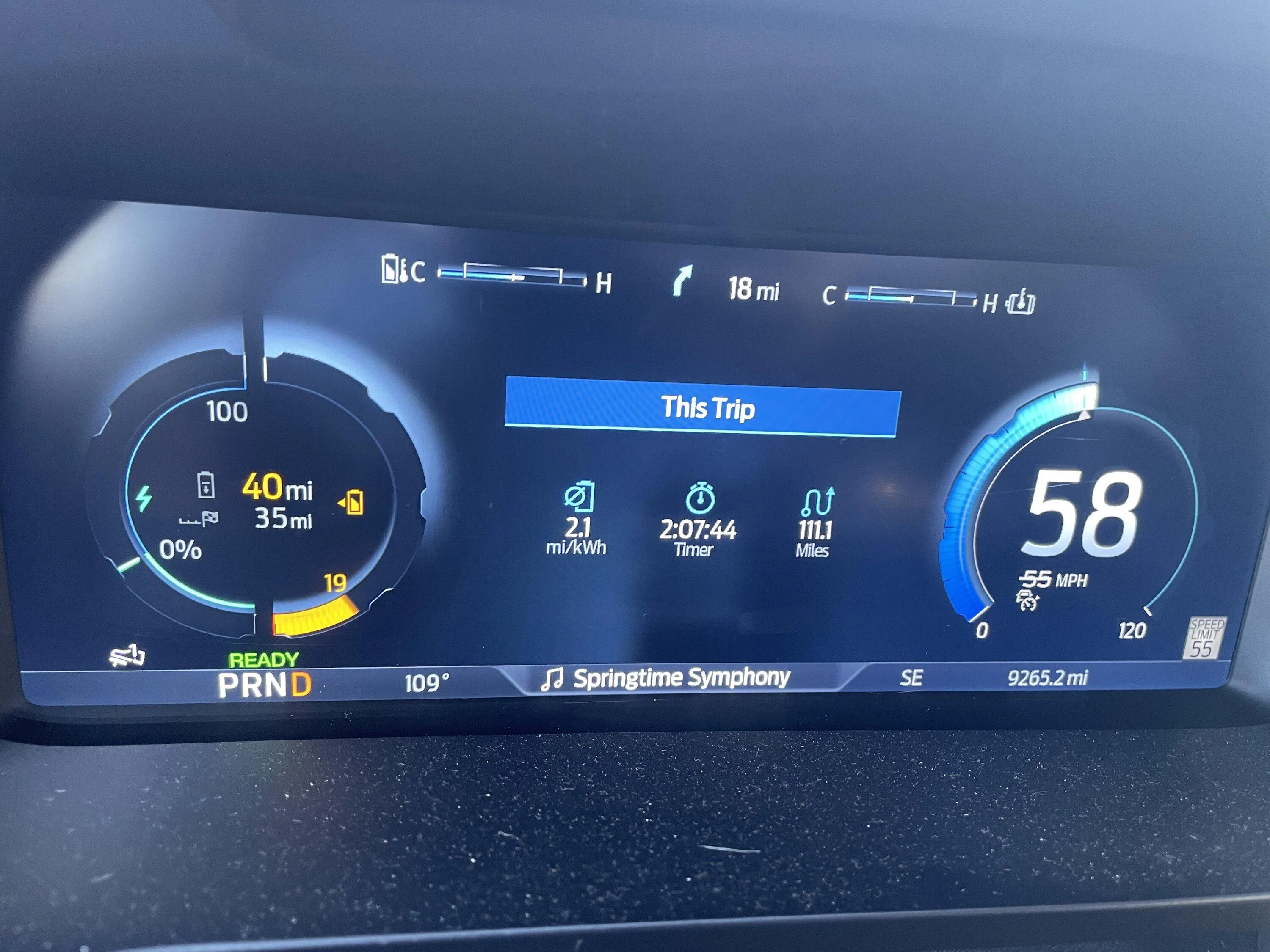

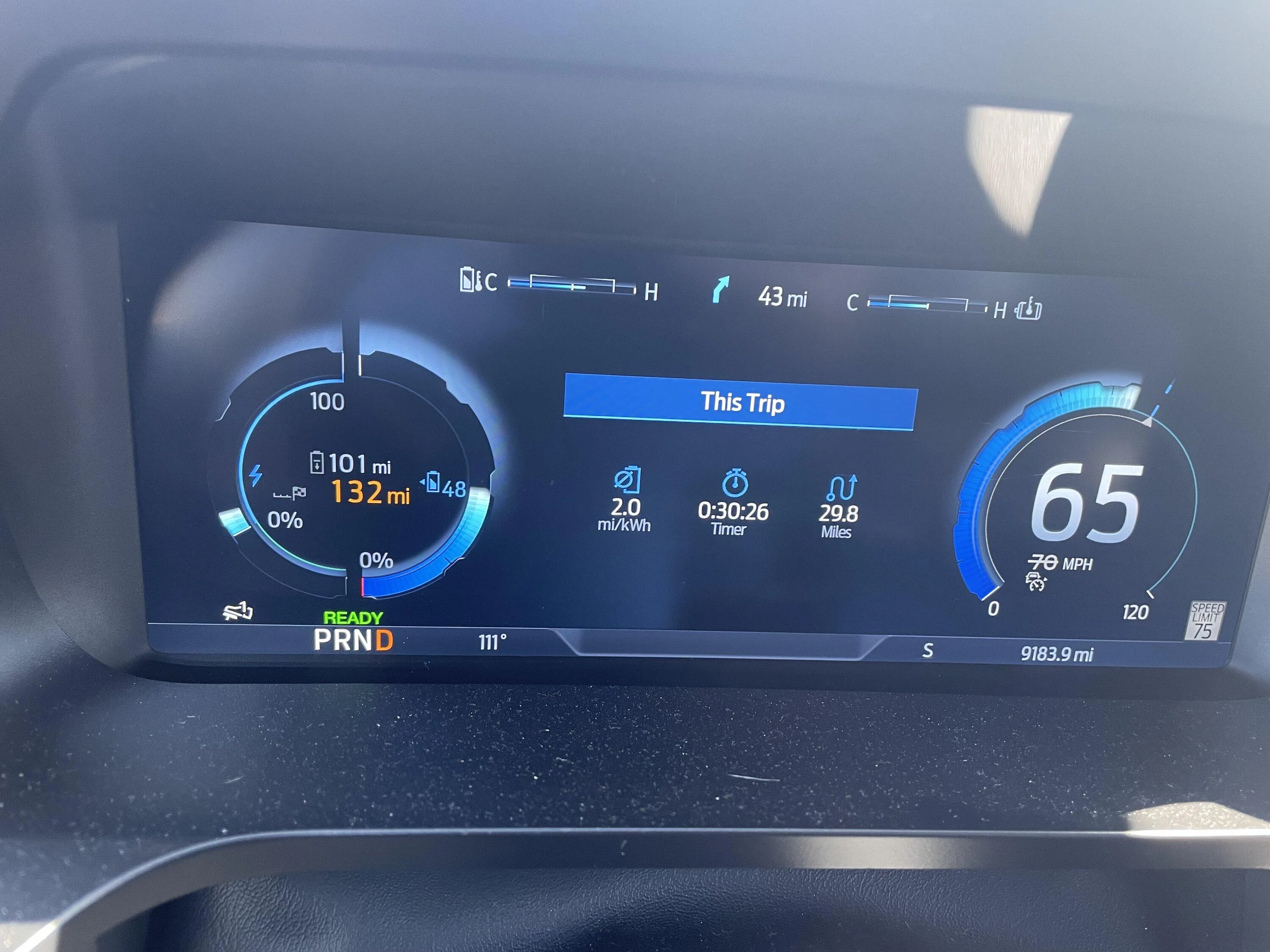

I ventured out at 59% and drafted as many 18-wheelers going 65mph as I could on the interstate, and stuck to 55mph on the 2 lane highways, moving over on the shoulder to let people pass (more the 30 times getting friendly thank you waves or light flashes before I stopped counting). I did have a couple Level 2 chargers about 15 miles short of my house if I was really not going to make it, but for the last 25 miles or so I was feeling good about it and went up to 70mph again. I made it home with 4% to spare.
