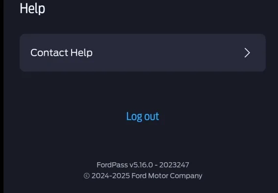

FYI: 5.16.0 is now available for Android.
Ford F-150 Lightning Departure time enabled by itself...I am missing something? FP_5.16
I still have the 5.15.0, any reason why you posted about 5.16.0?
Just to make people aware that it's out there now. I'm assuming there's some bug fixes, so if someone is having FP issues (as you are seeing) they could try to force the update and see if it helps with the problem.
It will likely get pushed to all Android users at some point, as has been the usual for past updates.
