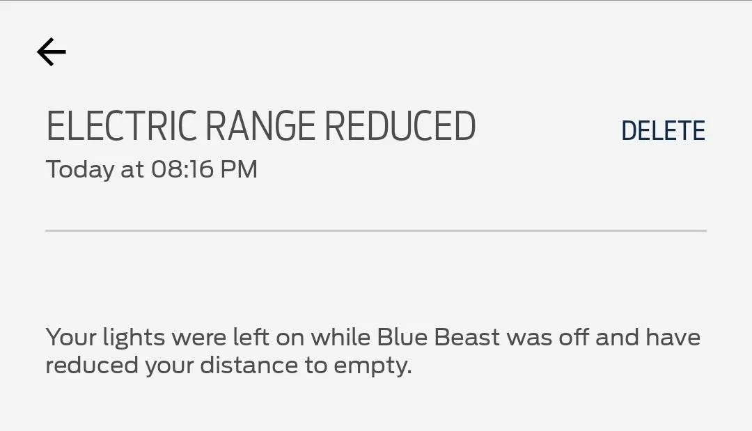

amusingly this hasn't happened on my Mach-E but has happened on the Lightning once already.
I didn't realize until FordPass warned me. ?
