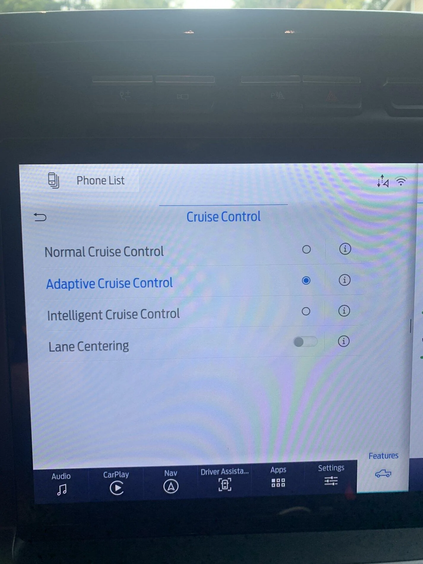

It's possible, I need to go out into my truck to check. I know lane departure still works even when you don't have cruise on, so there might still be a way to leave that enabled with lane centering off.
Edit: Went out and played with my settings and it appears this combination would disable the active lane centering, where it’s steering for you all the time, but keep the safety feature on that kicks in if you’re about to drift out of your lane and correct it. (Adaptive cruise could still remain on as well)
Cruise settings:
Ford F-150 Lightning Issue Towing TT with Lane Centering 1626806131890
Lane keeping:
Ford F-150 Lightning Issue Towing TT with Lane Centering 1626806197244
