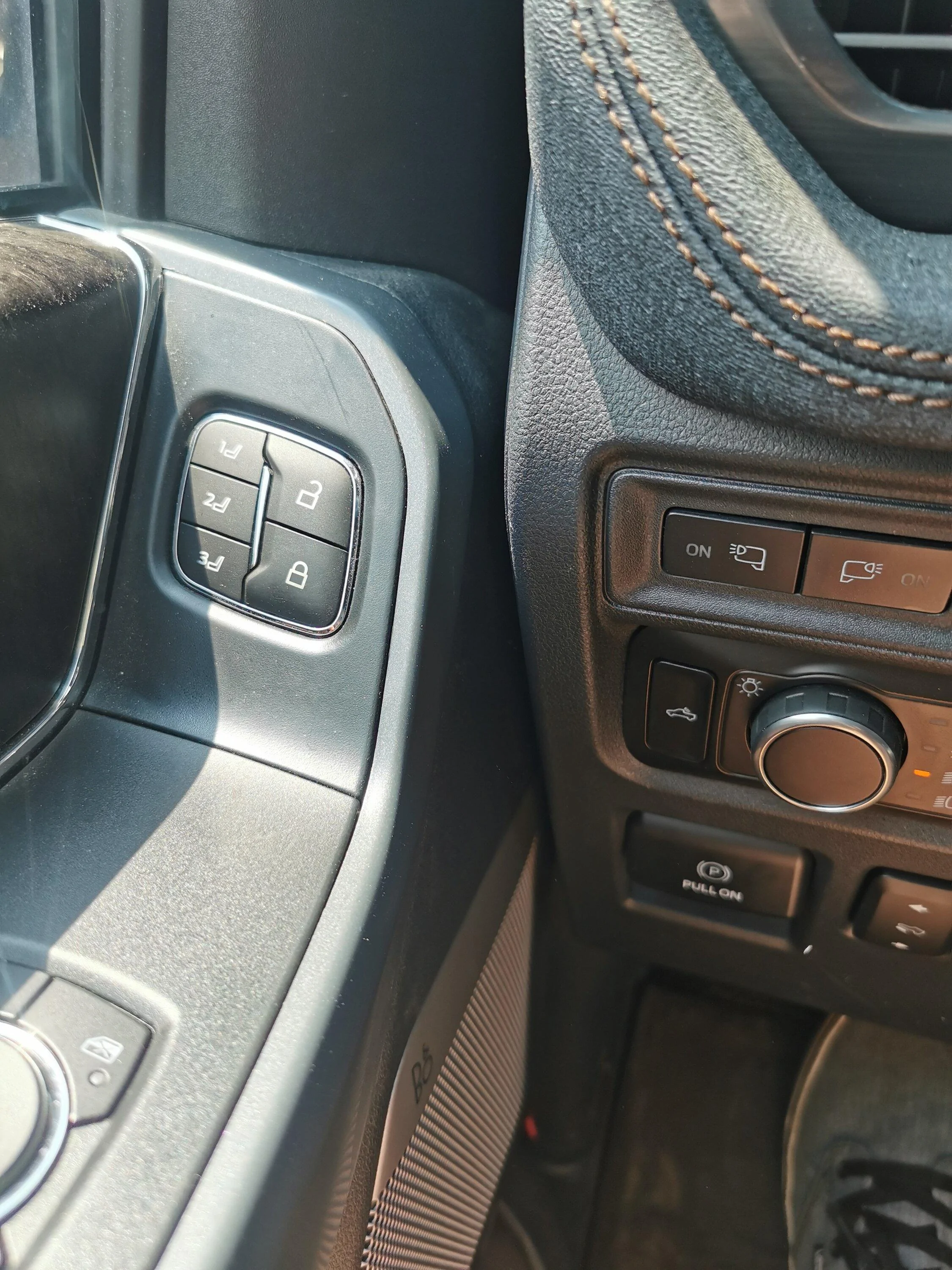

The "rattling" is most likely coming from the plastic parts of the door and the dashboard near the mirror.
I had that noise occasionally but I jammed my hand in there a couple times and it seems to have stopped. I'll attach a picture later.
