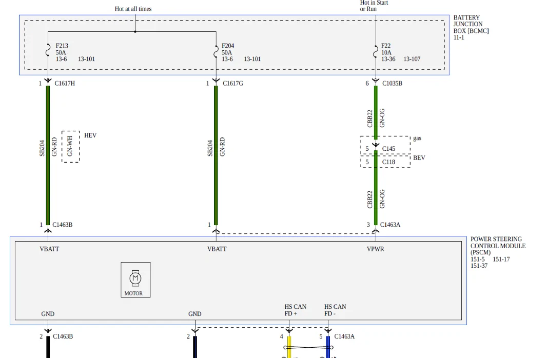

FWIW, my owners manual shows a 10A fuse for EPAS and two 50A fuses for the PSCM. The PSCM is integrated with the EPAS. Service manual shows it this way:
Ford F-150 Lightning electric rack draw 1787947964804-s4
As far as running it off the HV DC bus - if the HV bus trips due to a battery fault while driving, you will still have power steering since the 12V will still be good.
