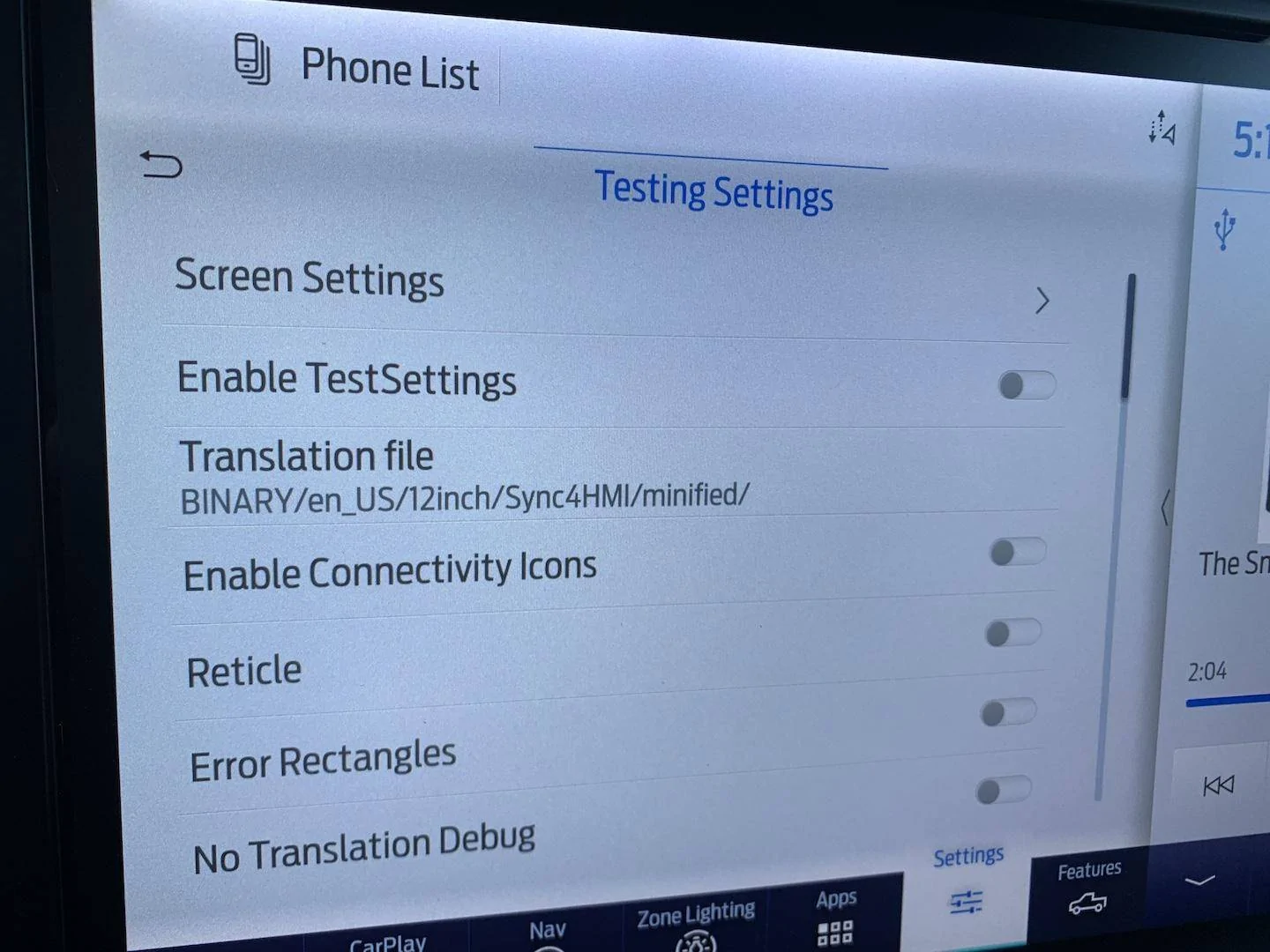

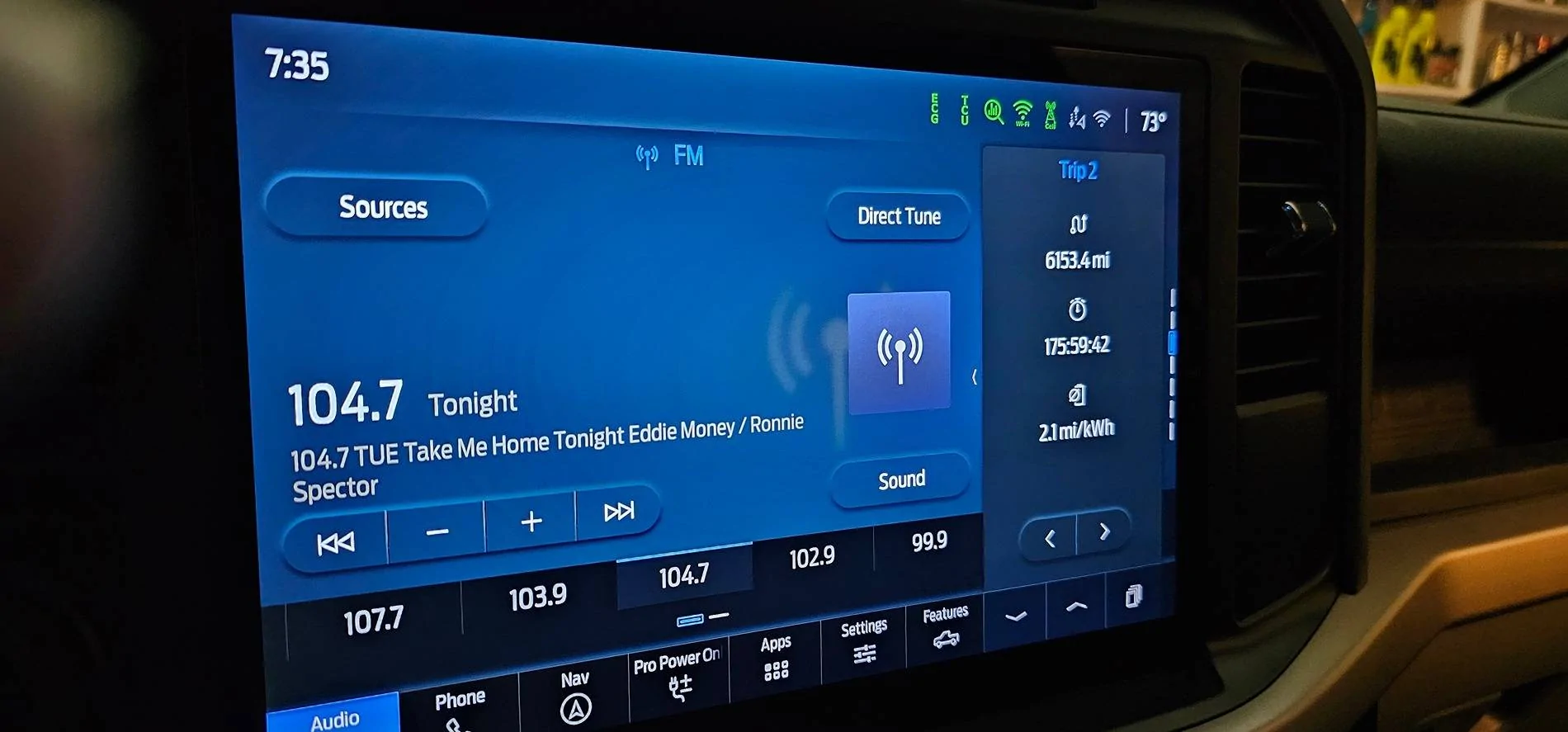

Also, is there any way to test the cellular signal from within the truck?
Yea, there's a way to turn something on that shows if your truck has good cellular data connection on the ICE trucks. It shows these symbols up top. I assume it would work on the Lightnings too, but not sure. I don't remember how I enabled them as I've had it there forever, but I'll find out.

Worked exactly as described.
This is sitting down in the garage so I'm very happy! Great info to have, thank you again.
Next song was Van Halen, now I'm stuck in my truck...

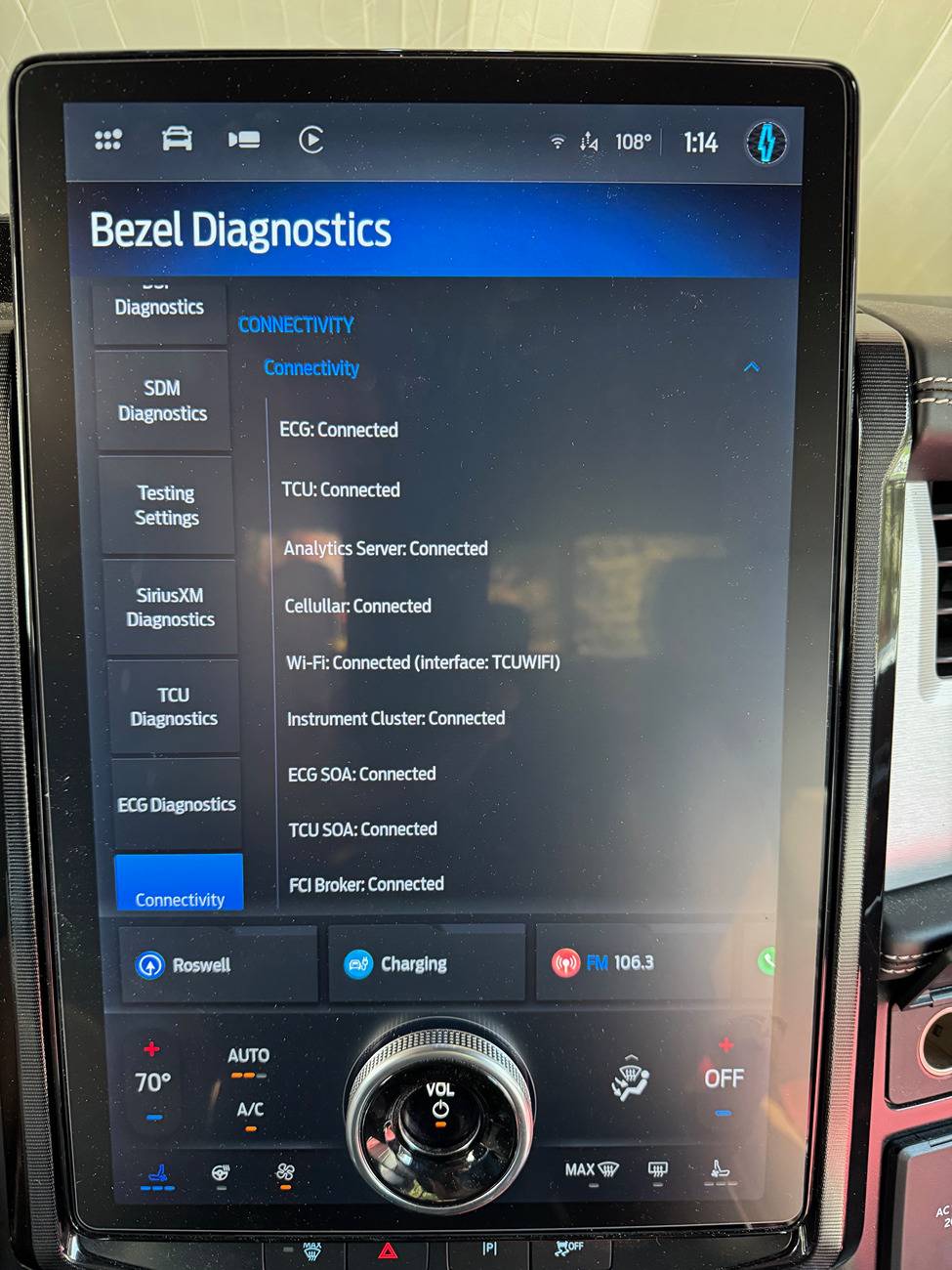

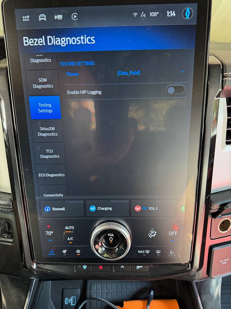

On my 15" screen I can get to Bezel Diagnostics, but the "Enable Connectivity Icons" option is not visible.
Ford F-150 Lightning Encourage Software Update? Bezel Diagnostics Testin
Ford F-150 Lightning Encourage Software Update? Bezel Diagnostics Connectivity
Possible this only works on the 12" screens? I'm not sure, tbh.
