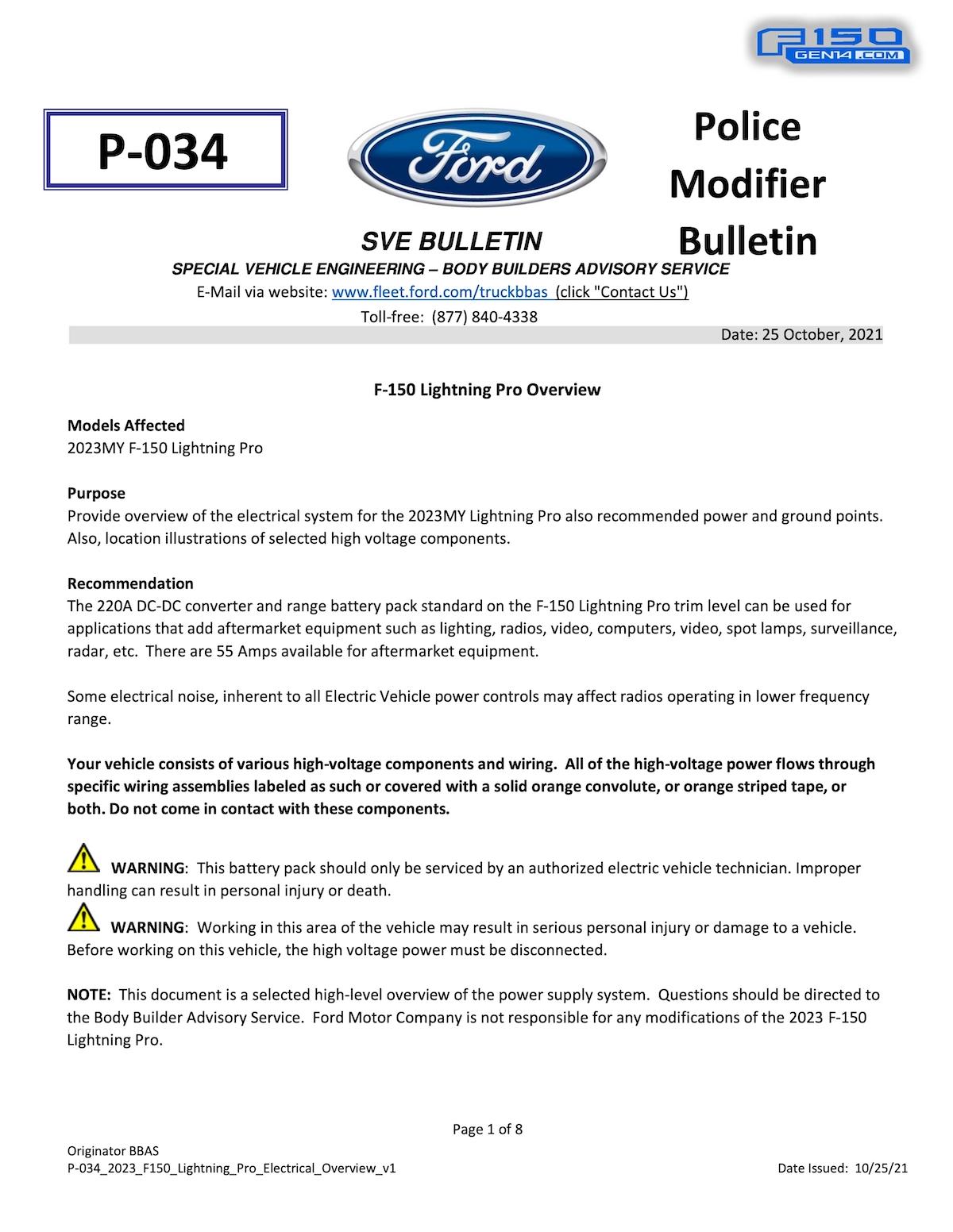

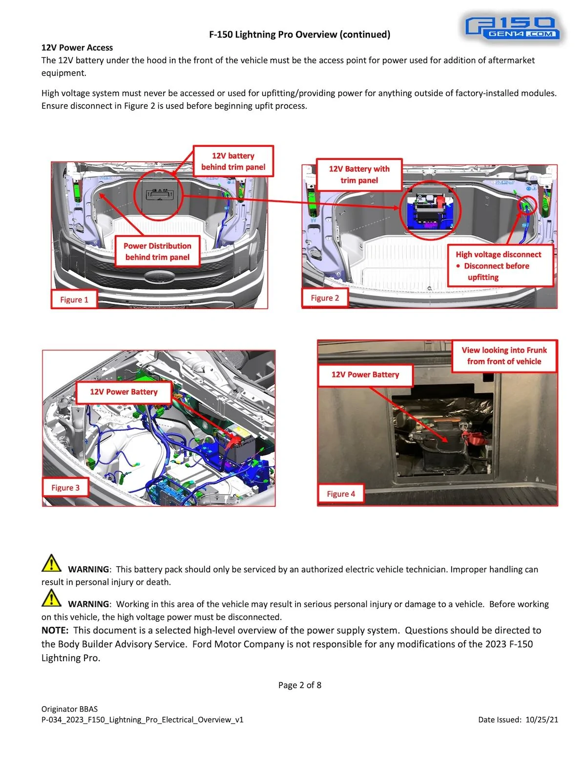

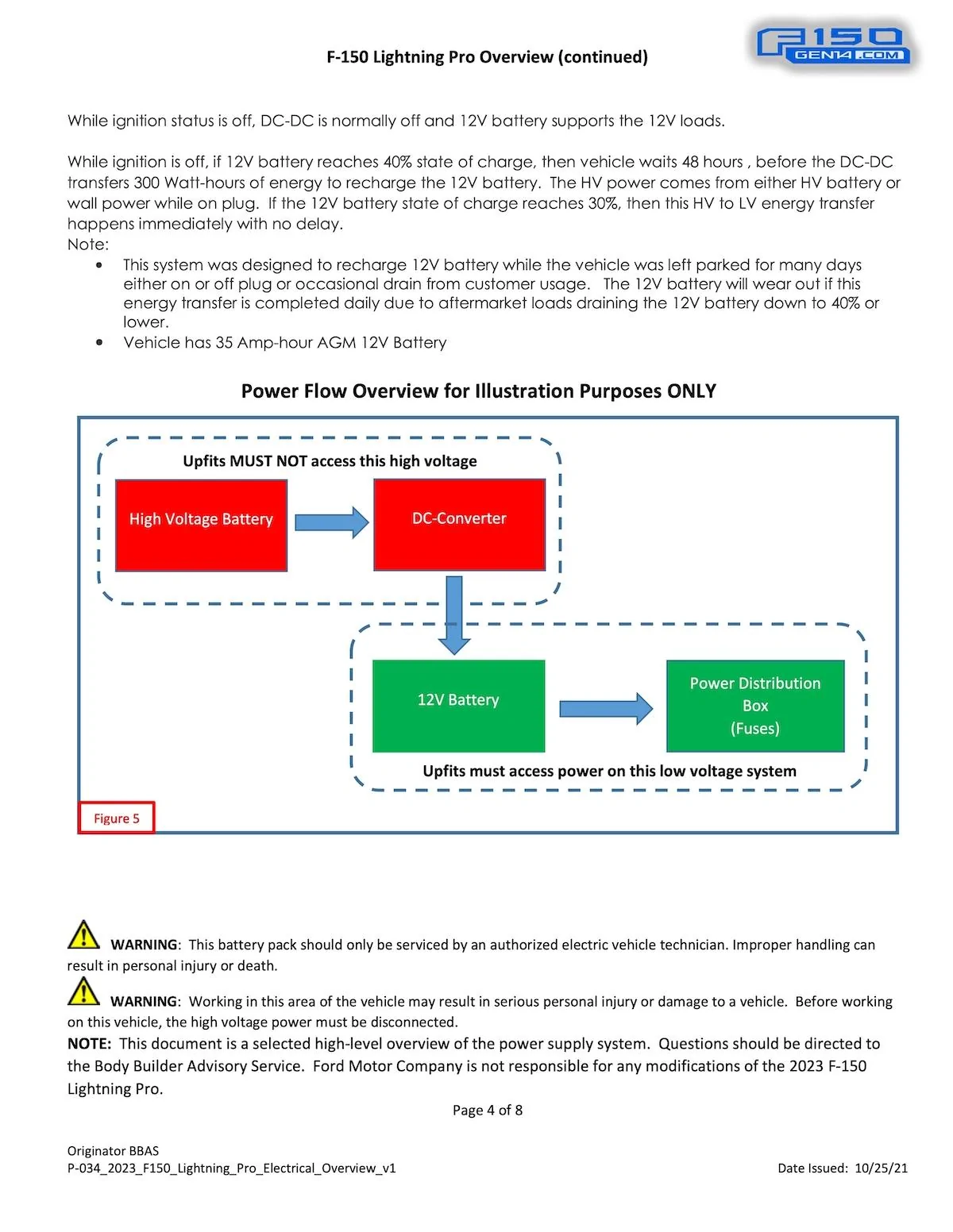

You could always use a manual / unpowered plow, though I know not many use those.With this indicating that 55 amps is available for 12V accessories, it appears that putting a snow plow on the truck will not be possible. Typically a hydraulic pump for lifting the blade can pull 150-200 amps directly from the 12V battery that would significantly exceed the 55 amps available. Will be interesting if any solutions can be developed once they are out in the real world.
Could you install an auxiliary battery and AC-to-DC converter in the frunk?With this indicating that 55 amps is available for 12V accessories, it appears that putting a snow plow on the truck will not be possible. Typically a hydraulic pump for lifting the blade can pull 150-200 amps directly from the 12V battery that would significantly exceed the 55 amps available. Will be interesting if any solutions can be developed once they are out in the real world.
So far that have states that it is.Using the supplied 12V source does seem to be dismal for almost any upfit.
Since the truck has 120VAC in frunk it might be possible to use it or maintain a charge in an additional separate deep cycle battery for almost any use.
Wonder if the AC is available when in drive?
Easy enough, just put in an auxiliary battery bank and regulate the charge it can draw from the truck. Much like my boat. It has a house bank that is deep cycle for electronics and lights but a separate crank battery for the motor. Just put a high amp battery in the frunk dedicated to service the plow.With this indicating that 55 amps is available for 12V accessories, it appears that putting a snow plow on the truck will not be possible. Typically a hydraulic pump for lifting the blade can pull 150-200 amps directly from the 12V battery that would significantly exceed the 55 amps available. Will be interesting if any solutions can be developed once they are out in the real world.
