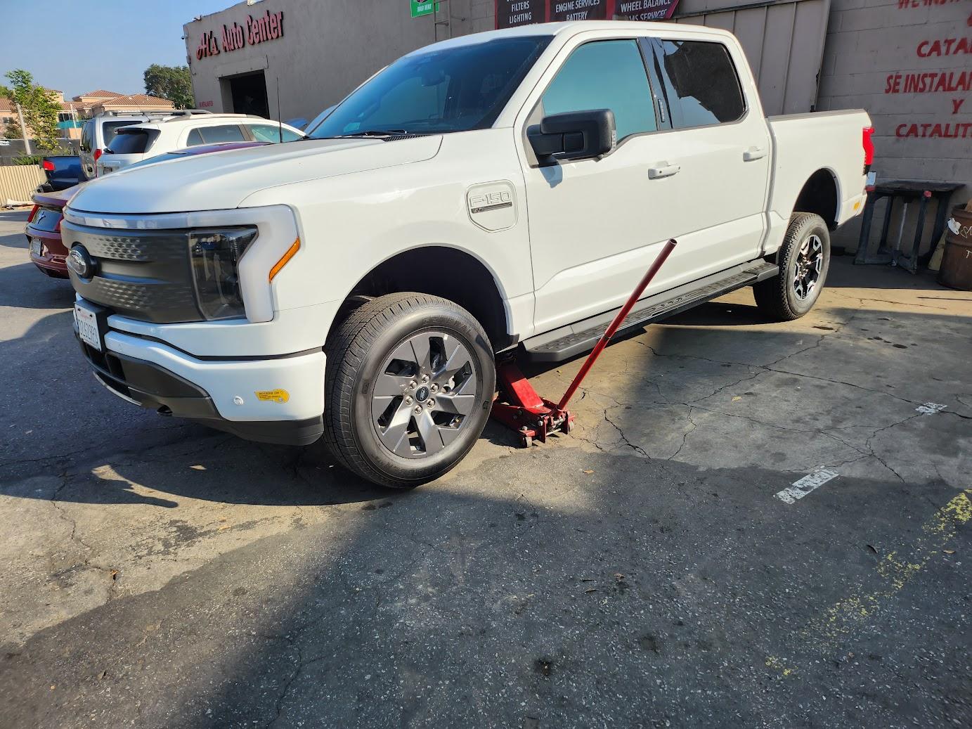

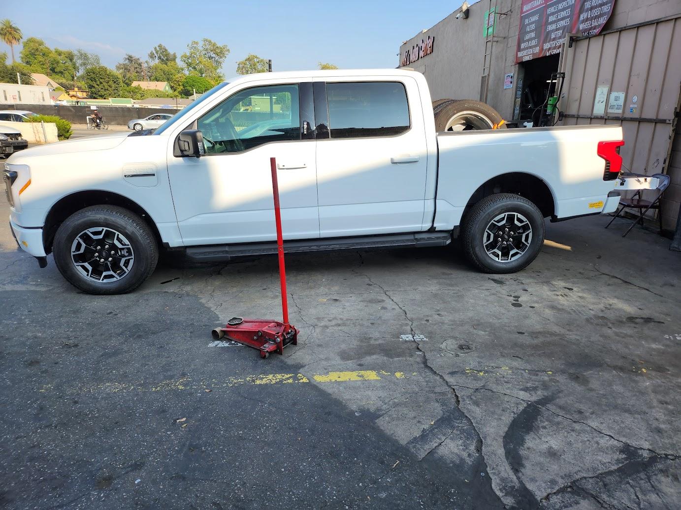

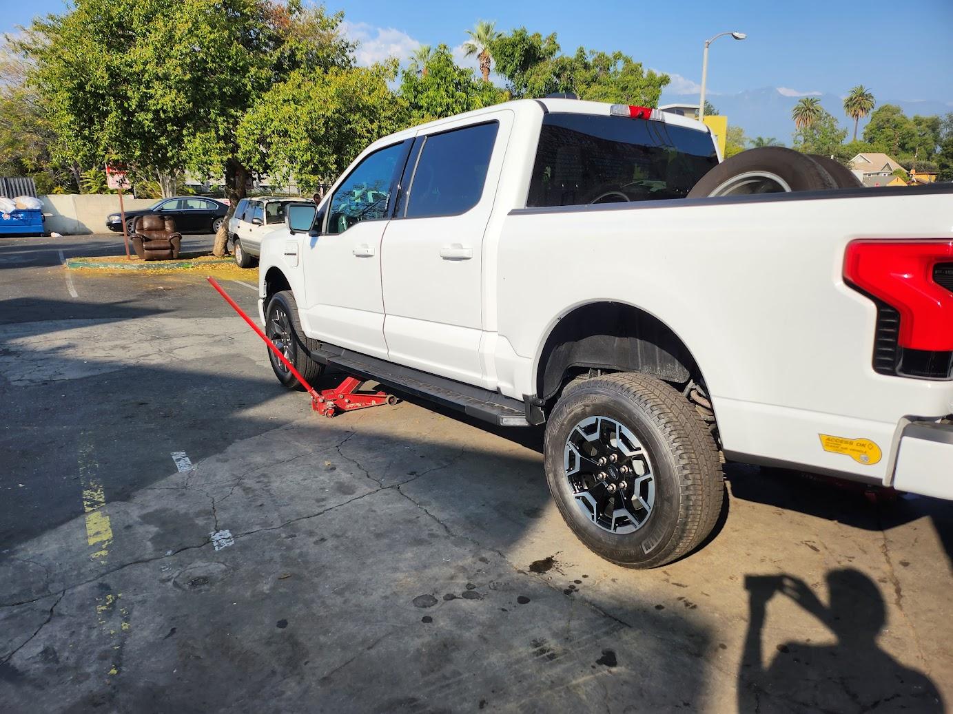

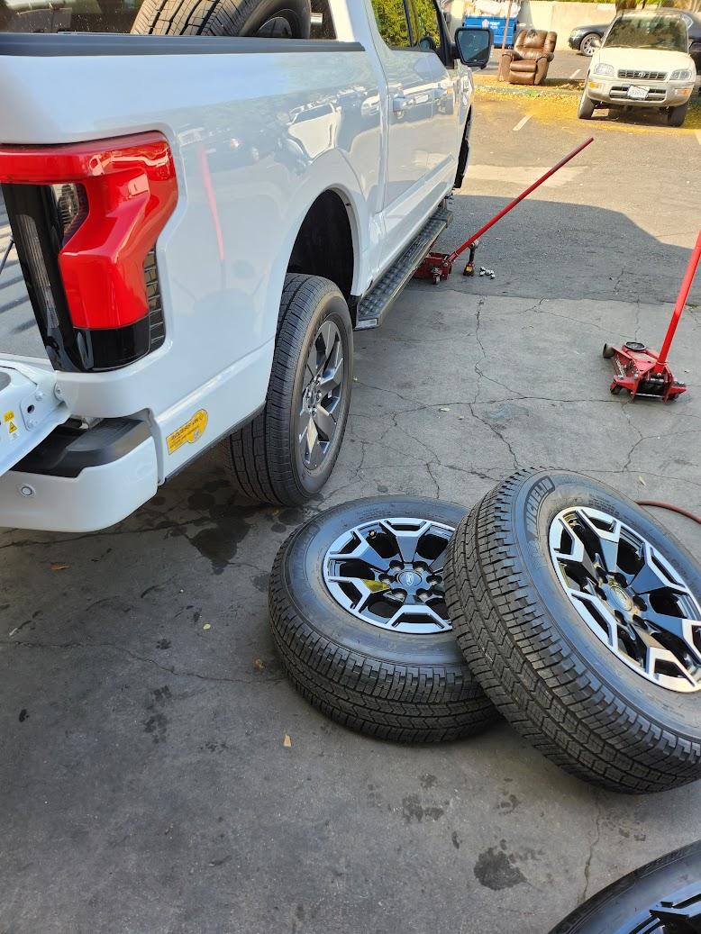

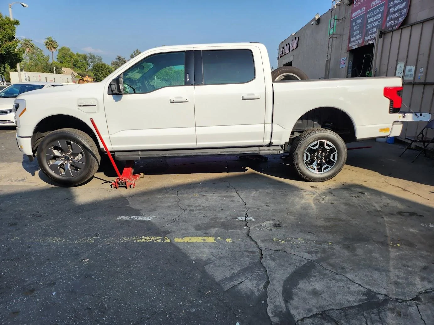

The Pro's 18's are the way to go IMO, lighter, more sidewall, cheaper replacement tire. So I swapped my XLT's 20's with the stock 18's. Would have ordered from the factory like this if it was an option. I swapped the TPMS out of my 20's into these so I didn't have to reprogram them. However the truck is still expecting 42 PSI where the Pro's 18s are normally 36 PSI from what I understand.
I'm running them at 40 PSI now just so the TPMS isn't alarming. Not sure if there's a way to reprogram the TPMS down to 36 psi. The new tires say upto 51 PSI so I'm thinking its ok running 40. Put 100 miles on them already and haven't noticed any discernible difference in road noise or ride quality but it does seem like my mi/kWh has ticked up slightly. Maybe 0.1 or 0.2 but seems like something. Lifting them the 20's felt noticable heavier than the 18s. Should have put the 18's on a scale while I had them off. The 20's inflated weight 72.7lb ea
The overall diameter is smaller. Went from ~33" to ~32" so my speed is indicating faster than I'm actually going. Based on Waze GPS, looks like I'm indicating 2mph faster than I'm actually going. I had 275/60/20s and now I have 275/65/18s. Maybe I should go with a 275/70/18 if there's some EV tire available when its time to get new tires comes.
Aww, yes. Looks like a PRO / Base XLT now :)
