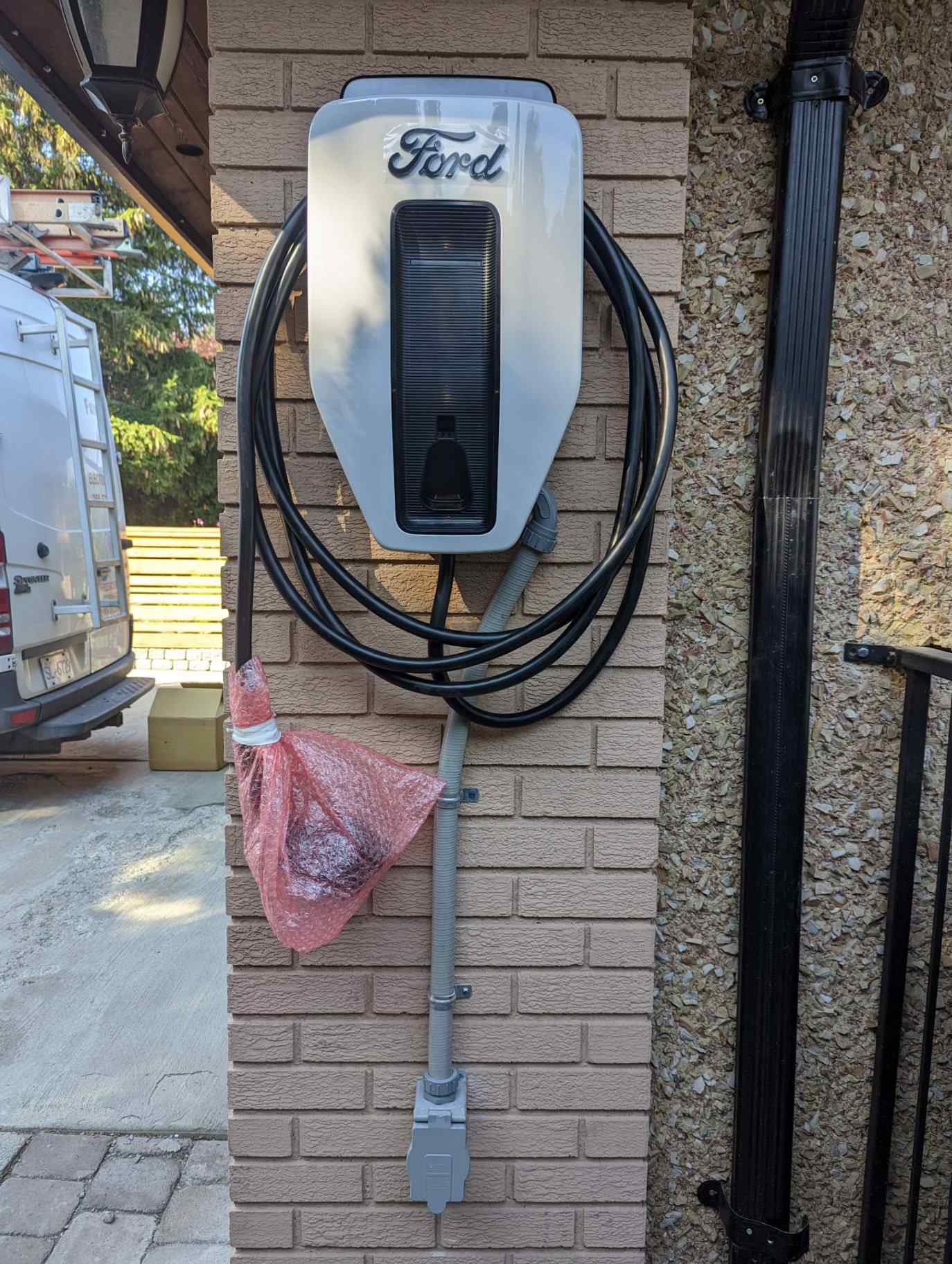

Has anyone installed their FCSP outdoors? I want to be able to allow others that may not park in my garage to use the charger (visitors, neighbors, etc) and was curious if it was durable enough. I don't want to mount it on my house but not sure if there are other options. I appreciate the hives thoughts on this.
Cheers
Rob
Yea, works great
Ford F-150 Lightning FCSP outdoor mounting options A2096AB8-634A-4D0F-B241-7044D1BA131C

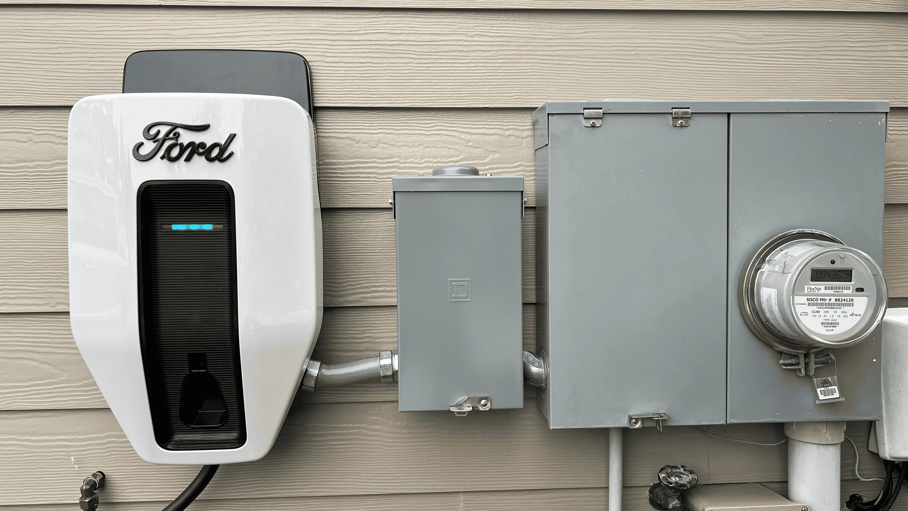

Cheers
Rob
So far, so good.
Ford F-150 Lightning FCSP outdoor mounting options tempImage3MqkP3

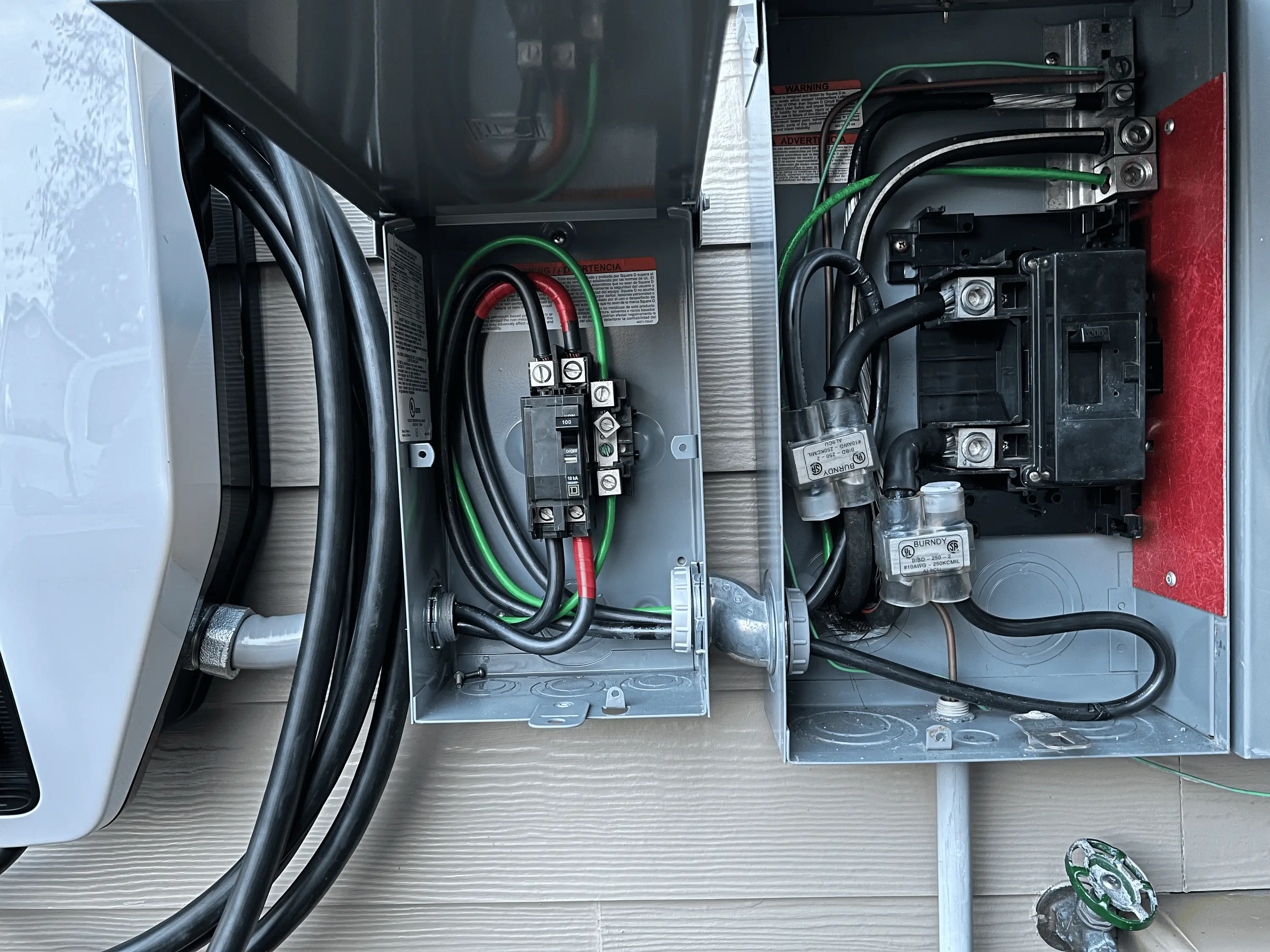

For this example…. Are you setting up the charge station before going to the panel? I have a 100 amp panel with limited available capacity, and considering if I can branch off between the meter and my basement panel. Is that possible?
White Lightning
May 22, 2021
67
75
Georgia
2022 IBSM F-150 Lightning Lariat ER
Pharmacist | Pharmacy Owner
Yes, that's exactly how mine is wired. FCSP is connected to newly installed 100A breaker which is connected to my existing 200A outside disconnect. Main panel is bypassed.

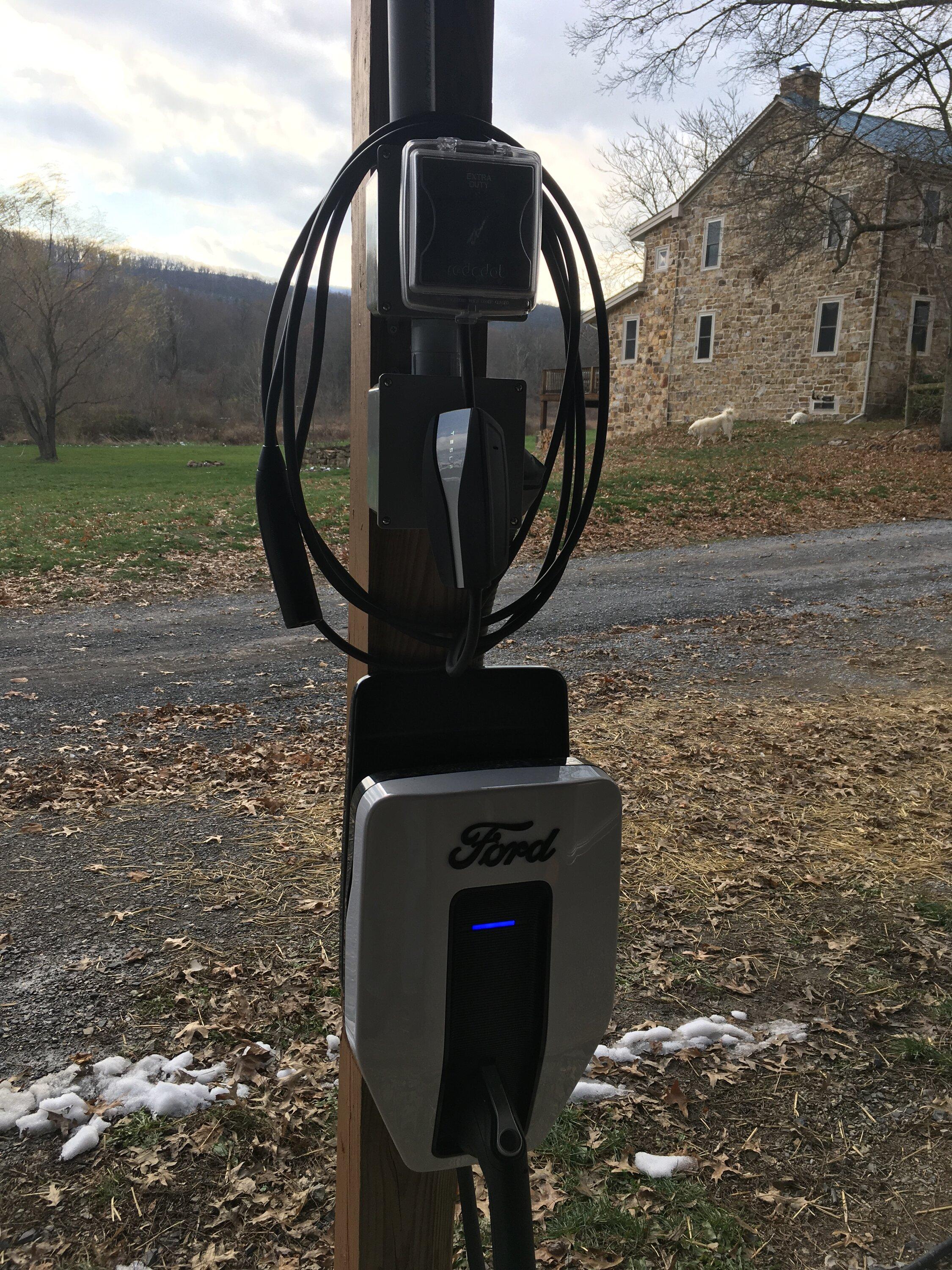

Mine is mounted on a pole that is exposed to the elements but slightly under an eve. It works fine. I did insure a weathertight seal to go into the back with flexible conduit. I use a NEMA 14-50 outlet to plug in the Tesla mobile charger as I have not yet modified a Tesla J1772 adapter to fit the FCSP and the mobile unit has been more than sufficient for the Tesla.
