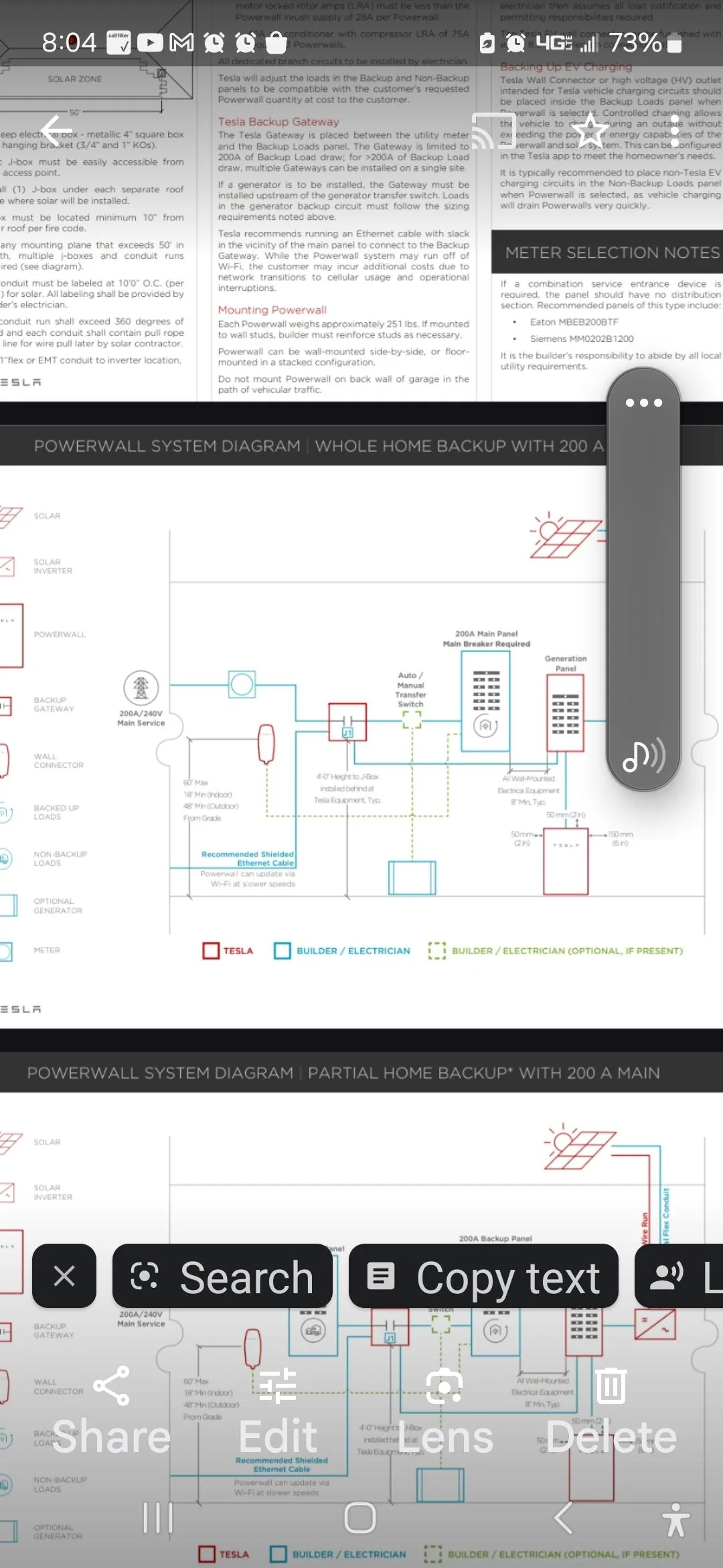

I understand how to wire my ford charger in my home panel (AC side of charger 240v 80amps)
The DC side of charger (2 #8awg) from charger get wired where?
I think they get wired into the inverter.
This should produce the power from the truck to the home inverter in DC than the inverter should change to AC which in turn would be
bi-directional and power the house.
I'm working on my service change / gateway / subpanel / transfer switch and ford 80amp charger the next to weekends.
I provide pictures for this install.
( I'm prepping all this work for my powerwall install later in the year,so Tesla only has to install powerwall and commission the home)
Thanks
I was just wondering if anyone had any pics.
Below diagram
Telsa website prep work to be done by home owner/ contractor
It can be done!
