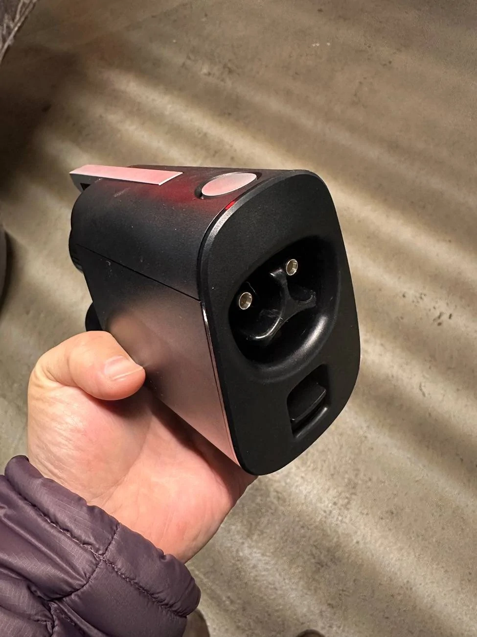

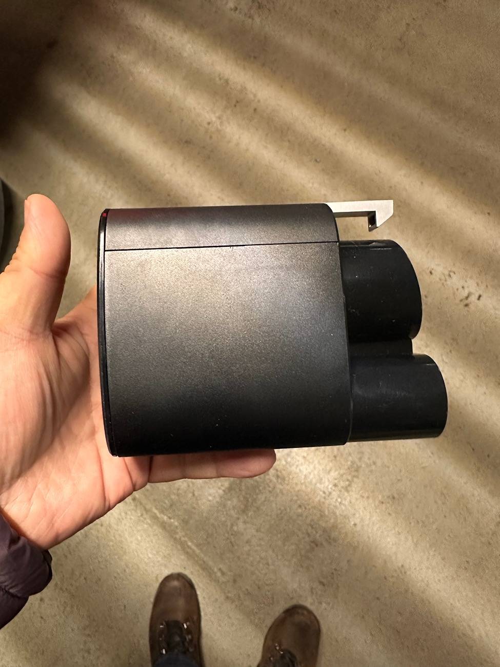

Thanks for the reply. I’m not sure how I can tell which adapter I have. There’s no markings on mine. Here’s a picture.
Thanks

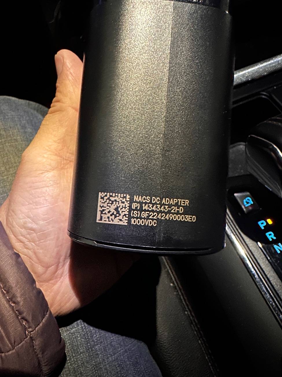

Spoke too soon. Here’s the product info. My phone doesn’t pick up the QR code.

Heliian
Mar 9, 2023
1,816
2,085
Same one I have. If it's the Tesla side then try moving the lock switch while inserting the plug. There were reports of tem being tight.
