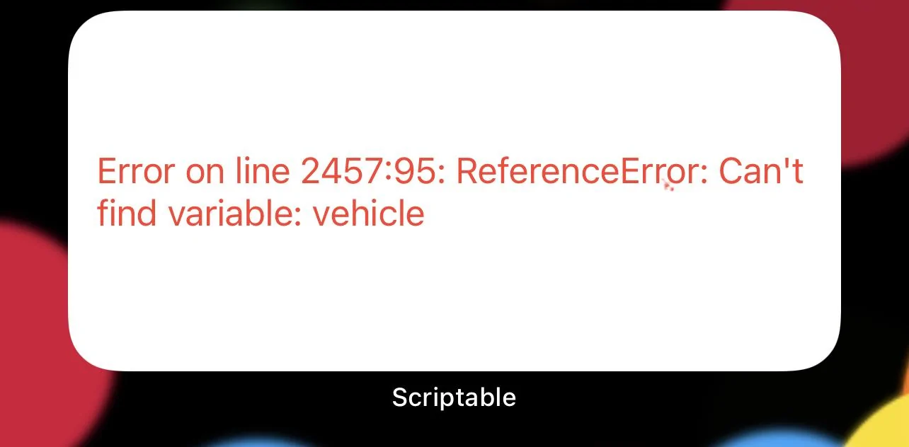

Any idea how to resolve this issue when adding a 2nd vehicle? I changed the script_id to another number. I'm able to get vehicle data in debug menu but widget isn't working.
You found another bug... Bear with me and I will get a fix out today/tomorrow
