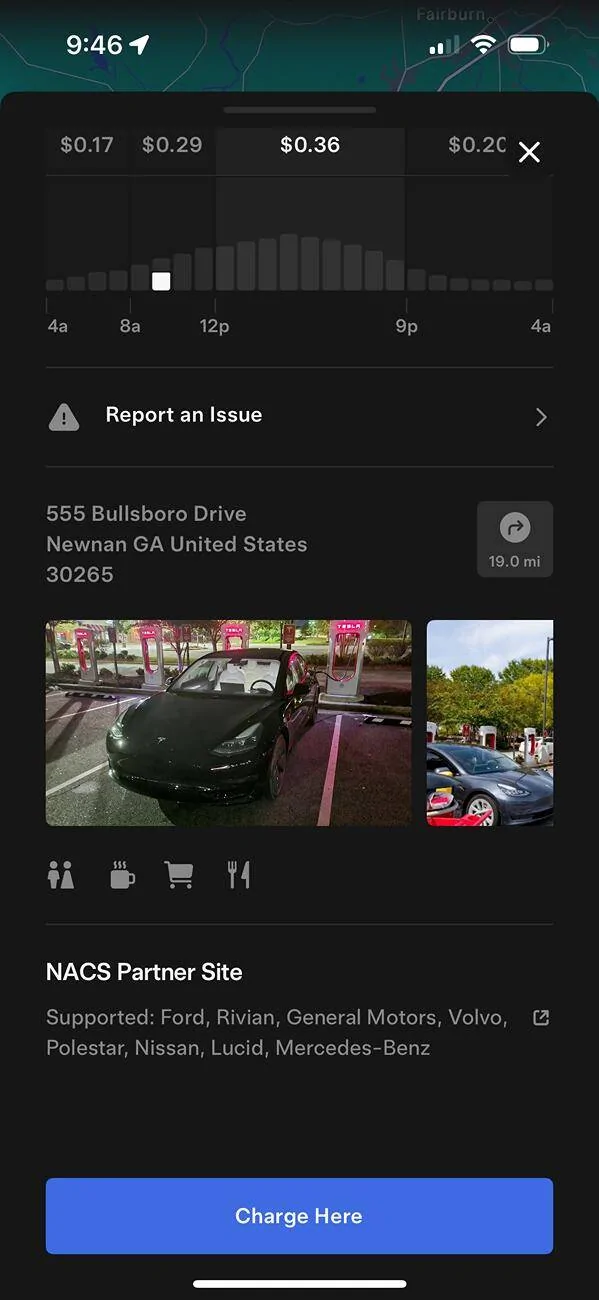

if it’s a supercharger, then pull up the Tesla app, click on the charger and scroll to the bottom of the charging description page; it will say if it’s a NACS parter.
Note that super chargers require a different adapter than destination chargers.
