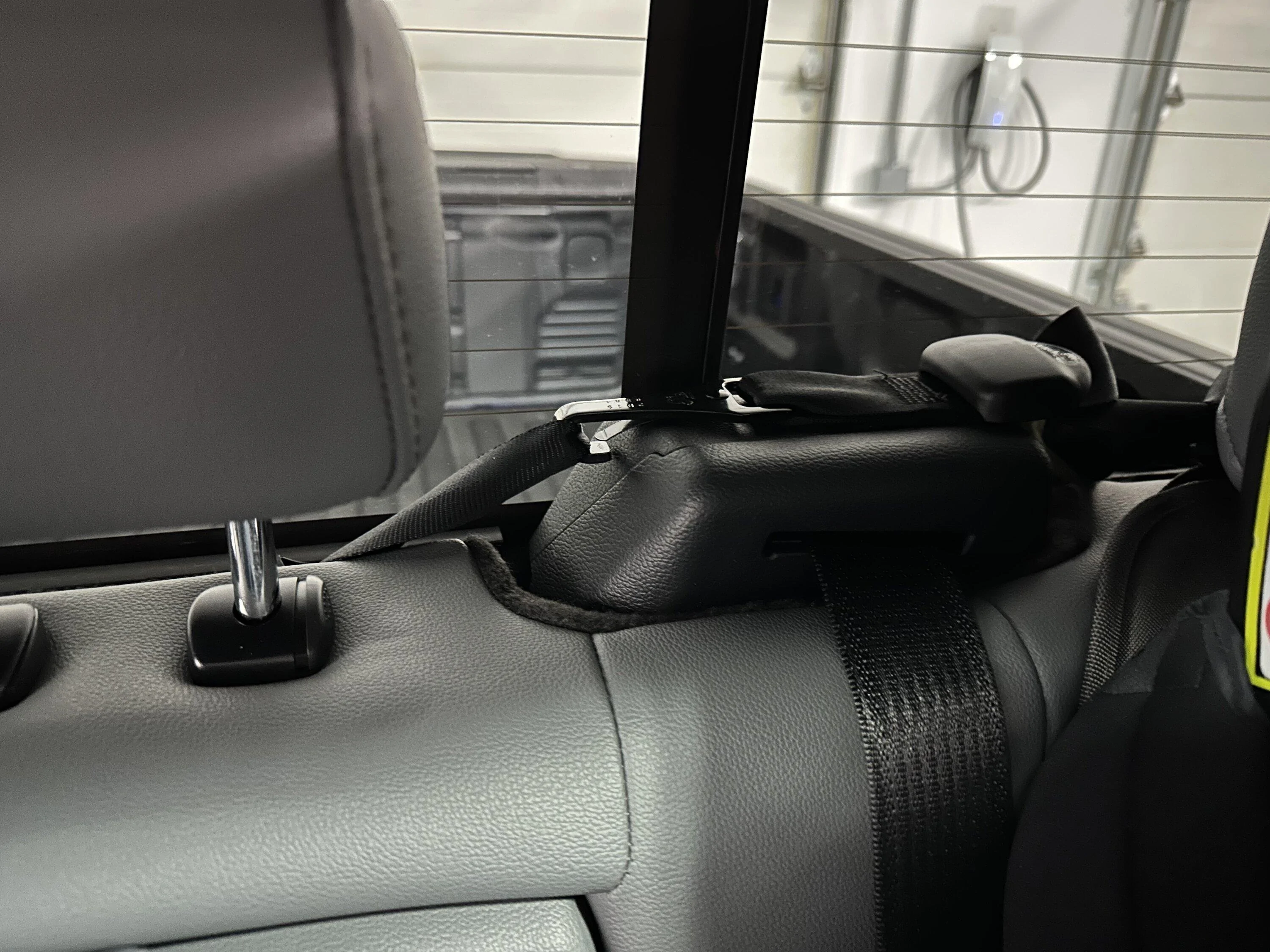

Has anyone successfully installed a front-facing car seat behind the driver?
Page 43 and 44 describe the install process, but it doesn’t clearly show where the strap and tether from middle seat should sit since there’s a seat belt mechanism in the way. If I put the strap behind the seat belt mechanism, It touches the sliding glass. If I place it on top, it works, but I’m wondering if this is wrong. I see it says behind, but I don’t want to damage the glass.

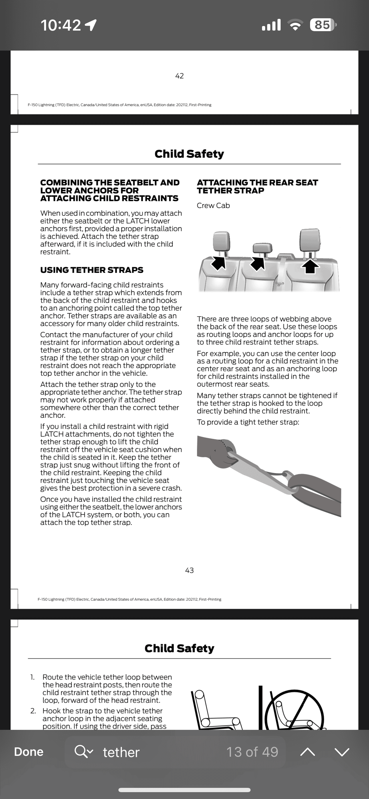

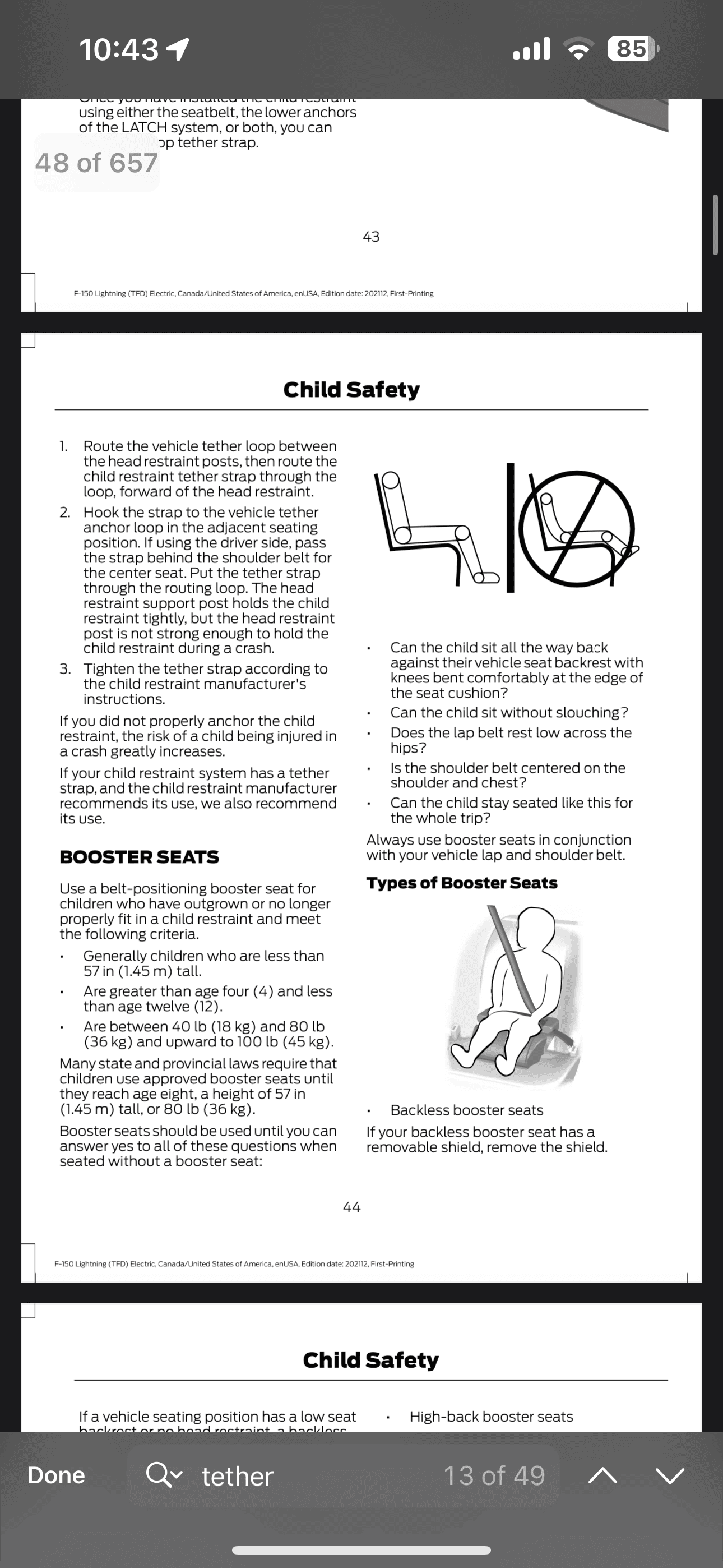

here is the information from the manua
1. Route the vehicle tether loop between the head restraint posts, then route the child restraint tether strap through the loop, forward of the head restraint.
2. Hook the strap to the vehicle tether anchor loop in the adjacent seating position. If using the driver side, pass the strap behind the shoulder belt for the center seat. Put the tether strap through the routing loop. The head restraint support post holds the child restraint tightly, but the head restraint post is not strong enough to hold the child restraint during a crash.
3. Tighten the tether strap according to the child restraint manufacturer's instructions.
