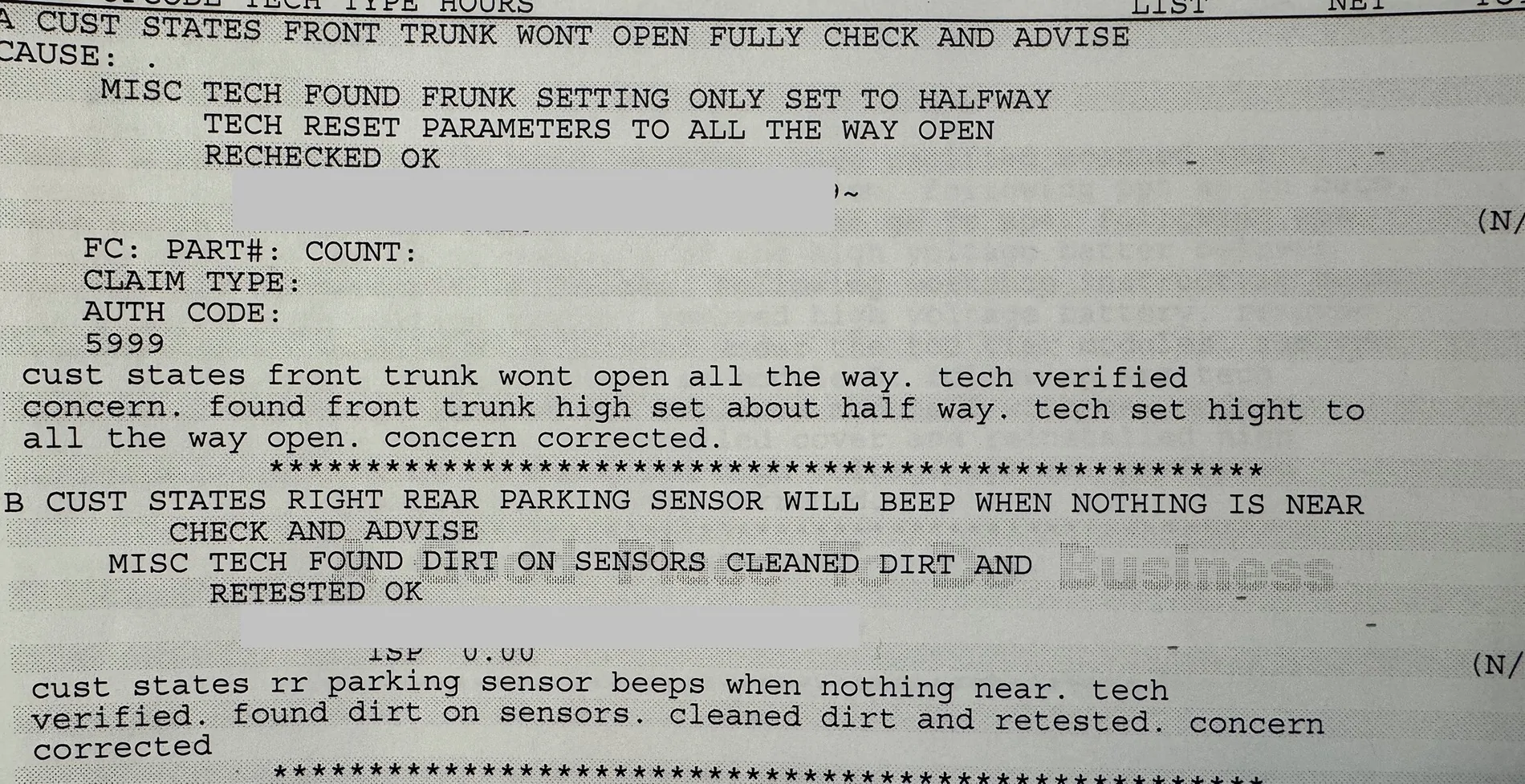

My Lightning went in for a HVB issue and I hoped they would fix my frunk opening issue and a parking sensor issue.
The notes from the tech are quite laughable. They “changed the height” of the frunk (as if I didn’t try that a dozen times) and then cleaned dirt of the parking sensor.
Safe to say, the parking sensor is still beeping incessantly, but the frunk is fixed for now. I was told it needed an update, but that tech note was just too funny.
It’s not funny, but lol definitely looks like the notes of a parts replacer on a Friday, end of the day, has all of next week off, wife is asking when he’ll be home, & has put in a 60 hour work week 🤣
Yup, definitely giving those vibes lol
