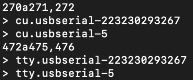

Step 6: Now we are going to run a command that will show the difference between the two files. In Terminal we will run the command diff ~/disconnect.txt ~/reconnect.txt. You should get a result similar to this. Please understand this will be different for everyone possibly, my OBD adapter shows the same results on both Macbooks for the driver its loading on connection of the device.
Ford F-150 Lightning Guide: FORscan on Apple Silicon Macbook/Air 1772030870054-3
In this case, the results are telling me the following: *These are unique to your hardware and device*. We will use this information later to configure FORscan so it knows which drivers to use for communications to the OBD adapter.
COM1 is cu.usbserial-223230293267
COM2 is cu.usbserial-5
COM3 is tty.usbserial-223230293267
COM4 is tty.usbserial-5

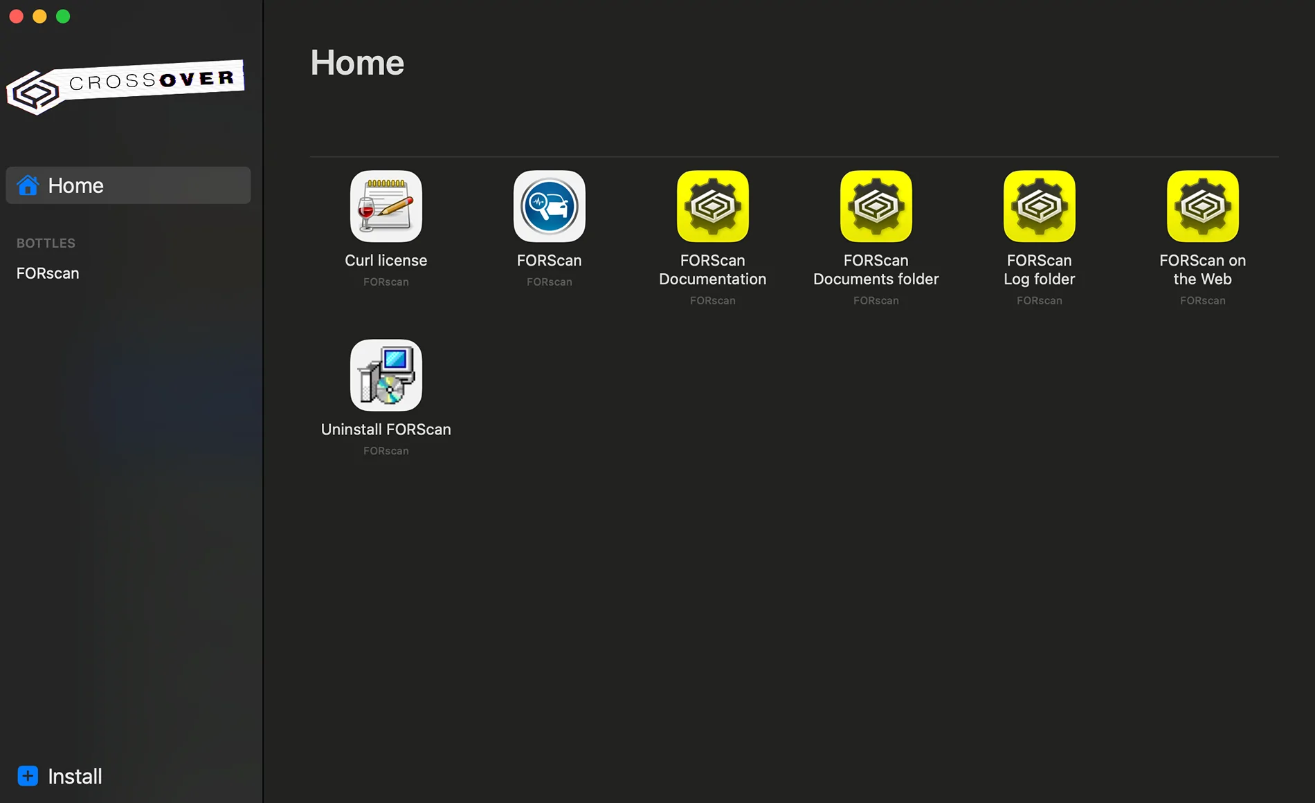

After installation, in CrossOver:
Look for the newly created bottle (e.g., "FORScan") in the main CrossOver window.
Under that bottle, find and double-click FORScan (or FORScan.exe) to launch it.
Test if it opens properly: The main FORScan window should appear (it may take a moment the first time). If it loads successfully (even if just to the connection screen), great — you're good to proceed!
If it hangs on loading (spinning circle forever or no progress), force quit via Activity Monitor or CrossOver's controls, then uninstall that bottle/version in CrossOver and try downloading/installing an older version (e.g., search for "FORScan v2.3.67 download" on trusted forums like forscan.org/forum if not directly available).

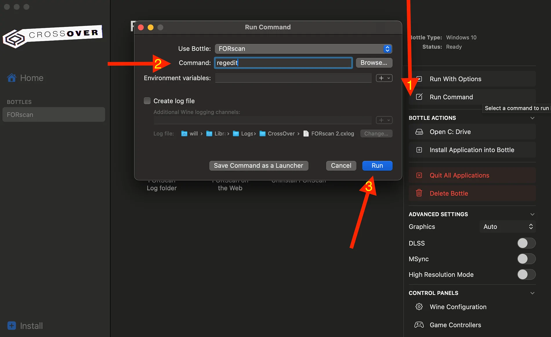

Step 10: This is the step we will enter the driver info from earlier into the registry. You will drill down inside regedit as follows HKEY_LOCAL_MACHINE - Software - Wine - Ports. This will not have the lines 2-5 in my picture, we will add these manually by scrolling your mouse to the white area under the "Default" string and right click, add new, new string. We will do this to add all 4, you can either enter all the information now or just name them and come back to each modifying them with the info. You will transfer the values from before into each line following the prefix of "/dev/" in the value. The results should look similar to this with your own values. Once you have entered the settings, exit out of regedit and it should show animation on the popup that its saving. This should only take a few seconds before you can exit the run command prompt.

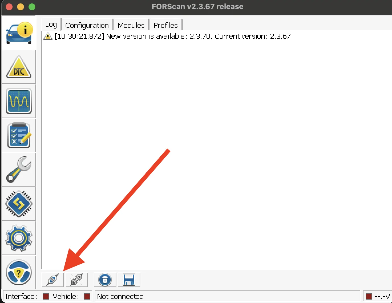

Step 11: Now you can test the connection by pressing the connect button near the left bottom of the screen. I did this prior to plugging it into the vehicle, so it will pass the connection to the OBD adapter on my desk, but fail the connection to the vehicle, which is expected. Don't be upset if it doesnt work on the first time, in my case it fails for some odd reason the first time after opening the application. I found i have to disconnect the OBD adapter and plug it back in for it to work on both of my macbooks as a weird bug, but it works everytime afterwards. I also found that on both Macbooks the left side USB-C ports works for me, but i couldn't get the right side USB-C port to work at all, displaying a red LED on the OBD adapter.
