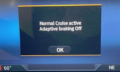

I did some APIM / IPMA programming (BC 1.2 related) two days ago with version 2.3.63. The only issue was when starting the IPMA As-Built configuration, I got a brief message with some beeps on my instrument cluster:
Ford F-150 Lightning Ipma not loading on forscan 1733188401950-vl
But I was able to change and write data. I use the OBDLink-EX adapter.

I got this to work on my ‘23 Lariat. I am on 10.1.1 and I just picked it up from the dealer who installed some updates and performed some recalls. The same message “normal cruise active…” popped up a few times for me. The sliders show up and work. It doesn’t look the same as the MME, but it seemed to change lanes better than BC 1.3 on the MME. I didn’t see any improvement on slowing through turns, so I think a few things are still missing or not up to date.
