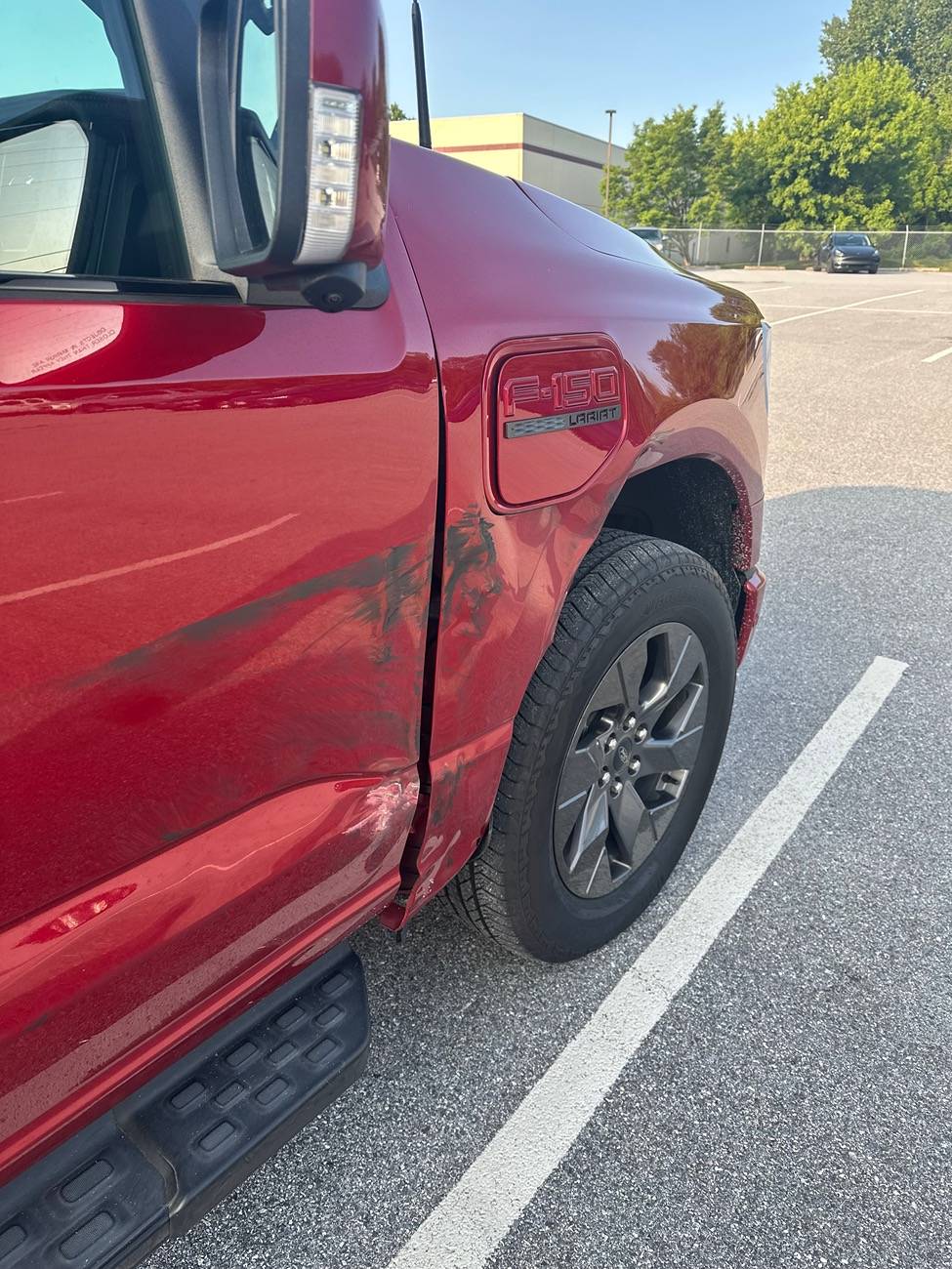

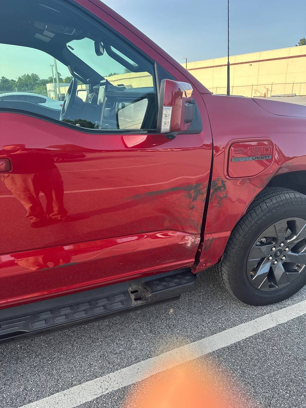

I got sideswiped coming out of a toll plaza today, I really thought it was just the mirror so I pulled over to push it back, wasn’t going to chase the truck since it was kind of a mutual fault but when I stopped I saw the damage-I don’t even think the guy knew we made contact since I didn’t
Anyways you think this is fixable or they’re going to have to replace door & front panel? I’m just nervous bc idk how hard or easy it is to get body parts. Would be cool to get a newer front panel sans the fake charging port that fake port is kind of dumb. Appt at body shop Fri 8am-just wondering if they’ll fix it or replace it-I’ve seen body guys do miracles but not sure if this is going to be one of them

What year Lighting? Only vehicle I see on ur profile is an 07 XL.

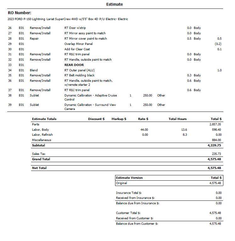

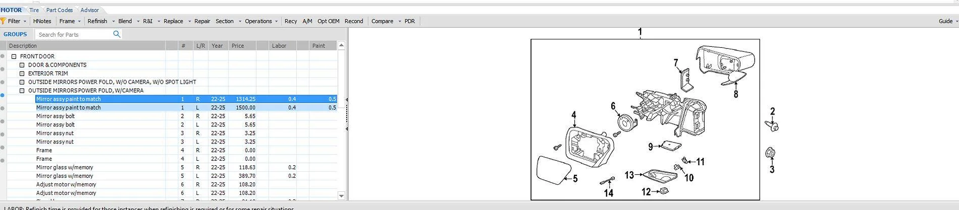

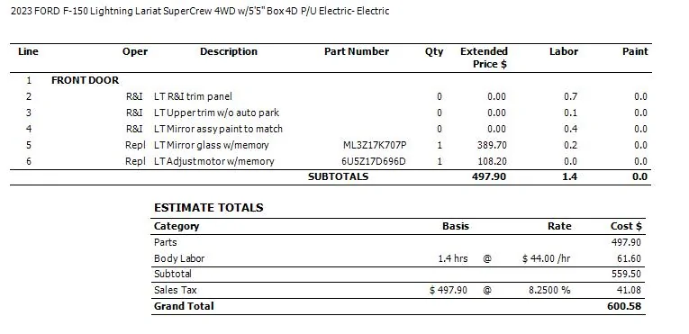

Well this is a rough estimate based upon the pics provided. Good pics BTW.
Looks like there’s some tire transfer onto ur passenger side front wheel. If there is, hopefully that can be buffered out. If not then they’d need to repair it, & should do an alignment.
If they can’t buff out the mirror, or if the body tech can’t properly disassemble it, those aren’t cheap from Ford :cry:
Looks like u snapped the running board back on, so if that’s not damaged, should lessen the price by a lot.
I wasn’t sure if that is the Ford 3-stage red (looks like it is but didn’t wanna assume) so I didn’t include that.
All the parts I have on it are OEM (from Ford) but if u go thru ur insurance company they’ll probably use aftermarket (A/M) & used if available and cost effective.
Sorry this happened to u. Beautiful looking truck 💪
This is an impressively detailed estimate! On the bright side, if this were another EV truck like a Rivian or a Cybertruck then I'm sure it'd be quite a bit more pricey to fix.
