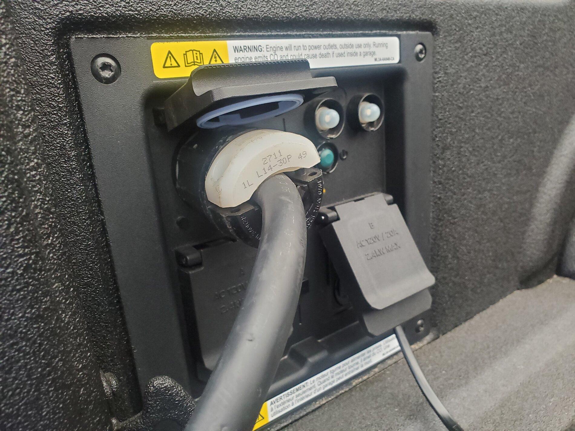

Also note that 30A is the max current capability of the 240V plug in the bed.
Any idea what NEMA plug they are using in the bed? 14-30 perhaps? Locking?

NEMA L14-30R - 30A locking. Also (2) 20A 120V outlets.
