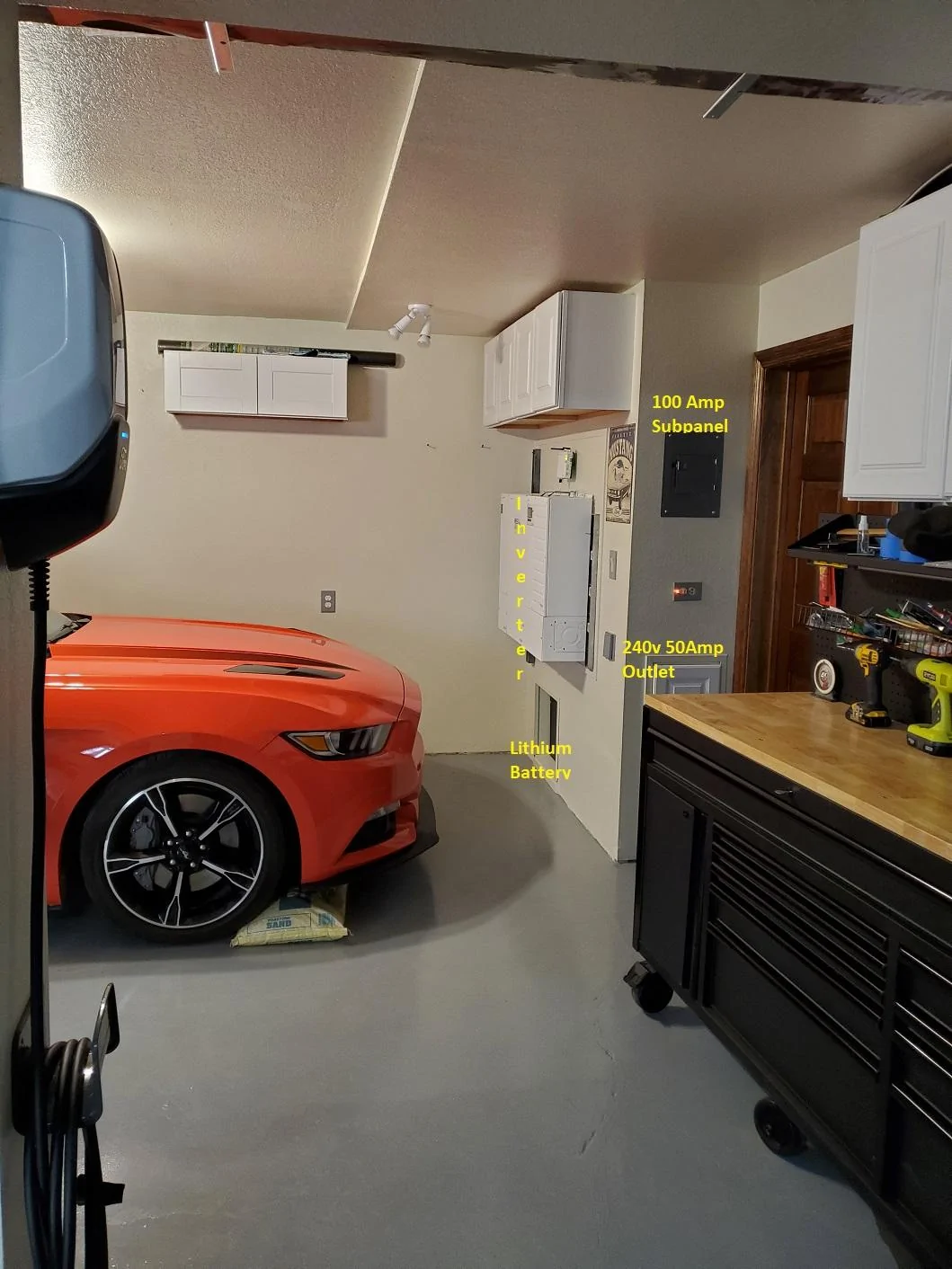

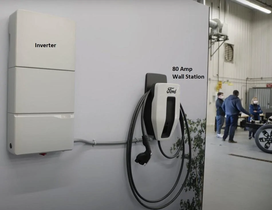

Sorry, they are partially correct. In order for any home power input source (solar, generator, F150 battery) to automatically supply power into your home's electrical system when the power fails, it must have a failsafe and automatic method to isolate your home from the commercial power grid. It's called "islanding" and is designed to keep your emergency power source from back feeding to the grid and killing the electric company's linemen. It's not optional and you can't legally just manually turn your input power breaker off at the breaker box.
That's why, if you read the Lightning's literature closely you'll see that if you want to use the F150 to power your home in an emergency you not only need the 80 amp Ford power station (which is included with the LR battery) you will also need a DC to AC power inverter (at $1500-$2000 + installation) which is apparently NOT included.
I believe that is what the solar people really should be saying. For automatic home power backup using your Lightning, you don't need to install an entire solar array but you will need to install an inverter just like the ones that solar companies install with solar arrays with emergency battery backup. This inverter will act as the interface between the battery and home and converts the DC current coming from the truck (thru the CCS pins) into AC that the house needs. The inverter also provides the same safety function that a generator transfer switch would perform - the "islanding". When you look at the pictures and diagrams Ford provided, you can see the separate inverter that is wired between the houses power supply and the Ford 80Amp power station.
Here is a picture of how my backup power system is configured. The 100 amp subpanel provides the commercial power source for the inverter and has output breakers for a 50 amp outlet and the 60 amp Ford power station on the column in the foreground. (Only one of those output breakers is powered on at a time). When commercial power goes out, the inverter instantly senses it and my backup battery provides power to the critical circuits. The battery is, in turn, recharged by either my solar array or a generator (the transfer switch function for the generator is also a part of the inverter). But my solar and generator input are irrelevant to this discussion. You will still need at least the inverter part of this system to safely and legally provide F150 emergency power to your home. Of course, as a fallback, you could run extension cords from the Lightnings outlets to some of your critical home systems.
