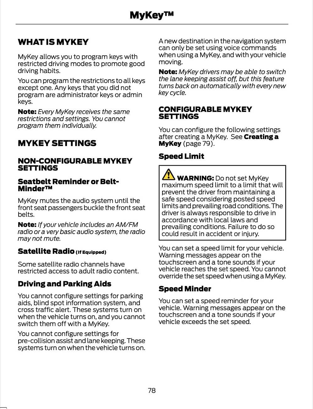

23 Lariat⚡ER
MyKey™ explained on page 78 in 2023 Owners manual.

2024 Lightning Lariat
Thanks. Just looked thru and used search function on the touch screen...nothing mentioned (also dislike using screens for that amount of info).
Time to download the PDF and see what else I'm missing.

-22 F150 Lightning Lariat
Ok it’s that easy I can program via my key that with other key top speed is 55mph???
This didn’t work. Lowest I can go with my key is 65mph and I have to limit speed to 55mph. Has anybody seen in forscan way to limit speed or adjust those my key speed options?
