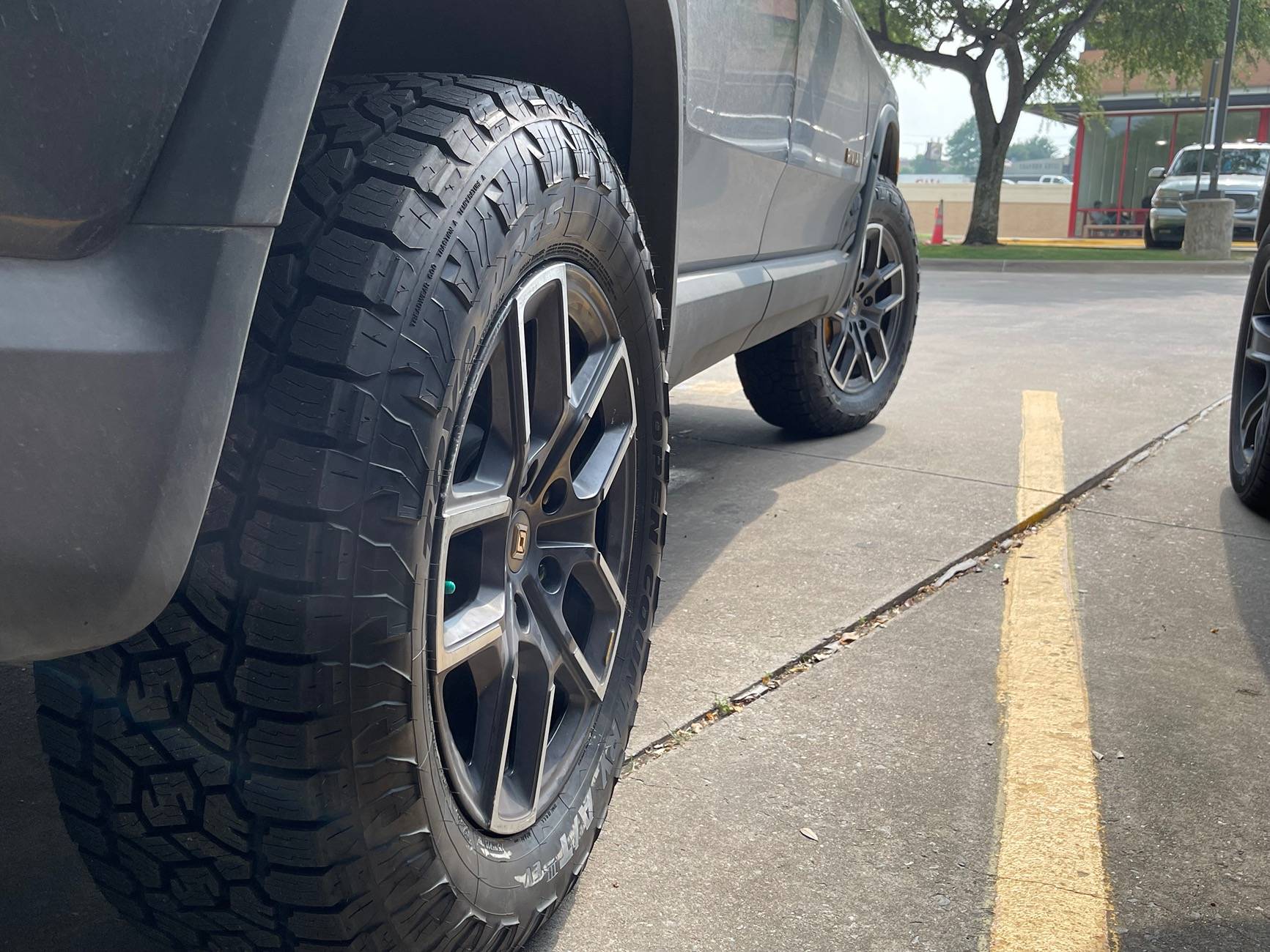

Here is the initial pictures from the install.
Just driving 4 miles I got 1.92 mi per kWh. I would expect this to go up once I’ve driven 20+ miles instead of short trips.
I’ll drive more tonight and report back with proper efficiency numbers and once i get all tires to 50 lbs hot.

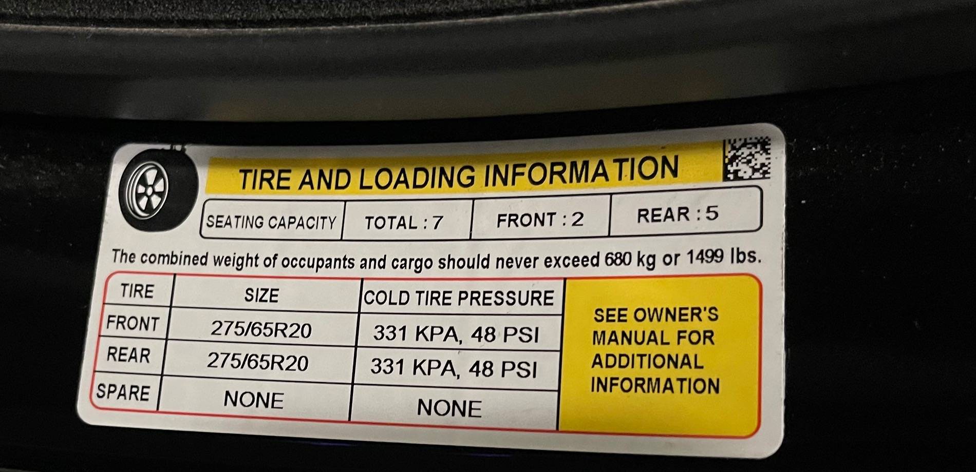

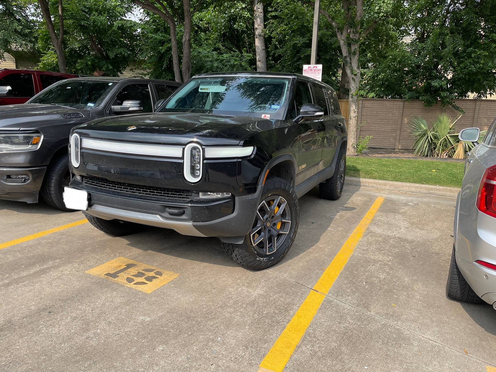

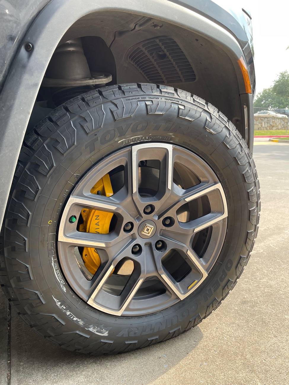

Here is a pic of the 51 PSI max pressure for the Toyo Tire Open Country A/T III EV 275 /65 R20 116H SL BSW version of the AT III EV.
I am running them at 48 lbs cold and 50 lbs hot on my Rivian R1S which weighs around 7,000 lbs.

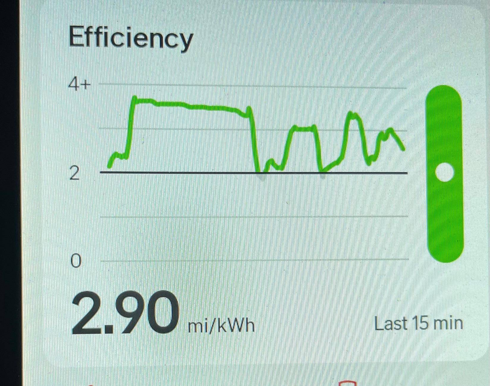

I am seeing similar or slightly better range with these tires compared to stock Rivian Pirelli Scorpion All Terrain+.
1.80 - 1.9 mi/kWh on Highway at 73 mph and 2.25 - 2.45 mi/kWh around city at 40 mph.
Initial thought to me is the original Pirelli AT+ gripped better when making a fast turn.
Toyo does a good job holding on to twisty roads and initial grip from launch like Pirelli did.
The Toyo tires are quieter and rated at 65,000 mile with warranty and Pirelli is 50,000 mile tread wear warranty.
I’m happy with the tires overall compared to OEM Rivian Pirelli.
I love the 65,000 mile warranty, weight, efficiency and load / speed rating.

Here is some in town driving stats for Toyo 34” all terrain III EV tires.

Load index 116 is for 2756 pounds, so putting the Toyos at 48 psi cold seems on the high side for a 7062 pound vehicle. I think the stock psi for the 20” on the Rivian is 44, I’d be inclined to test the Toyos there and see how they perform.
I increased the pressure on my 115 rated stock AT tires from the recommended 36 psi to 42 psi of the 116 tires. After reading a bunch of threads about the AT tires wearing prematurely on the edges it seems like the 36 psi number is low. At the higher PSI I have noticed a loss of traction if I full send in anything other than ideal conditions. It’s predictable, but the truck certainly gripped better at the lower PSI. I don’t have enough consistent miles to see if there is a difference in efficiency.

Thanks for the detailed reply. I know when I ran pressure slightly lower it helped grip better at the expense of efficiency.
I will run some tests and let you know what works best for grip.
For efficiency Rivian recommends 48 PSI even though the stock tires mention 44 PSI as max.
Here is my door jamb plus weight details.
My stock tire is 116H.

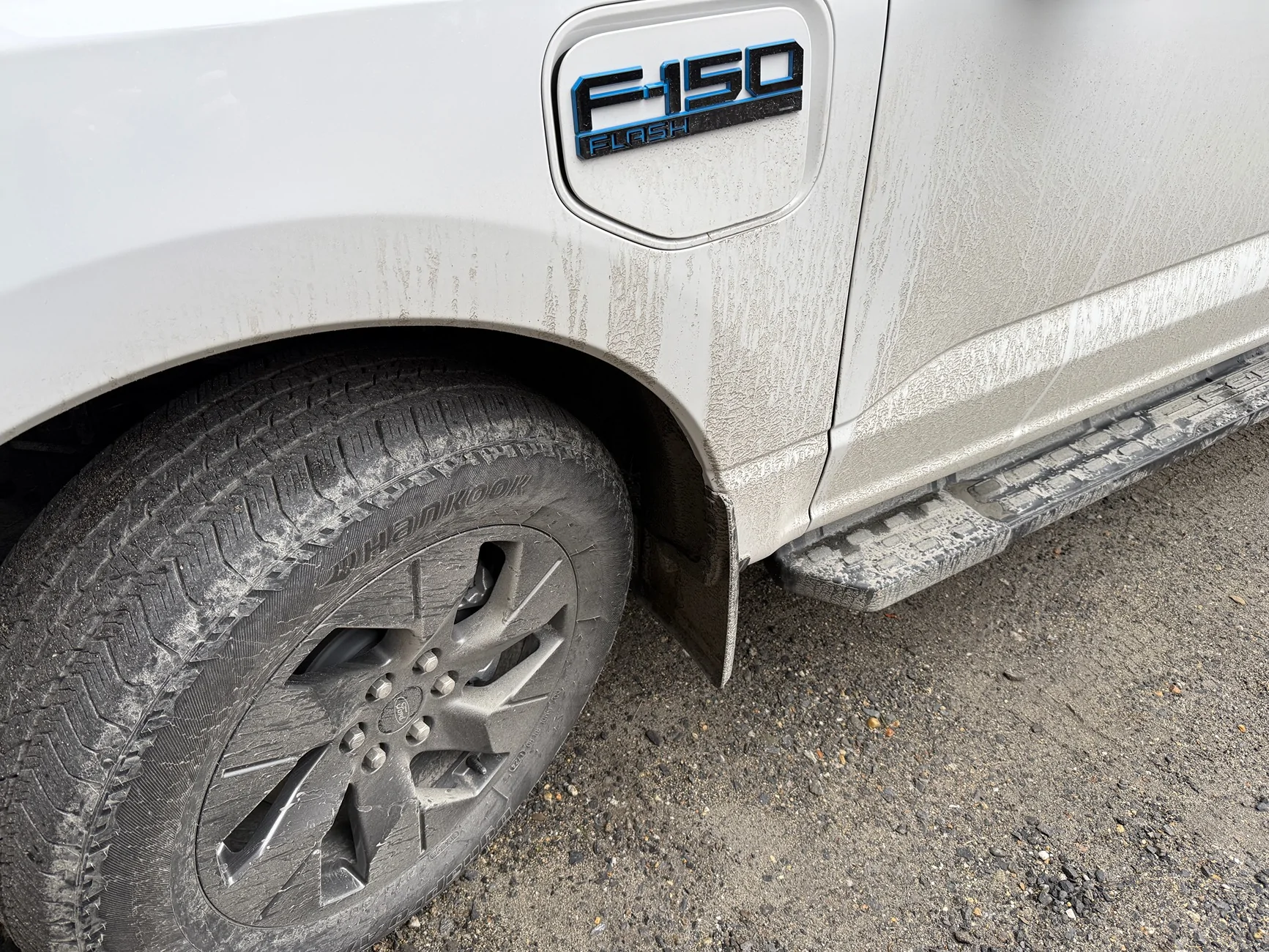

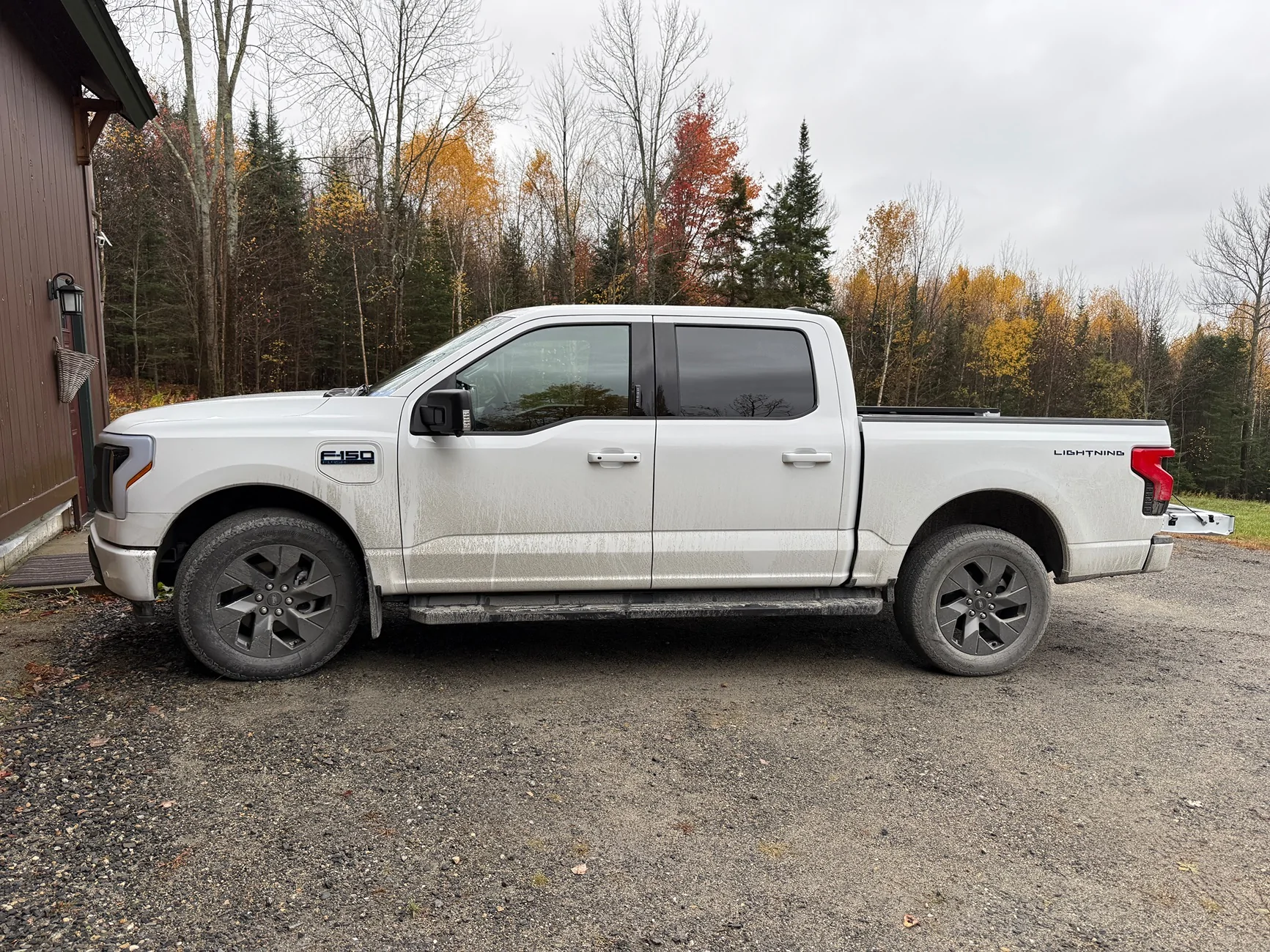

I just got back from a trip to northern VT where I used the Lightning on the rural hard pack dirt roads with factory A/T tires at 40 psi. I was surprised how well it did overall. My wife was less than pleased with the speeds I was doing, especially in the rain, but the tires were predicable enough. I have 26 months left on my lease, as much as I’d like to upgrade the tires I’m not sure it’s worth the investment. I’ll inquire with the local dealer and see if they can offer the buy 3 get 1 deal, thanks for the tip on that. The Toyo’s do look awesome.

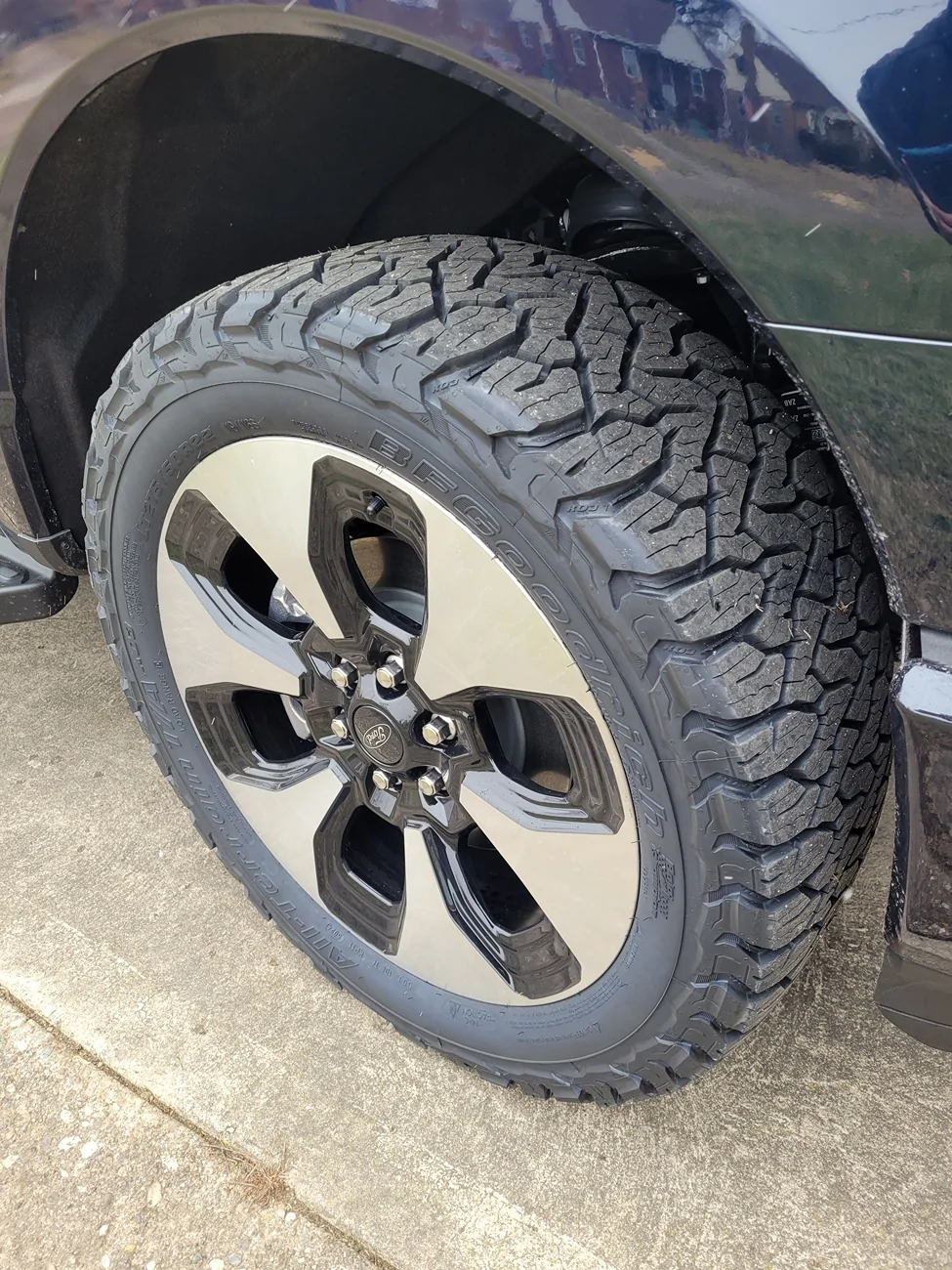

Love my 275/50/22 K03s I run them at 50 PSI got 8000 miles on them
