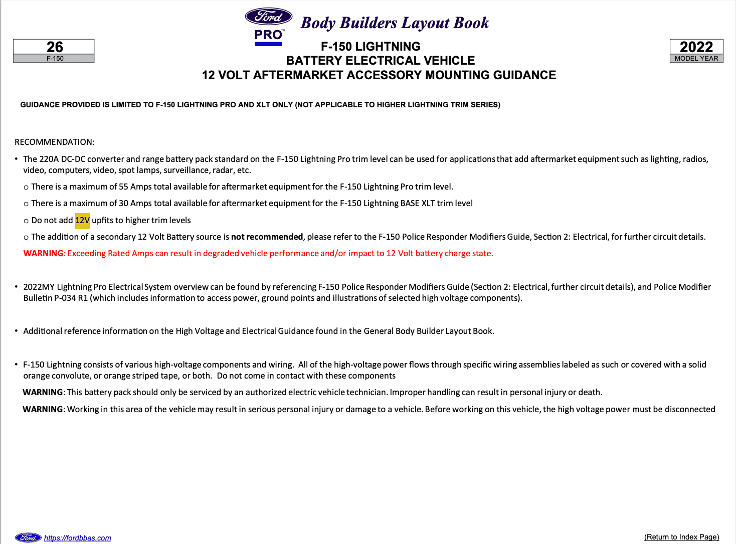

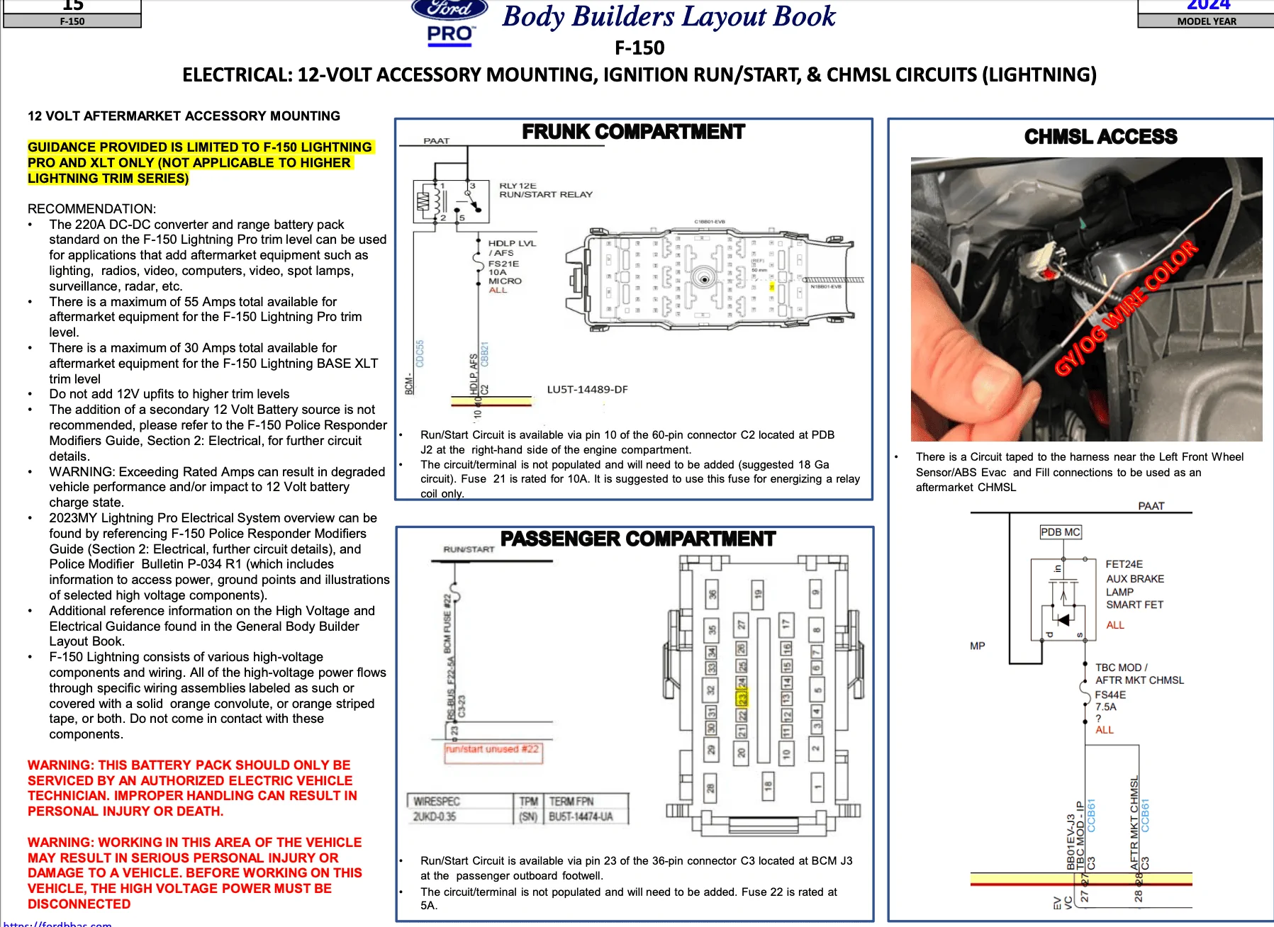

Replacing the stock battery may be a non starter. The bms is pretty complex. What I did was add a 50ah lithium and a dc-dc charger. Charger top up the lithium when the vehicle is in “run state”, bms sees the charge current as just normal draw and tops up the agm battery normally. The lithium is mounted to the frame rail under the bed.

I'm planning to take a different approach, for different reasons (winch). Because I'm fairly clueless about electrical mods, and don't want to F anything up, I'm going to install a 12V deep cycle battery in the frunk "cooler" area (don't really seeing using the cooler as such), and have it hooked up to a trickle charger that is plugged into one of the 120 outlets. That way I'll always have a good strong winch battery as well as backup to the OEM 12V if ever needed. So, I'll basically have a closed system for the winch electrical system. I think this would be excessive for the OPs application though.

Here's what I am planning on doing. I will have an aux battery plant that will consist of two deep cycle batteries in parallel. The two batteries will be mounted in the bed just forward of the wheel wells. Because of the shorter bed than my previous truck that means the battery boxes will be mounted to a frame holding them mostly above the front of the wheel well. That will put the top of the battery boxes just below the top of the bed. All the aux loads will come off that battery plant - 2 way radios, some lights, and several cameras. To charge the aux battery system will be two things. First is a 15 amp charger that will source power from the rear seat 120V outlet. The second will be a DC to DC converter that as far as the "normal" vehicle electrical system is concerned will simply be about a 15 amp load. Both of those charging sources will normally only be charging when the vehicle is ON, although there are times I manually have the ProPower stay on after vehicle shutdown - in which case the AC powered charger will stay on longer.
