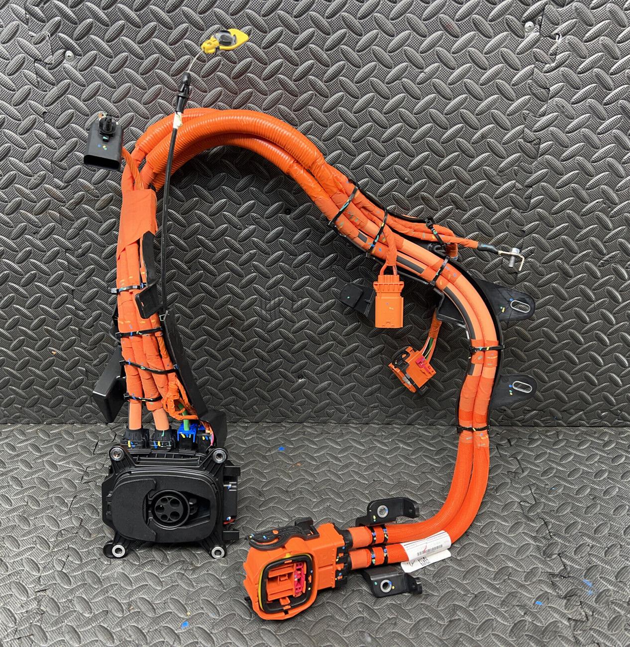

Better yet I would prefer that Ford creates a retrofit for 2022-2024 Lightnings to replace the CCS charge port with a NACS port for a reasonable fee. That shouldn’t be that difficult.
It's not just a port difference, but a whole contactor relay package that is not an inconsequential piece of equipment and is quite sizeable.

I've posted this pic before. Can you even imagine the cost to add just the hardware for a NACS on the other side?
wouldn't need all that to get CCS on the passenger side dummy door, just the ccs connector and a couple large orange wires connected to the ones on the drivers side. The truck would never know where the power was coming from as long as you didn't try to use both at the same time.
4,202
5,570
Right - you would need way more than that. Some kind of high-power switching mechanism would be needed since NACS uses the same pins for AC and DC.
correct it would be way more complicated for nacs. I was just suggesting ccs for the passenger side. solves the supercharger blocking spaces dilemma. maybe you could just permanently mount the Tesla adapter to the ccs port behind the passenger charge port door.

Porsche has charge ports on both left and right on all Taycan models (except the turbo gt). Both accept AC charging, but only one accepts DC fast charging. I don’t think it would terribly difficult to install a second port on the passenger side of the Lightning, provided it was AC only. If it were cost effective/simple, I’m sure Porsche would have added DC functionality to both ports.

In the near future, if someone wants to convert to NACS it should be possible to just replace the CCS1 port. The car and charger talk to each other before charging begins. At most, you might need a heavy duty relay to switch between the AC transformer and DC controller. How does Tesla do it?
Actually, neither CSS or NACS would have to be difficult at all. My suggestion is to put the NACS on the passenger side but it would only work for DCFC which eliminates the need for any switching equipment or other complications. When you L2 charge, you use the J1772 part of the CSS port side.
