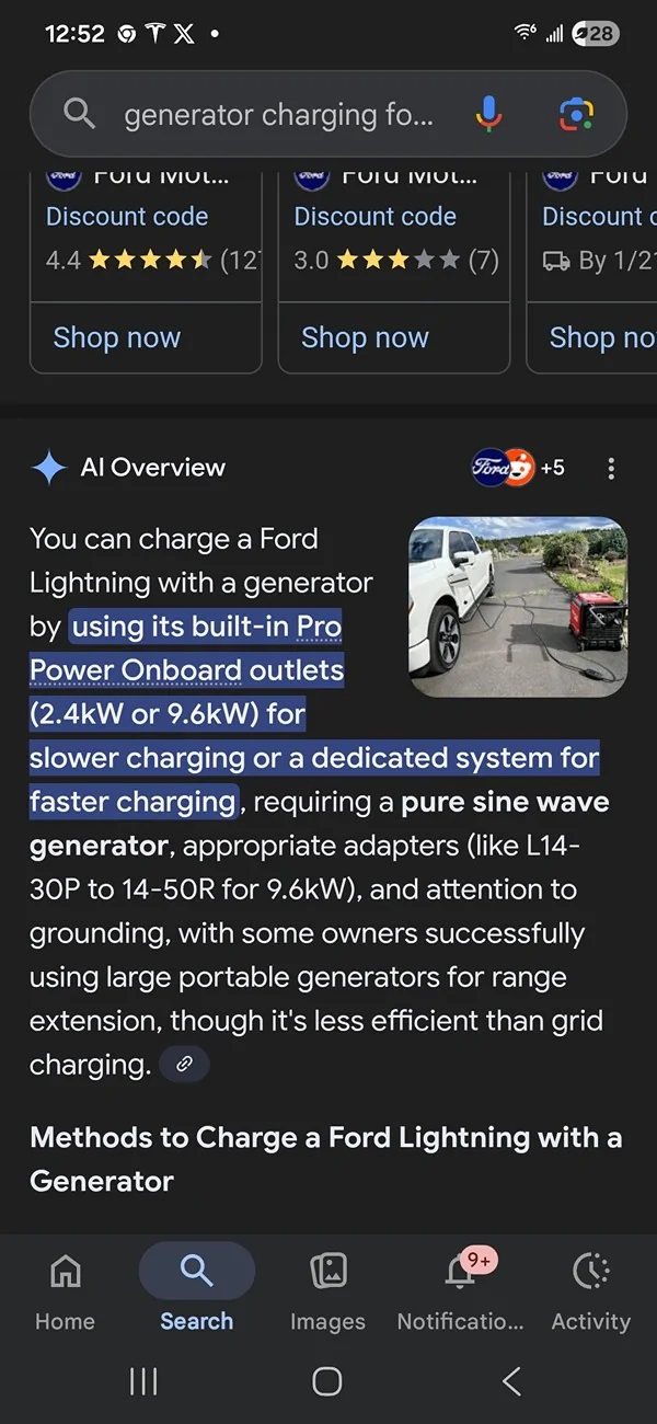

True? "You can charge a Ford Lightning with a generator by using its built-in Pro Power Onboard outlets (2.4kW or 9.6kW)"

Ford F-150 Lightning True? "You can charge a Ford Lightning with a generator by using its built-in Pro Power Onboard outlets (2.4kW or 9.6kW)" Screenshot_20260117_005214_Googl

So.... Yes, you can charge a Lightning with Pro Power Onboard from any other F150 if you stay within the current limit of 240v/30a for 9600 watt PPOB and 120v/13a for 2400 watt PPOB.
No, you cannot self-charge your Lightning by plugging it into itself. :oops: It will appear to work, but you will simply watch your SOC decline.

It is suggesting that you could backfeed power from a generator through the pro power outlets to charge the truck?!
AI got really confused.
Yes indeed - never trust AI!!!
And, like how would one do that anyway, with a so-called 'suicide cord?
What could go wrong!?
Would it blow up your DC-AC inverter in the truck?
Hopefully the PPOB circuit breakers would disconnect it immediately before any damage was done, but could we count on that I wonder?
I hope nobody is fool enough to try that!!!
