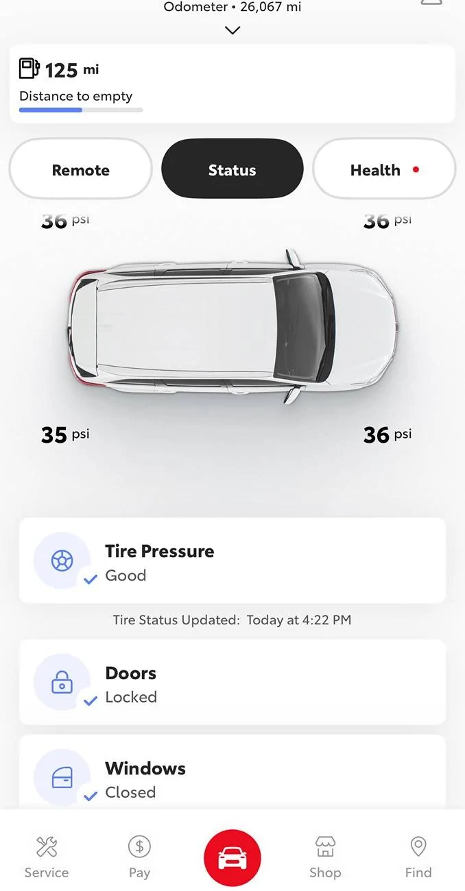

Something like this from my Toyota would be great. Shows door status and window status. It’ll even remind me if I left a window open and tell me which window it is.

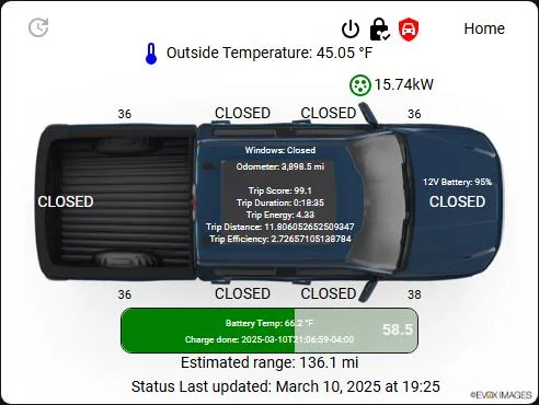

I used this thread: https://www.f150lightningforum.com/forum/threads/home-assistant-ford-f150-lightning-dashboard.17424/ (Thanks @Aminorjourney) and created this:
Ford F-150 Lightning Is there any way to tell if my doors are locked/unlocked on the Ford Pass app? 1741649327087-cs
I haven't added the individual windows yet. Since the sensor is open/close, and the attribute data only shows 2 windows, and I am not sure what kind of attribute data there is when a window is open. So need to test that out when I have a window open.
But shows all 6 open/close statuses, charge info, and last trip info (which I need to figure out better. Trip Energy wasn't 4.33kWh, and definitely not 2.7mi/kWh. Maybe it was 4% (truck went from 40 to 36%) but it would be weird to list trip energy in percent. No?)

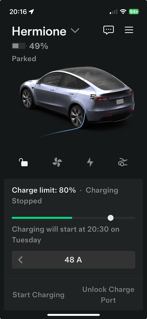

Is this still an issue? Coming from a Tesla, I'm surprised how behind the Ford Pass app is.
I agree, there are two big things I miss from when I had a Tesla, dog mode and being able to set the charge amps
