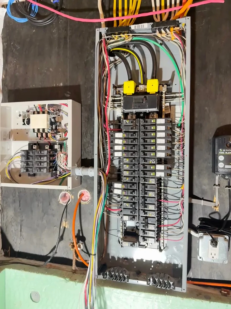

Third image: Generac 6854 open (while electrician was present during install)
Fourth image: Generac 6854 and my main load panel (during install)

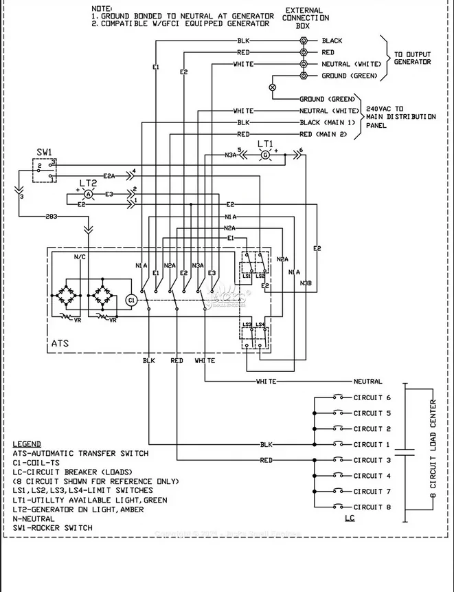

If you want to see the solenoid switching circuit, here it is:
Ford F-150 Lightning Issues with a Generac 6854 and my 2023 Lightning’s Pro Power Wiring Diagram 2
In this video at the end, it happens when he switches back to utility from the truck PPOB:
So bottom line it is nothing to worry about, but you could always manually turn off the PPOB and then switch back to utility, but then you wouldn't have a 'smooth' transition in the house.

I just noticed in your picture, you don't have the PPOB/truck connected to the GEN terminals.
This is how it should look:
Ford F-150 Lightning Issues with a Generac 6854 and my 2023 Lightning’s Pro Power 00-Generac wiring diagram - detail - colored

Switched power terminals: Utility at the top, generator/PPOB at the bottom above the output terminals that got to the breakers (those three are pre-wired by GENERAC).
sluser123
Mar 12, 2026
2023 Lightning Lariat 511A
Yes, just checked in those photos were from before he had ran the wiring to the power inlet box… I took this photo while my electrician stepped out to go grab the wire… my apologies on that… I will see if I can get a better photo…

I think your electrician may have miswired the GENERAC in the case of the latter and that just needs all the wiring to be checked. Specifically that the PPOB and the Utility neutrals are separated, that the circuit neutrals are the ones that correspond to the emergency circuit hots and not mistake has been made, like maybe using the wrong branch circuit neutral (that happened to me when I had a bunch of neutrals in the service panel that were hard to separately trace).
