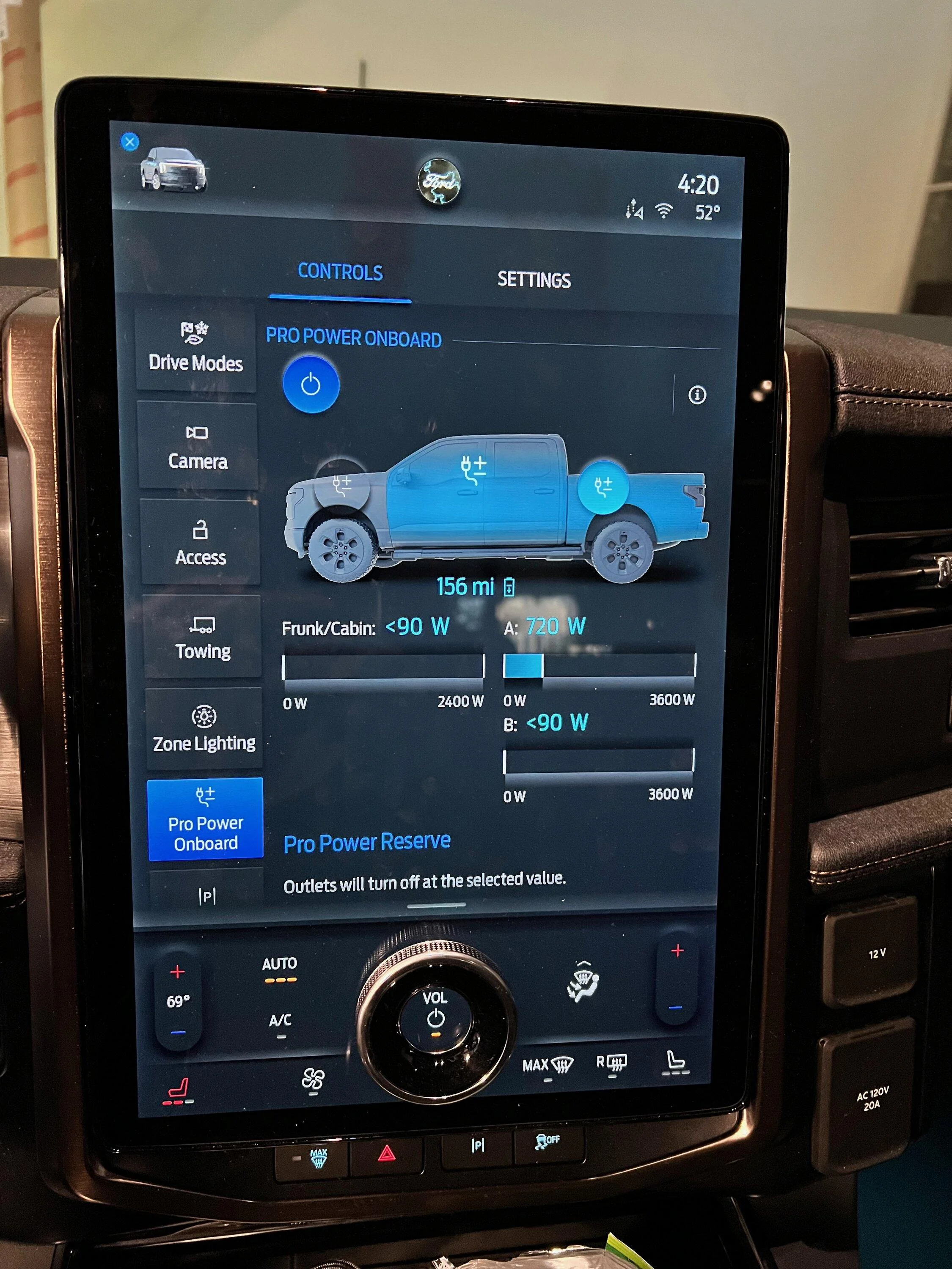

After getting it hooked up I ran on the Lightning for about 3 hours as a test.
No AC and at night so less things powered on - was not using microwave or coffee pot or toaster. Biggest current draw was probably the refrigerator.
Used under 2kW for 3 hrs, so about 6kWh or under 8% of the 80% charge on my SR 98kWh battery.

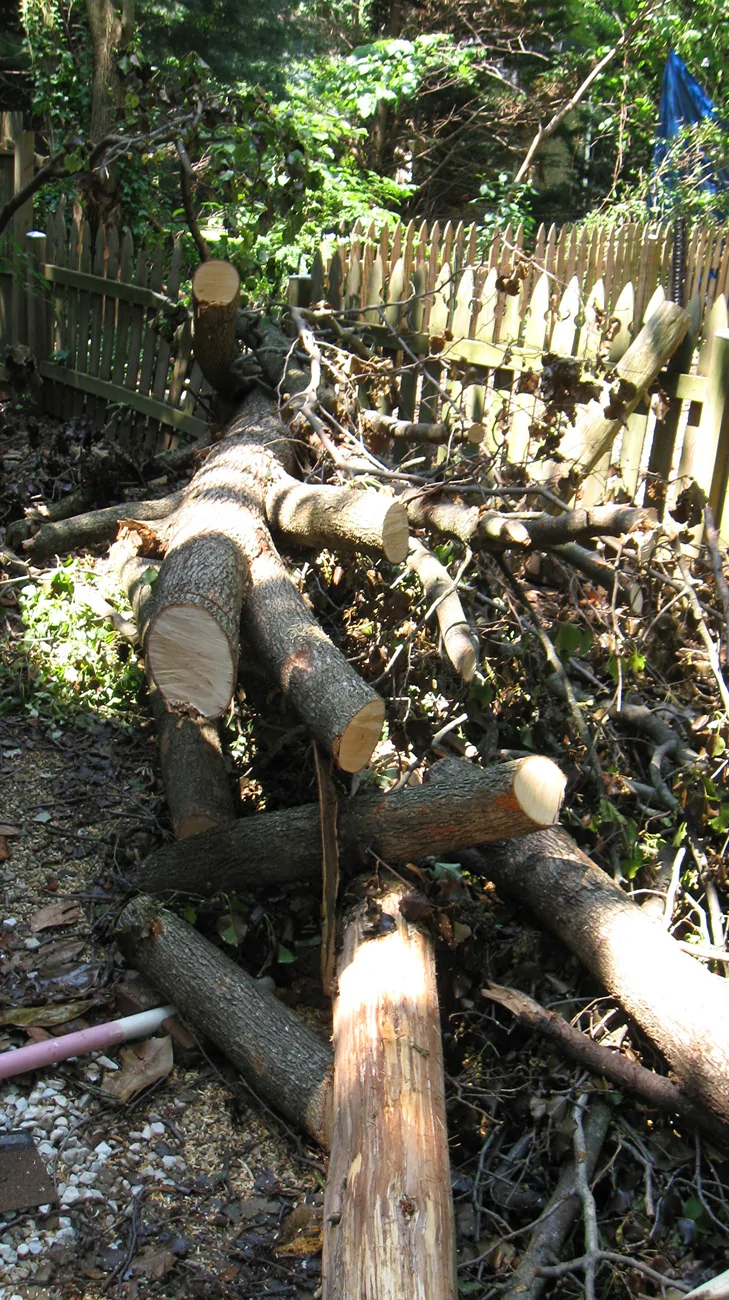

We had a neighbor's tree fall into one of ours, a magnolia about 50 feet tall, and half of it ended up on top of my wife's backyard pottery shed. I cranked up the gas generator and used an electric chain saw to cut one side, then the other, back and forth until I could roll the rest off the roof to the back of the shed.
The tree that hit our tree:

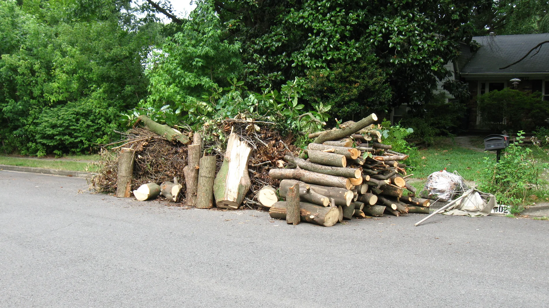

This was part of the pile I lugged to the street for pickup:

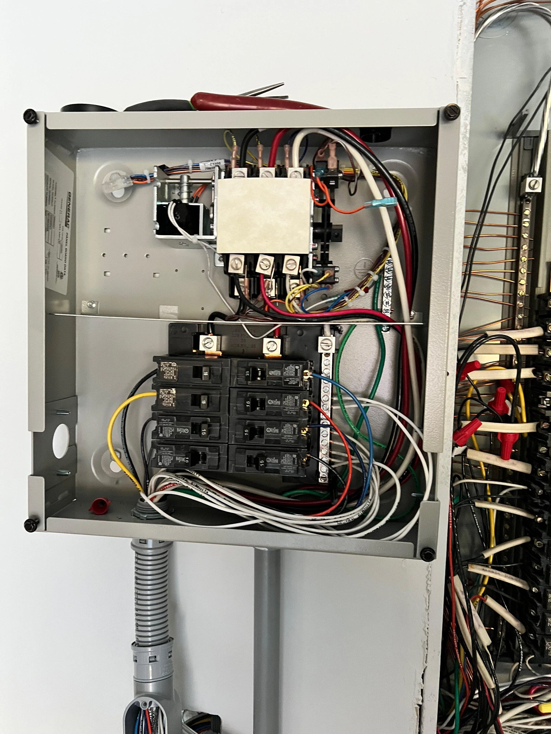

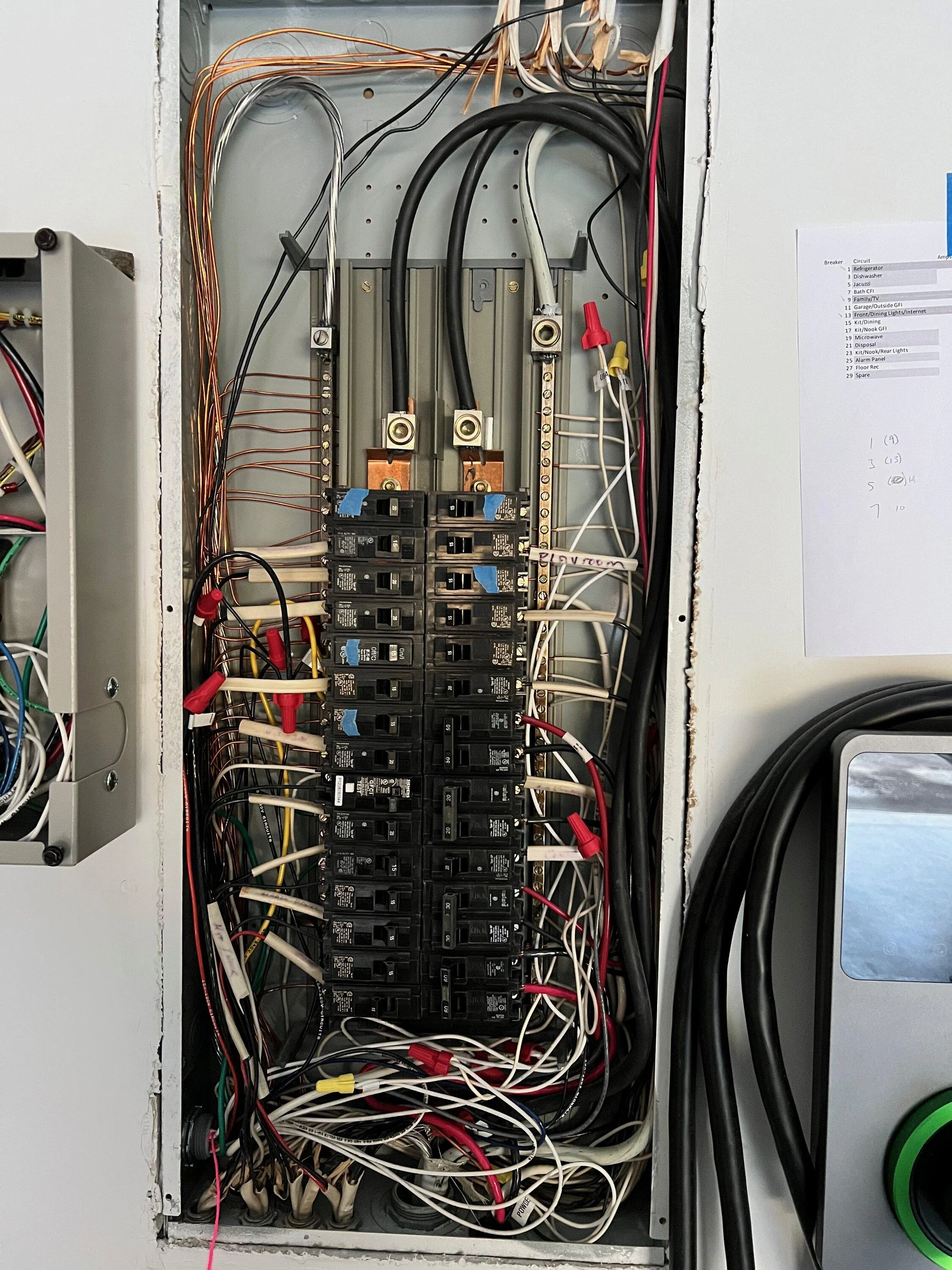

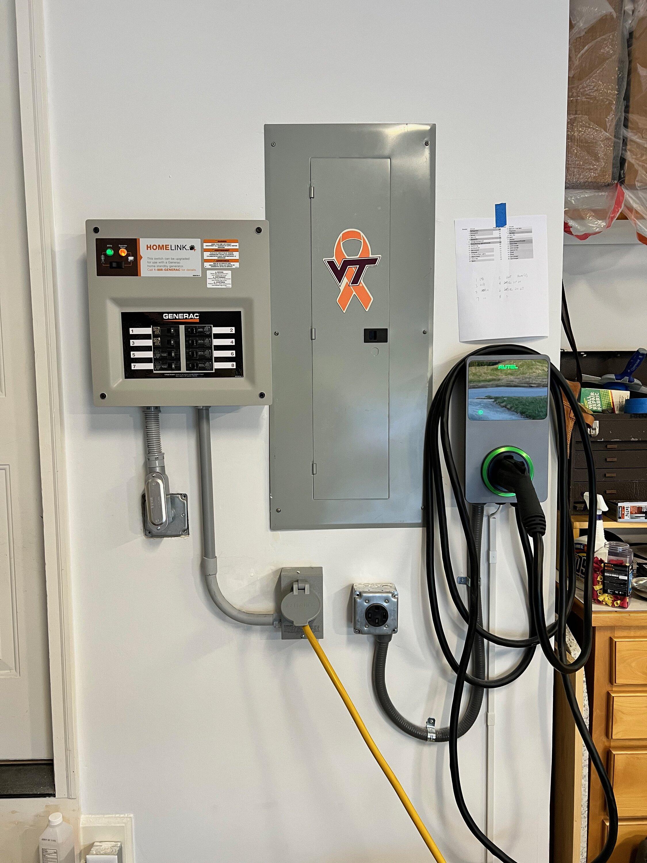

This past weekend I installed a Generac 6852 transfer switch to power my house from the pro power 240V plug. The 6852 is designed for a bonded neutral generator so it works perfectly with the Lightning.
My main electrical panel is at the meter base. In the main panel there are the maximum 6 breakers feeding 3 AC units, the oven, and 2 sub-panels. There is a 125A sub-panel in my garage that supplies most of the house and a second 90A sub-panel for a finished room on the third floor. I connected the Generac switch to the garage sub-panel.
The 6852 has slots for up to 8 breakers so you can supply 8 branch circuits. You can theoretically have more if you want to use tandem breakers. Because of the bonded neutral you have to route both the hot and the neutral from the chosen circuits to the switch panel so you end up with 16 wires plus the 4 feeding the grid power to the switch. The panel is supplied with 1" conduit and it ends up pretty full.
I have gas heat, hot water, and stove so there aren't any high current essential circuits. I chose to power the refrigerator, my two gas furnaces, plus 6 branch circuits. I made sure to power the circuits for my internet equipment, the TV, all of the bathroom lights, plus the bedrooms.

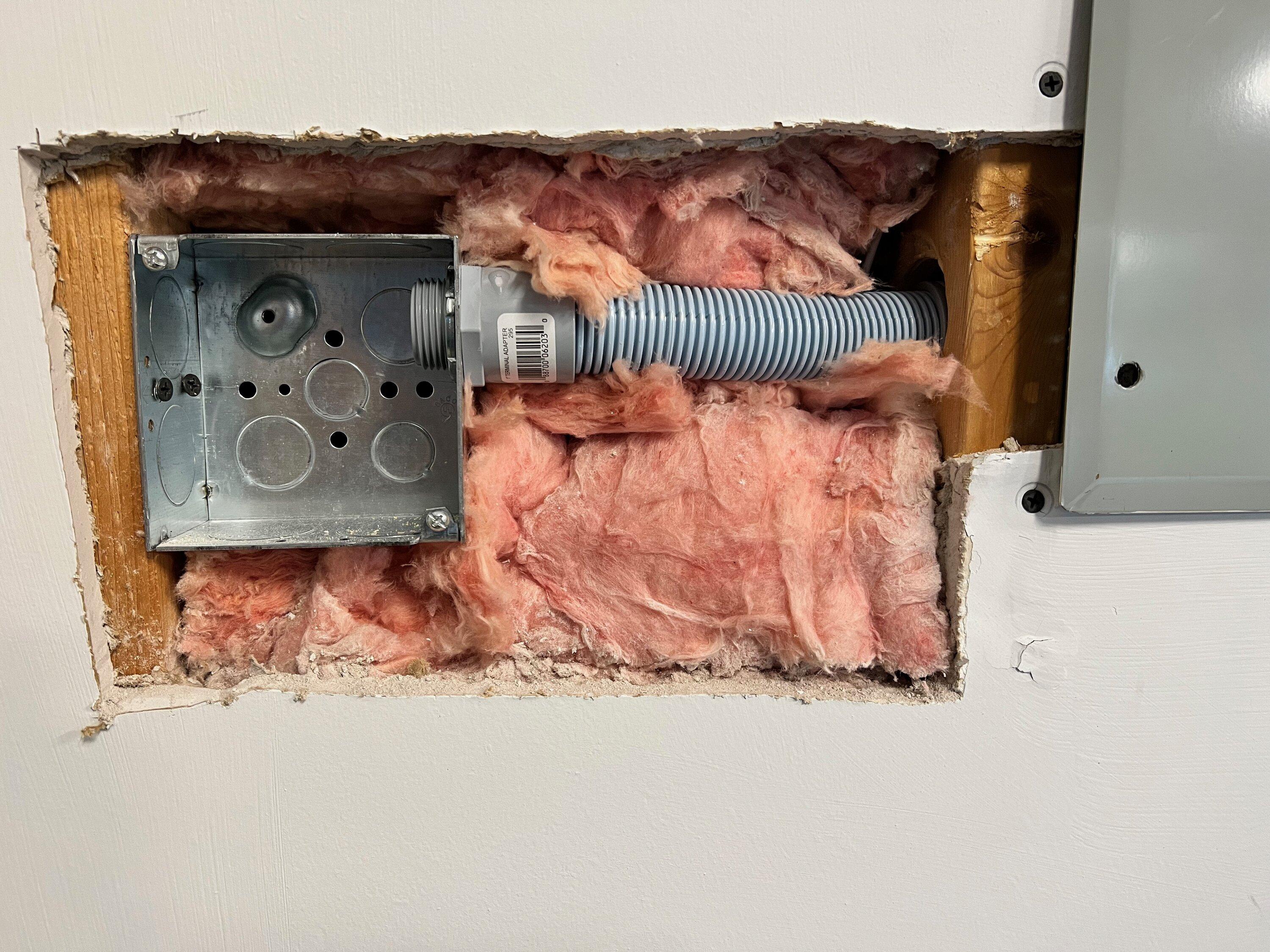

My garage panel is mounted between the studs in a finished wall. The switch panel will also fit between studs but because of a door the two studs next to my panel are only 11 inches apart. I had to mount the switch on the wall and then get the wires into the wall to feed into the sub-panel. I cut out the drywall and drilled through the stud to access the sub-panel. I then put a deep 4" box with 1" flex into the sub-panel. After patching the drywall I mounted the switch above the box and ran the wiring through a right angle into the box and pulled them into the sub-panel.
To feed the grid input to the switch I installed a 50A dual pole breaker into my sub-panel and connected the two hots and neutral to the switch input and then connected the two grounds together. I also ran a separate ground wire to ground the 4" box. Then I removed each of the 8 hot leads from their breakers and labeled them. I located the associated neutrals for the 8 circuits and disconnected them from the sub-panel neutral bar. Then I connected each hot to one of the breakers in the switch panel and connected each of the neutrals to one of the neutral wires from the switch panel.
The last step was to connect the power inlet for the truck power. I ended up buying a Reliance inlet box with the L14-30 inlet connector. I mounted it below the switch and routed PVC conduit to the box. I then pulled the 4 10 gauge conductors through the conduit and terminated them on the inlet and on the generator side of the switch.
I bought a 25' extension cord to reach from the back of my truck to the back wall of my garage and turned on the pro power. I switched over to generator power and it ran with no issue. The only significant load was the refrigerator but I verified that all of the circuits were powered. Now I'm looking forward to our next power outage.

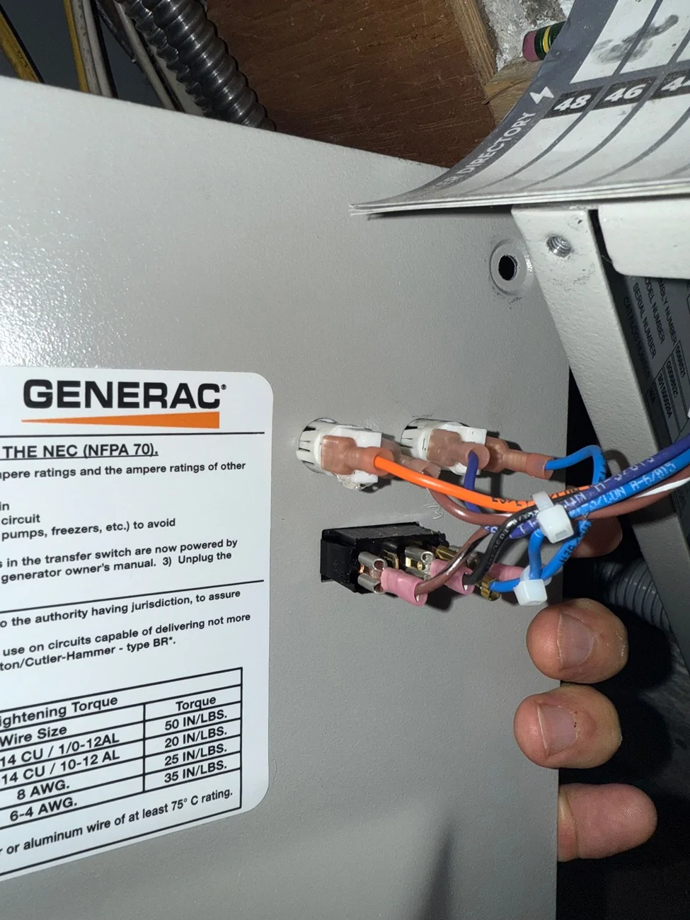

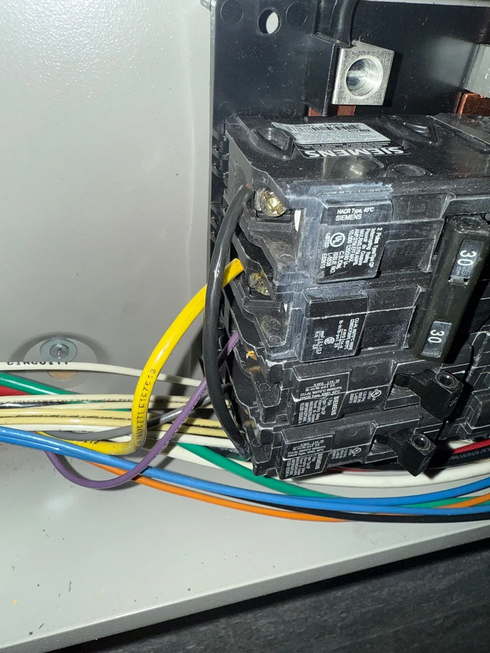

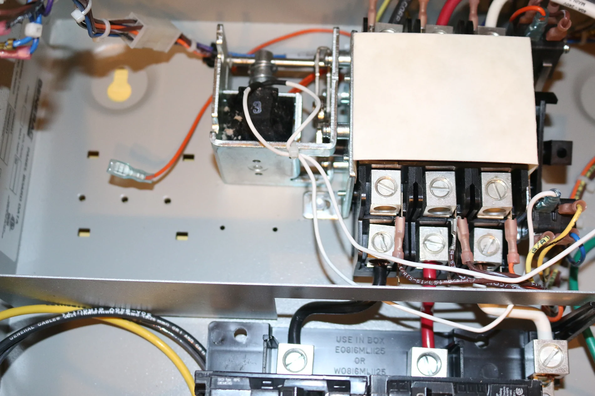

HELP! The Generac 6852 that I received has some serious build quality issues. Most of the blade connectors to the toggle switch have come loose and slipped off their connections and I am not sure where they are supposed to go. Generac was less than helpful. Could someone with this transfer switch take a pic of the backside of that toggle switch so that I can reconstruct (and then pinch these connectors down) the connections?
chl
CHRIS
Dec 16, 2022
2,270
1,391
alexandria virginia
Just be aware, they change the small control and switching wire colors seemingly at random.
I compared my 6853 with some I saw on youtube videos and the wire colors were all different except the hots and neutral.
I was trying to figure out where the unattached wire might go, but it turns out GENERAC leaves a wire unattached but didn't mention it in the manual - they do mention it in their FAQs on line at their web site.
Ford F-150 Lightning Generac 6852 Transfer Switch installed (to power my house from the Pro Power 240V plug) IMG_5563-unattached orange wir
The orange wire is the unattached wire that is 'normal.'
Ford F-150 Lightning Generac 6852 Transfer Switch installed (to power my house from the Pro Power 240V plug) IMG_5933-FRONT COVER INSIDE
Ford F-150 Lightning Generac 6852 Transfer Switch installed (to power my house from the Pro Power 240V plug) IMG_5929-Generac 6853
Maybe the above will help.
Good luck
PS: the 6853 and 6852 differ only in type of inlet box provided with the switch.

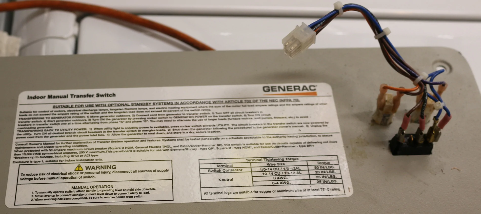

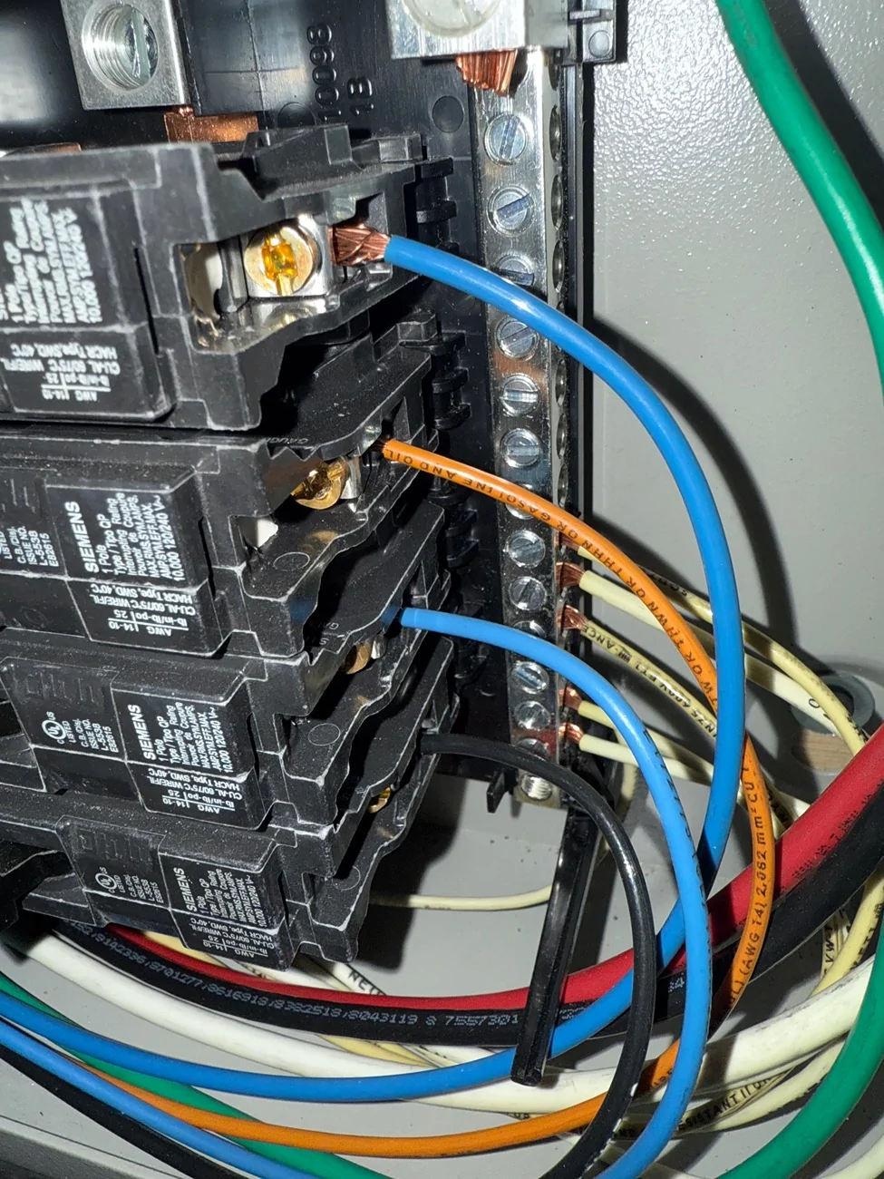

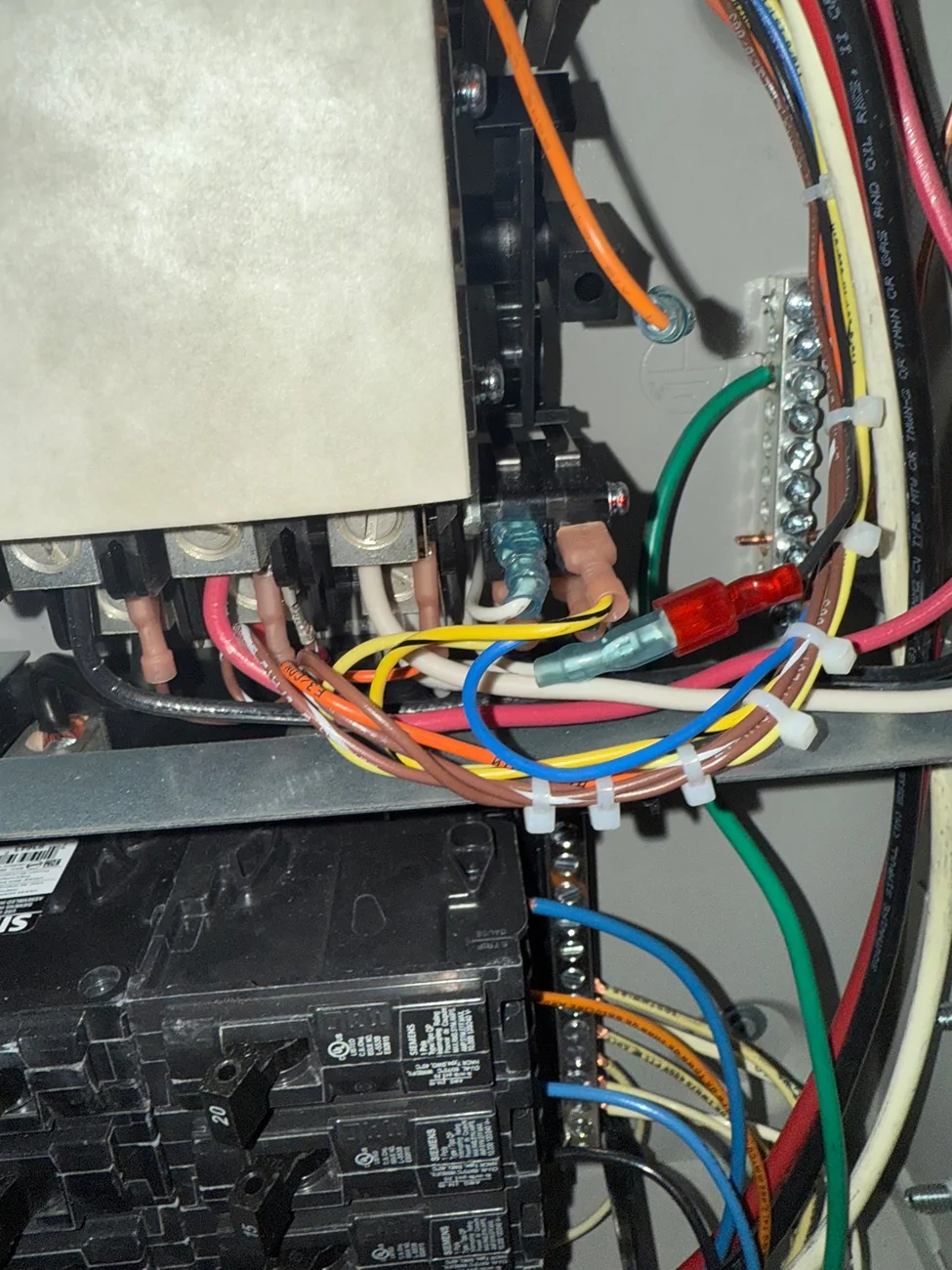

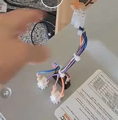

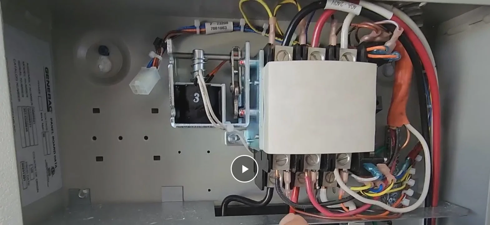

A couple more from videos of others' installations:
Ford F-150 Lightning Generac 6852 Transfer Switch installed (to power my house from the Pro Power 240V plug) Amazon user movie image 1
Ford F-150 Lightning Generac 6852 Transfer Switch installed (to power my house from the Pro Power 240V plug) Amazon user movie image 2 case plugs to lights
Ford F-150 Lightning Generac 6852 Transfer Switch installed (to power my house from the Pro Power 240V plug) IMG_5564-unattached org wir
chl
CHRIS
Dec 16, 2022
2,270
1,391
alexandria virginia
Note there are 4 wires to the two lights and 4 wires to the toggle switch.
If you look at the images post here, maybe you could trace the wires by color from, e.g., light to molex connector to be sure you have the right ones in the right places.
The wire color is the same on both parts of the molex connector - so blue to blue for example.
