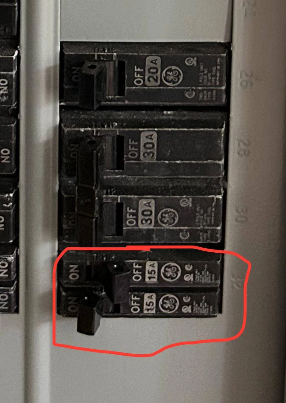

@Maquis okay, I think I understand.
In the pic of my MP below, the circled breakers are the for the MWBC that the refrigerator and dishwasher are on. The breaker that is ON is for the dishwasher; the breaker that is OFF is currently unused since the refrigerator is now running through the transfer switch.

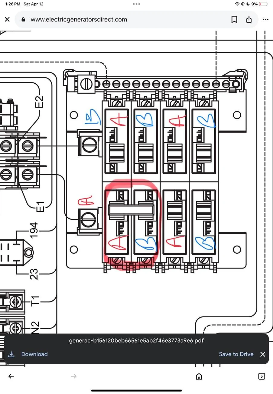

Ford F-150 Lightning Generac 6852 Transfer Switch installed (to power my house from the Pro Power 240V plug) 1744468137745-nc
If I understood you correctly, I could replace the single breaker in the transfer switch with these two smaller ones, and add the dishwasher to the transfer switch. I would just need to add a handle tie so that they’re both on or off at the same time.
Should that fix the issue and be the correct way to do it?
yes, you were on the right track with moving those breakers into the transfer panel. However, since you have a multiwire branch circuit, you cannot properly feed that from the Breaker you have in the photo. You will need to use two full spaces in the transfer panel, as mentioned before, or you can also look up quad breaker. It will need to look like what I have circled in the photo.
as you are aware, I’m sure, the purpose of the transfer switch is to provide isolation between the two power sources, in this case PPOB and the utility power. From what I understand, yours has a connection from one power source to the other through the sharing of the neutral. Probably something that could have or should have been identified by your electrician during the installation.
If that GE panel works the way I think it does (I haven’t seen one in years), those slim breakers are both powered from the same leg, which means they can’t be used for a MWBC. Please verify.
When you move it, make sure that the neutral for the MWBC also lands in the transfer switch panel, and that each hot is powered by a different leg.

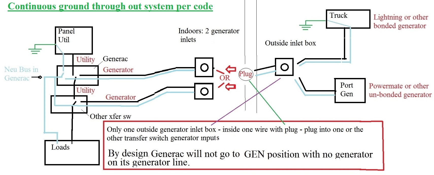

There might be a need to use it with a house having a transfer switch that does not switch the neutrals, or uses an interlock, in order that you do not have the neutral bonded in two places, i.e., the generator and the house in question.
Before I got the lightning, I had a floating neutral (unbonded) generator and a transfer switch that did not switch the neutrals.
In my case, rather than unwire the old transfer switch from the service panel, I added a GENERAC 6853 transfer switch to the system in such a way that I could use one or the other transfer switch as required by plugging one or the other source into one or the other transfer switch.
This is the block diagram:

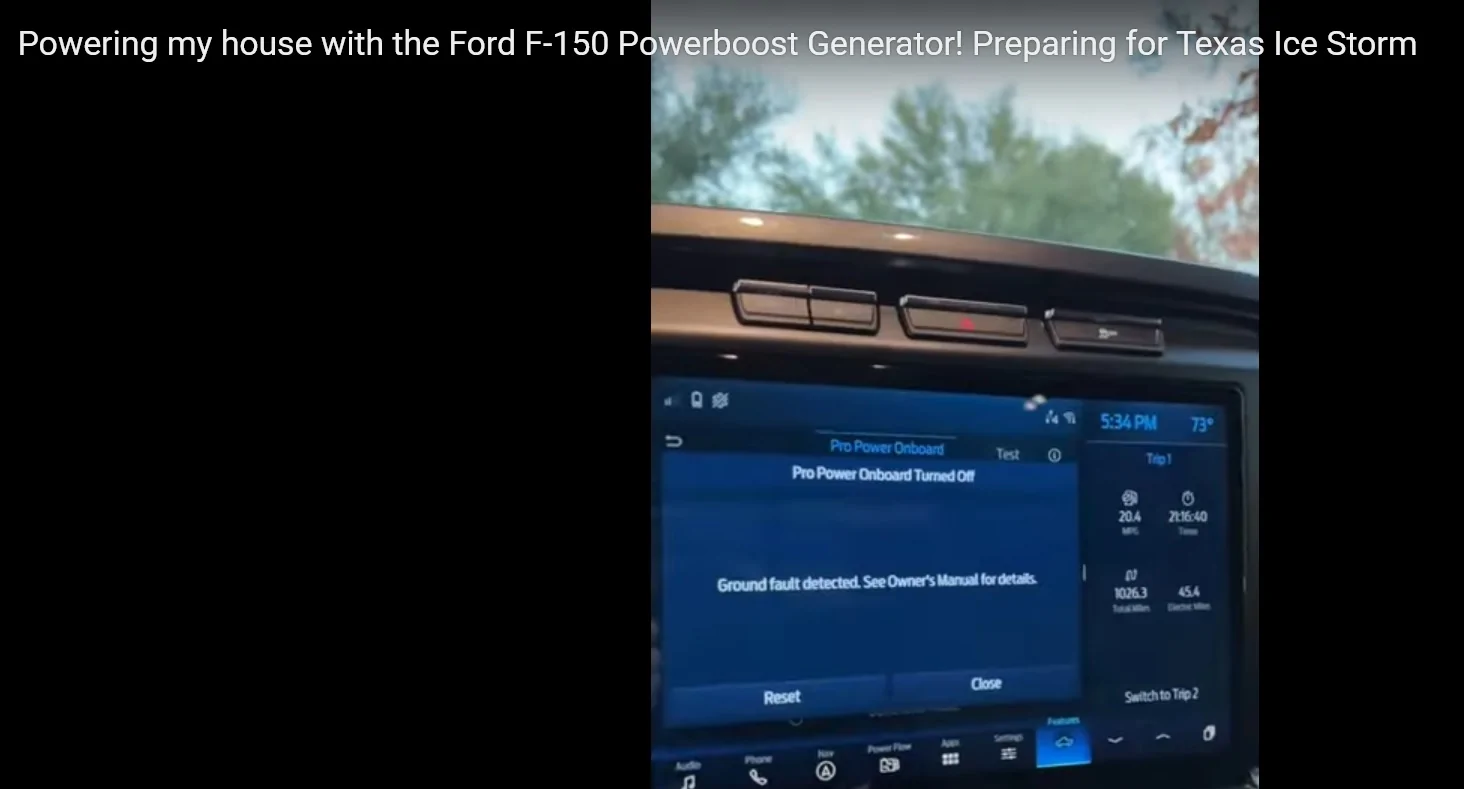

One thing you will notice about using the GENERAC, when switching between the utility and the Lightning, if there is utility power (such as when the utility is restored), if the Lightning propower onboard is on, the Lightning will turn the propower onboard off and indicate there was a ground fault. There wasn't really a ground fault however, however the switching created a transient electrical pulse on the connection to the Lightning causing a ground fault detection, most likely due to the magnetic field in the solenoid in the switch collapsing as the transfer is being done.
At the end of the YouTube video, you can see what the Lightning screen shows.

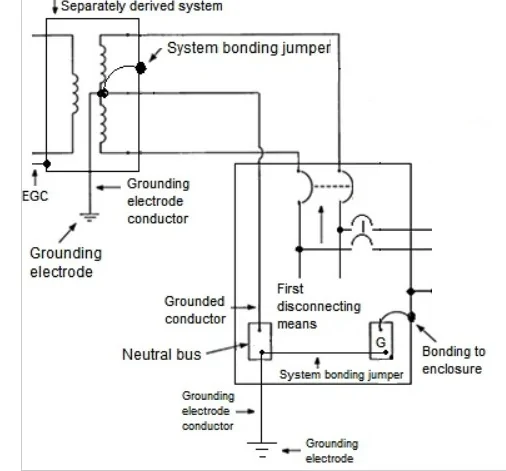

Ford F-150 Lightning Generac 6852 Transfer Switch installed (to power my house from the Pro Power 240V plug) YouTube Video - happens to this F-150 as well
Not mentioned in the video is that a bonded generator should have an earth ground nearby according to the code (NEC as well as OSHA) when powering a dwelling. The code says grounded nearby or something like that. I plan on installing a ground rod nexxt to my driveway and connecting the Lightning to it.
I was considering using one of the jumper lugs or attaching to the chassis, but it may be easier to us a plug with only a ground wire plugged into one of the bed outlets - their ground should be continuous with the 240V outlet ground as all outlets on any generator generally are.
