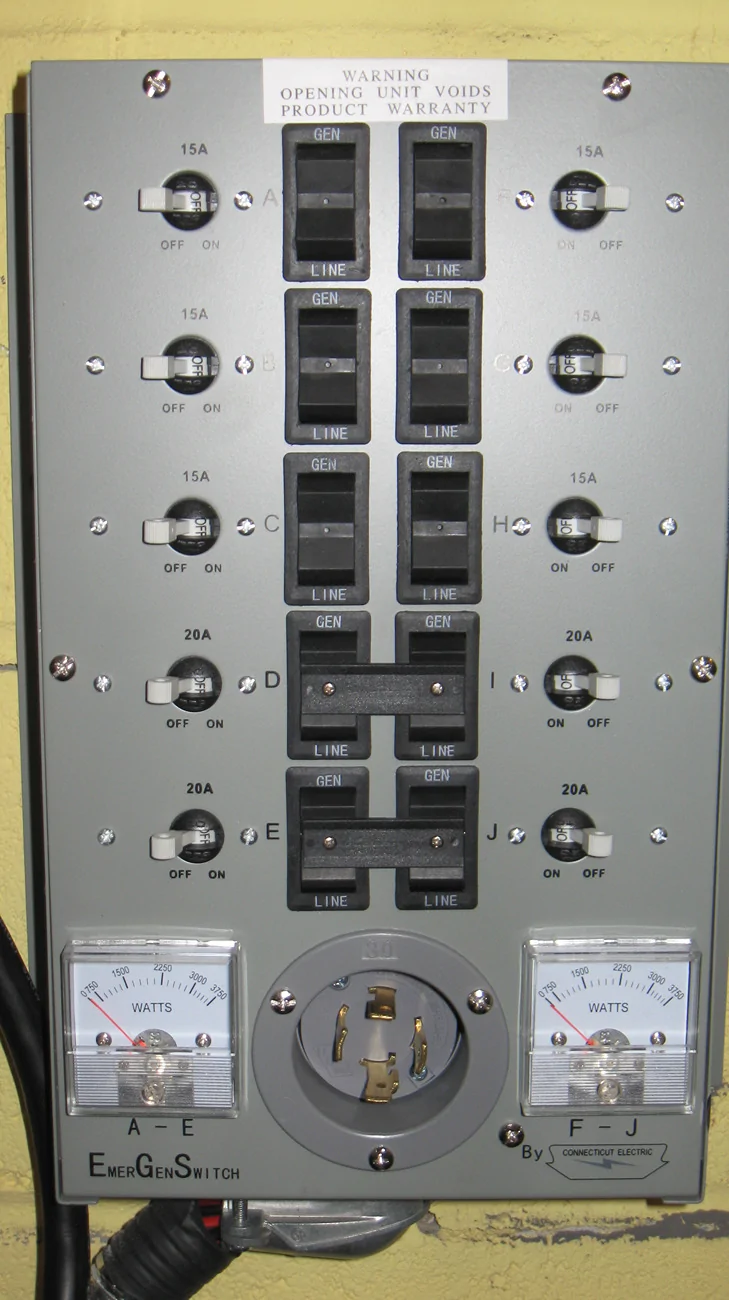

I enjoy the one touch activation - my old one required flipping a switch for each circuit:
Ford F-150 Lightning Generac 6854 with 120 VAC input IMG_3892
The meters were a nice touch to see the balance or imbalance, but now I can see that on the screen in the Lightning...but not in the Ford APP!

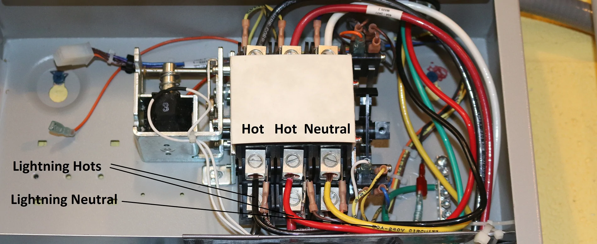

You tried it with only E1 and E3 (120V hot and neutral) connected right?
I think that when I first tried it, I had already tied together E1 and E2. When it warms up, I'll try (and document) a few possibilities. For the time being, I'm happy with switching it by hand.

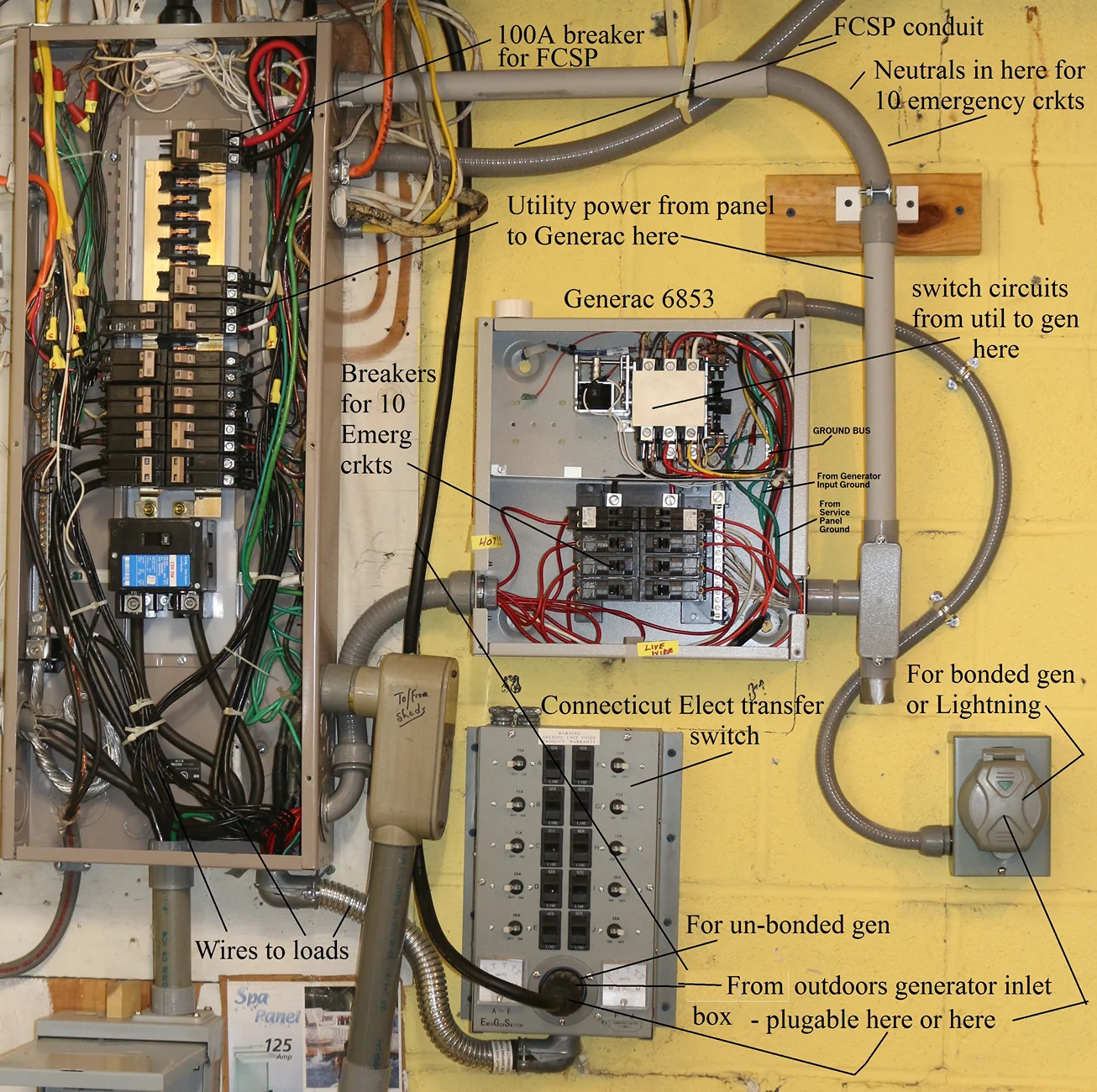

You might be interested in how I wired the GENERAC with the old transfer switch so I didn't have to unwire and dismount it for the wall - yes sometimes I AM lazy, lol.
Ford F-150 Lightning Generac 6854 with 120 VAC input Block diag of 2 xfer sw hook up w inlet boxes (2)
Looks easy on paper...
Ford F-150 Lightning Generac 6854 with 120 VAC input IMG_5926-final wiring before gen tests
In retrospect, hindsight is always 20/20, taking the old transfer switch down and just using a bonding plug with the gas generator through the GENERAC might/would have been easier.

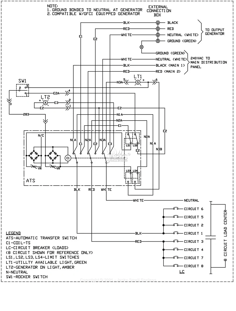

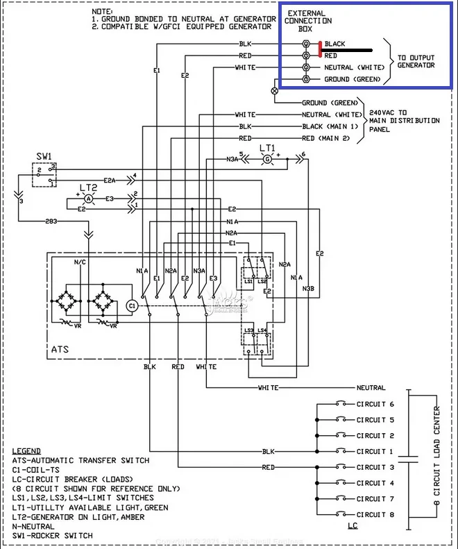

The solenoid is an odd bird, with the 2 full wave bridge rectifiers feeding it. (I don't know what the actual resistance across the variable resistors are, so dont know what the dc(ish) voltage to the coil is intended to be). When the weather warms up , I may remove the solenoid and put it on the bench and see what goes on with it. Before having the schematic that shows the rectifiers, I had incorrectly assumed that the coil was dual voltage, given the four wires feeding it, and given the 8.8 ohms across the orange wires. But no such luck.
With the two rectifiers, it seems plausible that the designer was thinking about setting the VR's differently, so that different AC voltages (util vs gen) could be used to operate the coil. The fact that Amazon sells the 30A switch as 120 v, (but the 50 A as 240) might be because of that... or it could just be an error.
An edit to the above, more or less:
The things that I have called variable resistors are much more likely to be varistors, which are devices that are found commonly in surge suppressors, so much of what I said above is probably bs.
I've decided to clean up the installation of my switch, (trimming wires, fitting conduit, etc.) and cut an access hole in the faceplate to make it easy and safe to actuate the switch manually. If, in the future, I feel a compelling need to tinker, I might modify the solenoid circuits to make pushbutton operation work on either 120 vac or 240 vac.
Most of my exposure to circuits of this nature has come from poring over schematics of industrial equipment to devise procedures for protecting the people who work on it. By the mid 1980's 24vdc was used as the almost universal control voltage (whereas earlier, it was often 120 vac). So it is somewhat SHOCKING (ho ho ho) to see that 240 vac is wired to that flimsy little selector switch held in place by flimsy plastic tabs. If 24vdc were used to operate the switching solenoid, then it would be easy-peasy to make the switch operate with either 120v or 240 generators. Also then the switching mechanism could be an industrial grade three phase dual throw contactor, which would not require the funky looking external actuator and cardboard arc blast shield.
Yes this GENERAC is not an industrial design by any means, a home use item for providing emergency backup power now and then.
Varitors (MOV) do vary in resistance from a high resistance until they are presented with a surge then to zero resistance to shunt the surge past what ever they are protecting.
I guess they are there to protect the diodes when the coil collapses and produces a kick back voltage of opposite polarity. But it seems they shunt it to the input lines, e.g., E1, E2 and E3?
GENERAC said the coil is a 12v DC coil but if it is supplied by the didoes from the 240VAC according to the schematic it must be about 32v DC. If it were supplied by just 120V AC then is it would be closer to the 12v DC that GENERAC said.
Since there are diodes feeding it, it is a DC coil.
Somehow a transient makes it to the GEN lines, which I suspected might be via the make before break switches arcing or bouncing.
Seems like surge protection on all lines into and out of the GENERAC would be a good idea.
