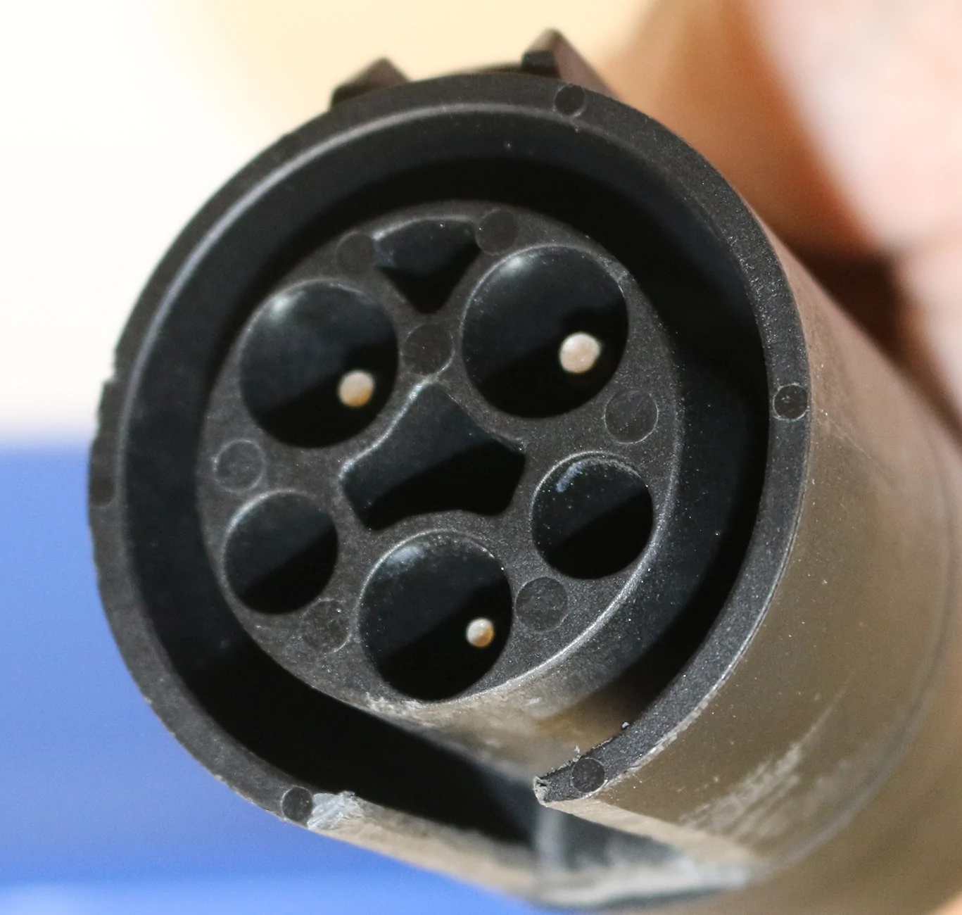

I bought an A2Z 16ft J1772 extension - AZ often has discounts and maybe there is a code for forum users?
I modified it so I could use it with my FCSP - cut a small bit of plastic out of it would fit the CCS1 plug:
Ford F-150 Lightning J1772 to J1772 Cable extension IMG_6010-notched
Tested and works with both the Lightning and my Nissan Leaf.
Even with out the little bit of plastic it attaches firmly and locks to the CCS1 plug.
