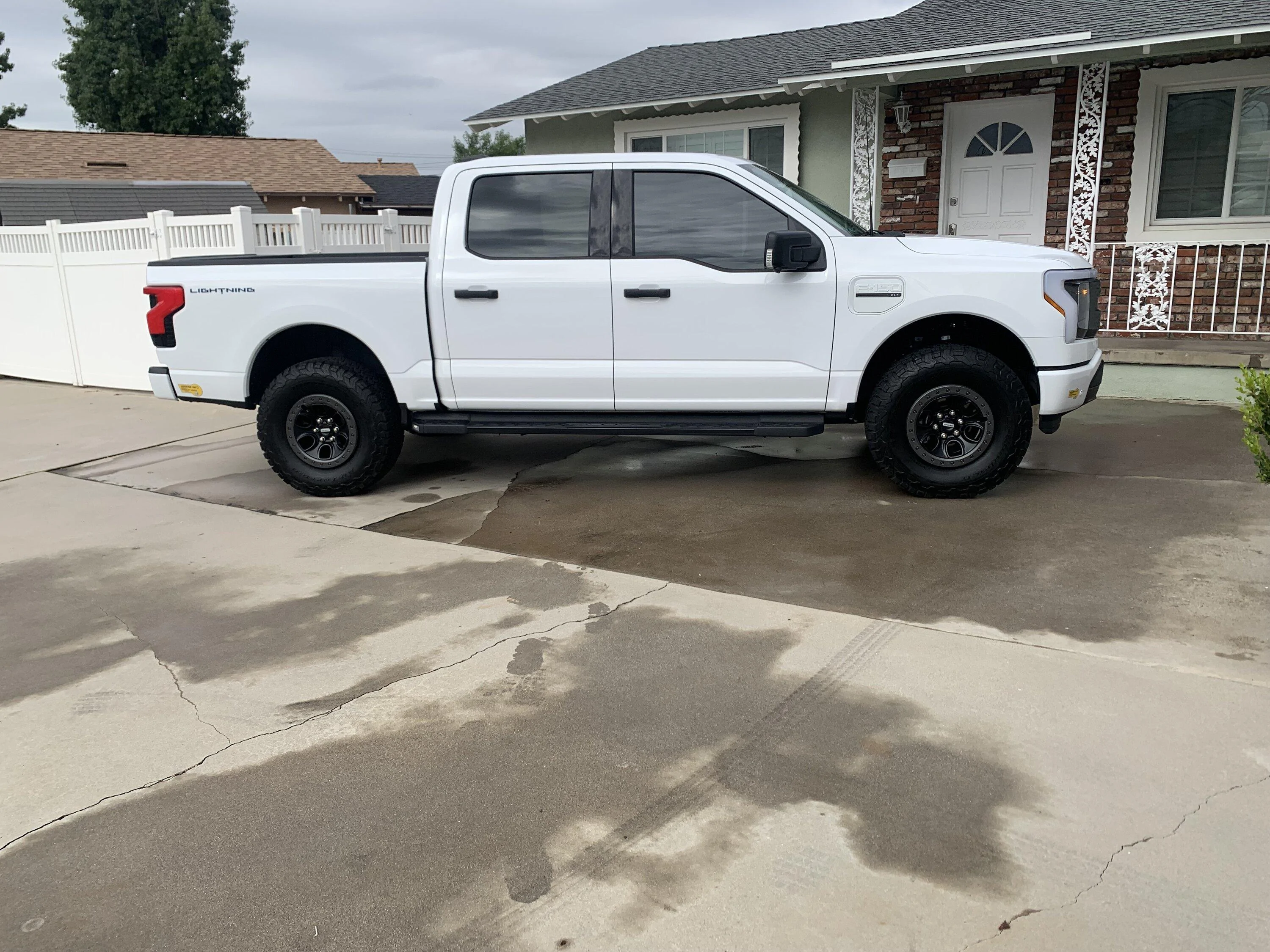

I just got it lifted. 2 inch Procomp spacer lift with 270/70/18s on black rhino rapids and falken wild peaks. Looks killer. I'm waiting for coilovers to come out ( for a lift) icons with external resi maybe
Milage drop from 2.0. 2.2 on a good day to 1.8. More realistic 1.65 the way I drive. 265 miles with 90% SOC now it's down to around 200 to 220 per 90% SOC.
Pretty big hit in milage with agressive tread tires

Ouch, that's a hard mileage hit but it looks great.
Yeah. I blame 15% of that to the lift and 85% on the all terrain tires. I'll burn them up in 9 months. I'm looking forward to the EV toyos I saw. They look like they get plenty of traction and hopefully better milage

Looks amazing!
Look at Nokian NAT

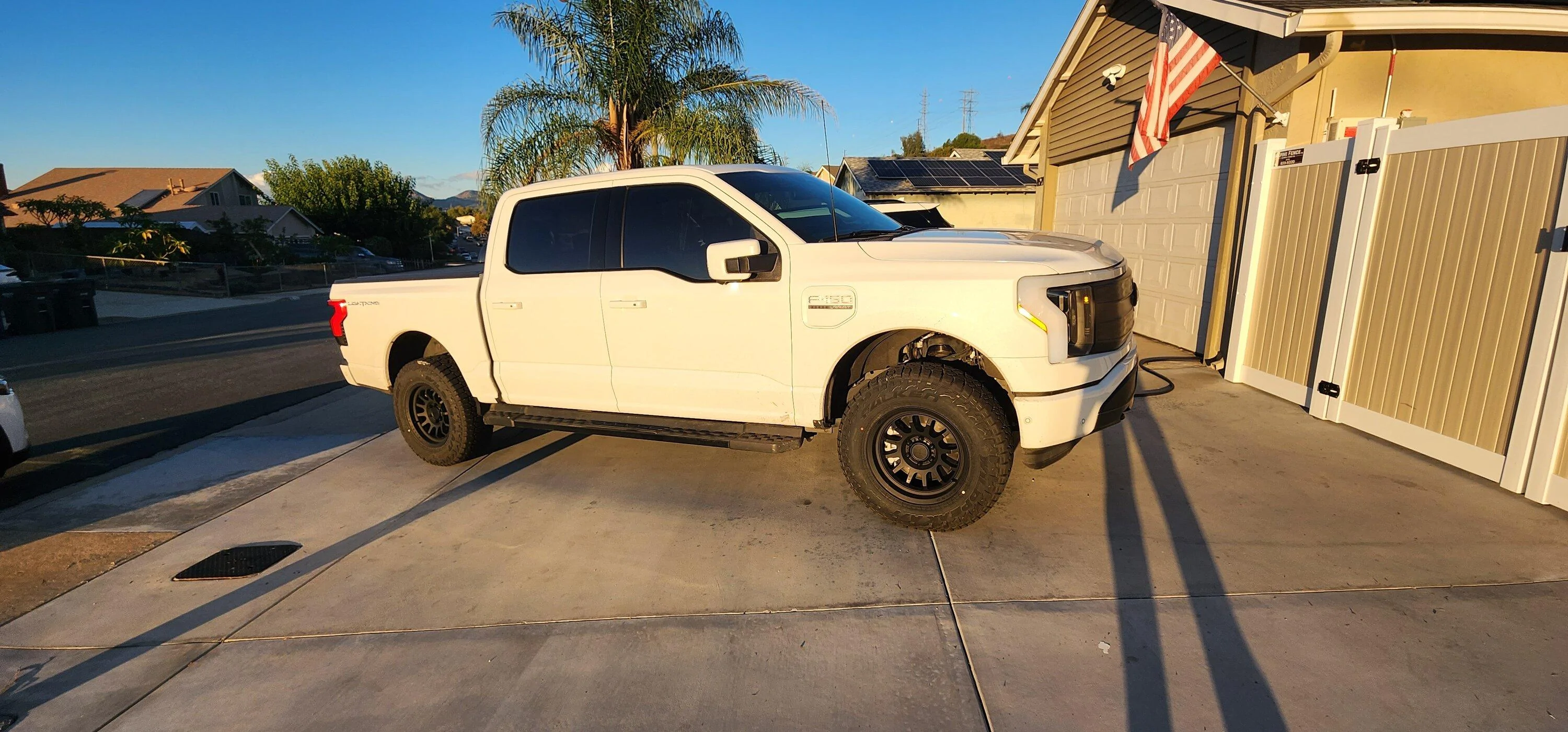

Yours looks awesome, still haven’t seen another leveled one besides mine in the wild only online.
I did a ReadyLift 2” leveling kit with a set of 2022 Raptor takeoffs. 315/70/R17 BFG K02s. My range dropped by about 20% with my standard range battery and and LA traffic.

Thanks. I'm searching around for some slightly used coilovers to replace my front springs.
How is your bluecruise?
Now that I lifted my truck it swings back and forth between the lines. I only noticed this on one trip but on a long downhill it seems to not ping pong as much. I think it does have something to do with the camera or sensor seeing the lanes. Because when I was flat or uphill it seemed to ping pong more.
This could also be due to the alignment being different. The steering definitely feels more twitchey since the lift. I don't know what angle ( camber/ caster etc. Does this )
Maybe a different upper controll arm could help
I wonder if the dealer can aim the camera downward to compensate if it is the camera

No BlueCruise on mine. Didn’t want to spend the extra 10k, when I ordered( January 2022) the options were very limited.The 315s definitely make it a little slower off of the line but I think it looks way better than stock.

Are you not concerned that you have 113 load rated tires on a vehicle that specs a minimum 115 and preferably 116?
