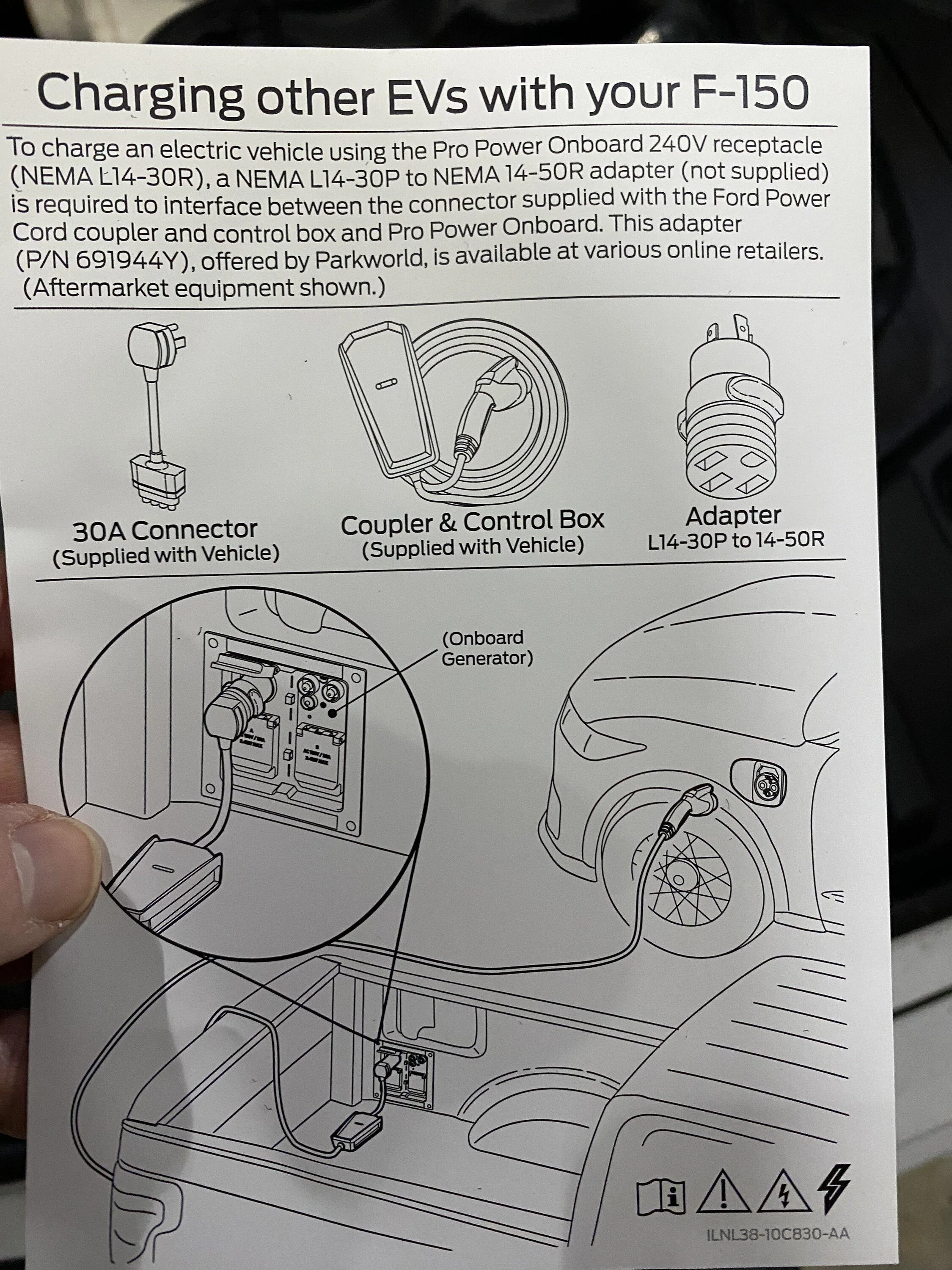

I originally was hoping to simply replace the receptacle with a 14-50, but my L6-30 is older and only has 3 wires (no neutral). If the wiring was appropriate (which is not), I could also replace the breaker with a 50A. This is what made me consider the adaptor approach.
It seems like the clear consensus is the adaptor is not a good idea for several reasons. I agree after seeing all the advice here (from people clearly more knowledgeable than me). One interesting thing to note is that I originally got the “adaptor idea” from Ford. It was on a slip sheet included in my mobile charger case. It was a suggested option when charging from the Lightning to another EV using the mobile charger.. I’ve attached an image for anyone interested in it (although you may have the same sheet).
Again, thanks everyone for the help!
