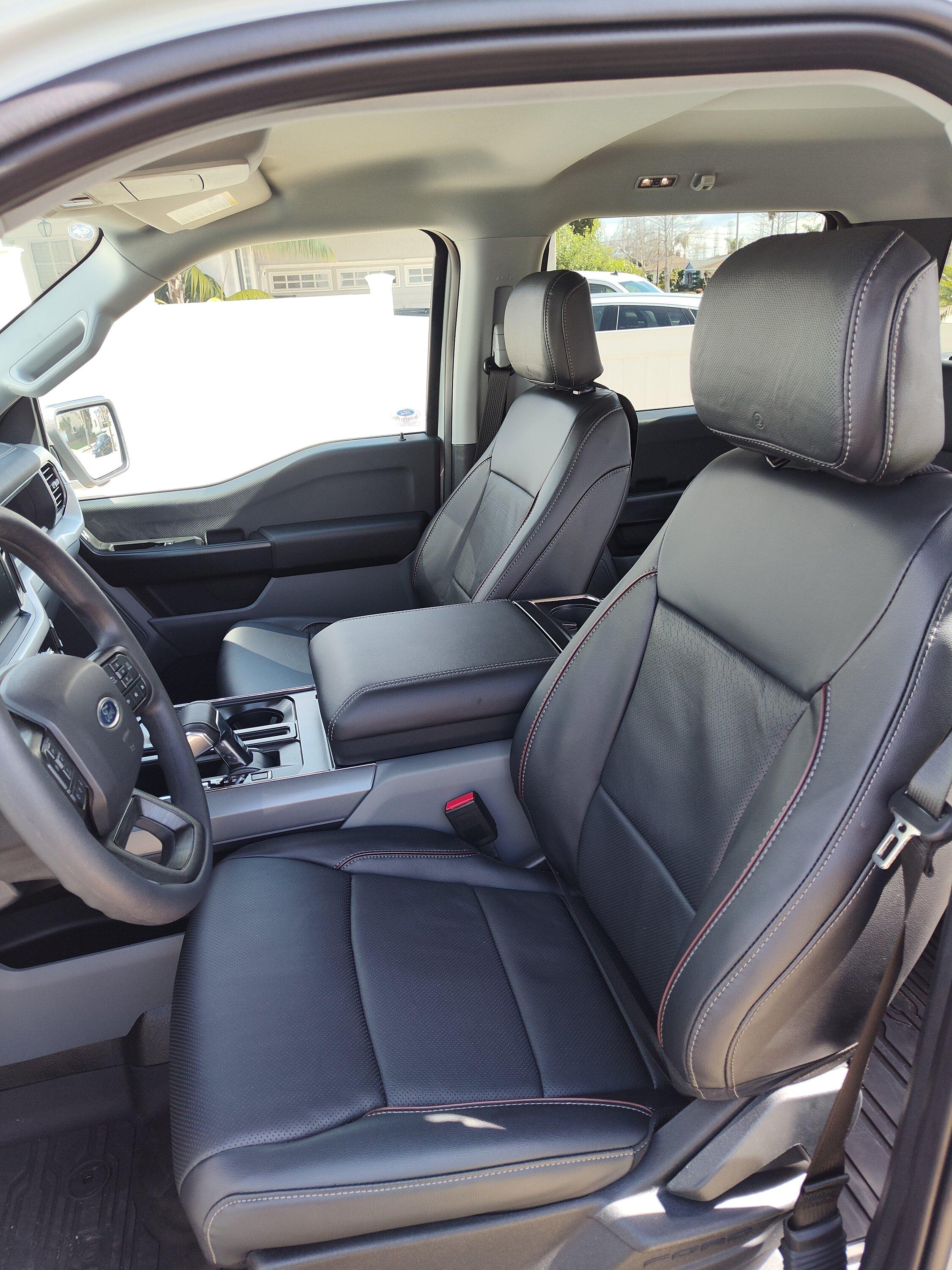

I swapped the pro vinyl for new leather lariat ice take off seat covers. Found them on Ebay, I'll leave the link below. Seller was amazing. I think I paid 150 with free shipping. The Ford tags on the seat covers are from Jan 23. Install wasn't hard, just tedious. I'd say it took around 6 hrs total and some sore fingers. I had to take the rear seat cover to a local upholstery shop to patch the arm rest section. They charged me $120 bucks. I need to use a heat gun to remove some of the wrinkles, but I'm very happy with how it turned out. Several videos on Youtube if you're curious about taking this on.

Ford F-150 Lightning Lariat Leather installed in my Lightning Pro IMG_20240221_114319072
Ford F-150 Lightning Lariat Leather installed in my Lightning Pro IMG_20240221_114413740

That’s outstanding. Did you take off the cloth layer or just put the leather on top?
Thanks! Unfortunately you have to remove the factory seat covers and install the new ones. This requires removing the seats from the truck.
