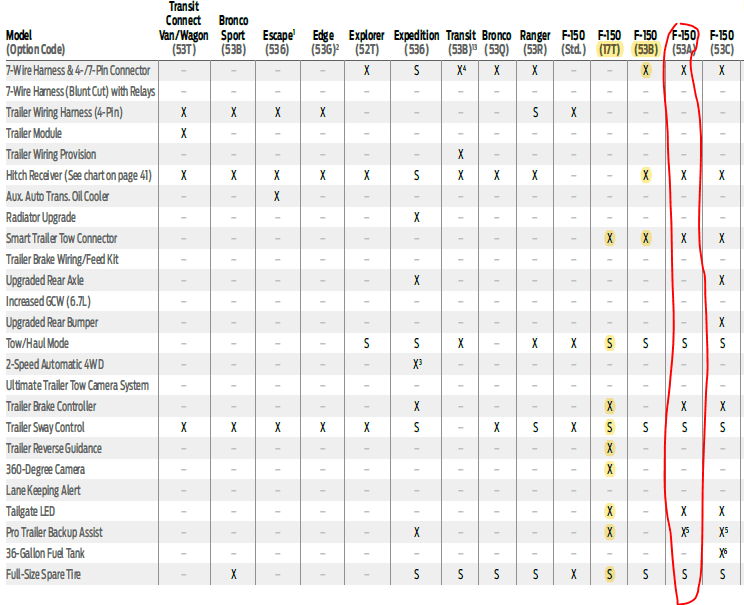

Read the post on the differences between packages and the ford towing pdf. Since the Lariat comes with Class IV hitch, 7 pin harness and adding the tow tech package, i think it gives you everything the Trailer Tow Package has. However, i do note that the ford towing pdf says
"Do not exceed a trailer weight of 7,000 lbs. (3,175 kg) or 36 sq. ft. (3.4 sq. m) trailer frontal area with only the Class IV hitch (53B), without the Trailer Tow Package (53A)."
From what I can see in this table, 17T combined with 53B gets you everything the Trailer Tow Package has (53A), but at $975 less cost. Is there something that I'm missing that the 53A has over the combined 17T and 53B?
Do recognize that the trailer weight disclaimer of 7,000 without the 53A, seems like that might the only thing?

Seems like an ordering guide quirk that only happens if one orders the Active 2.0 Prep, without the Active 2.0 Prep the pricing difference between the packages is $210 ($1,090 less $880).
But the pricing difference still does not make sense to me since the 17T and 53B combined have all the items of 53C (and additionally one also gets the 360 camera).

You guys sound like me last week. Spent hours looking into this. The only difference I could find is the solid sway/stabilizer bar in the Trailer Tow Package. Everything else I could find was identical, even the cooling.
I ended just going with the Tow Technology Package as it comes with the 360 cameras. I don't plan to tow more than 7000lbs, though I can always add a solid stabilizer bar for a lot less than the $1000 difference to upgrade to the Trailer Tow Package. Ford has stupid packages that only confuse people and let's Ford double dip on some items.
