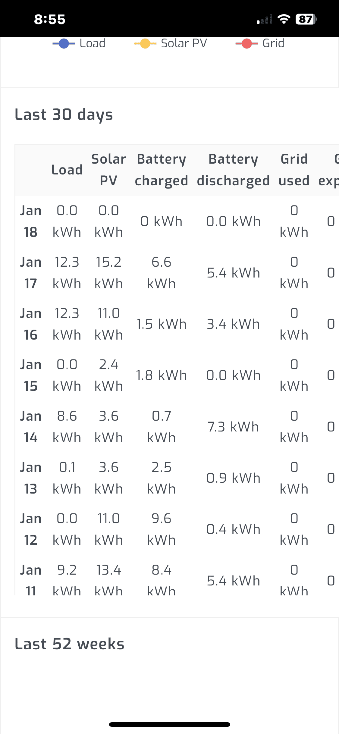

As one might expect, days are getting longer, and we broke another PV input record. I wasn't sure in the winter we'd get to 15kW, which portends to good output this summer.

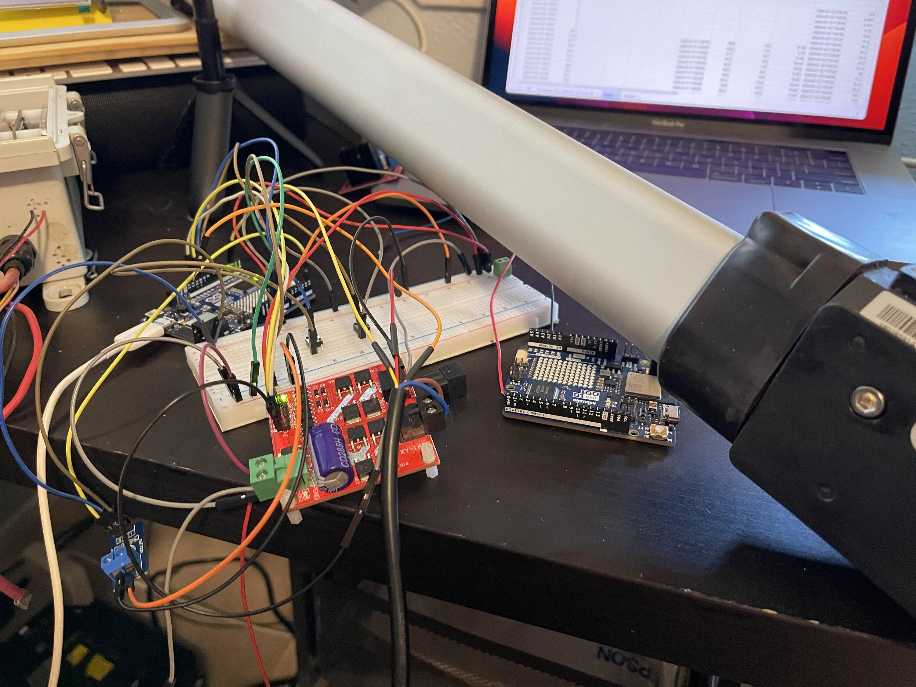

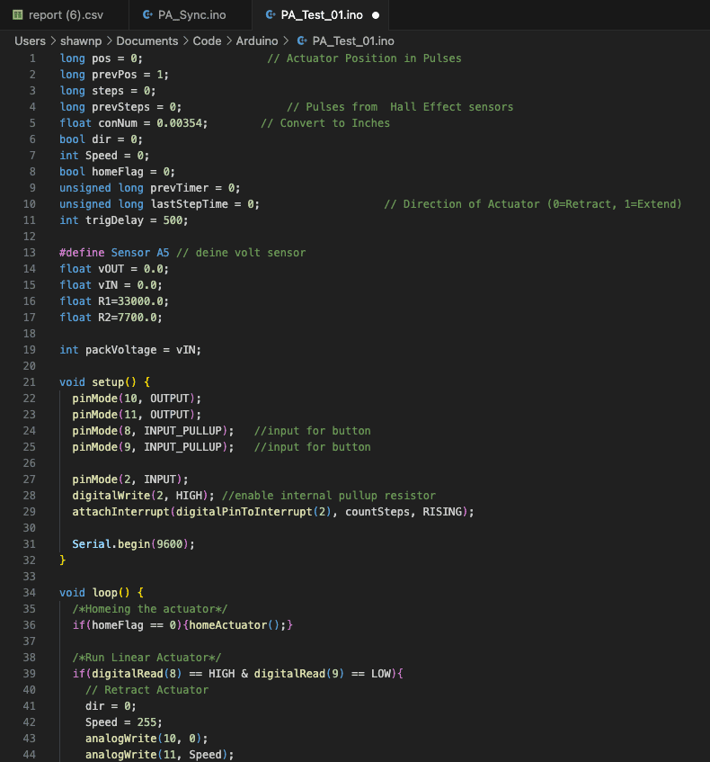

Working on the PA Hall sensor actuators
Have one moving as I would like with the motor drivers I've been using, and added a voltage monitor. Next working on syncing 3-5 of them. Wasn't sure I'd be able to use my dual h-bridge controller, but it looks like two of them might work.
