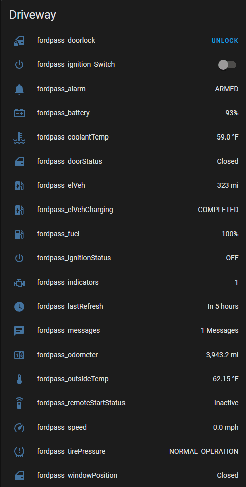

Very nice. I just setup the HA integration and I like the extra info like 12v battery percentage and windows position. I setup a 2nd Ford account like your Github wiki outlines just to be safe. Here is how mine looks currently. I only charged to 100% last night, because I am heading out to my parent's house today which is a longer drive than normal.

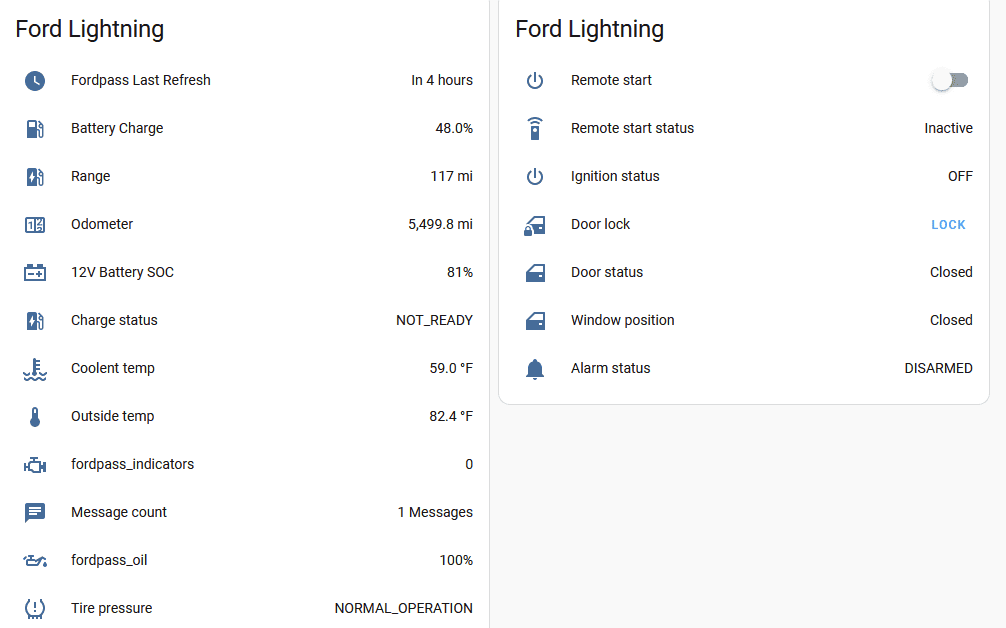

@sstevetx Here's mine - just the FP integration turned on. Took a while to realize I had to authorize the second account I set up from the first account. Looks like coolant temp is 59 for both of us - maybe an issue? Not sure what fordpass_oil correlates to. And the last_refresh doesn't make sense.

I just checked HA and mine still shows 59, so that must be a bug. I used car scanner (screenshot below) and my engine coolant is actually 91.4F currently.
Refresh is odd on mine too showing 5 hours. If you go into settings, devices, ford pass and click device you can see a logbook section at the bottom showing refreshes. Mine is refreshing every 15 minutes in reality. I know this is a work in progress still, but it is promising.

Looks like coolant temp is 59 for both of us - maybe an issue? .
Coolant temp is mapped to `engineCoolantTemp`. However, now that you mention yours is 59F, I went through and checked all my logs. My `engineCoolantTemp` is ALWAYS 15C (C is default in the json) in my logs. It must not be accurately mapped to the High Voltage Coolant. I took a look around and didn't see anything related to battery coolant, so that might not be returned in the API. I can add a check for that sensor to remove it if the vehicle is an EV.
Oil correlates to `oilLifeRemaining`, which is going to always be 100% for an EV. Similar to the, now known wrong CoolantTemp, I can add an EV check.
Known bug with the way HomeAssistant displays time, I recently fixed this and will be fixed in the next release.
