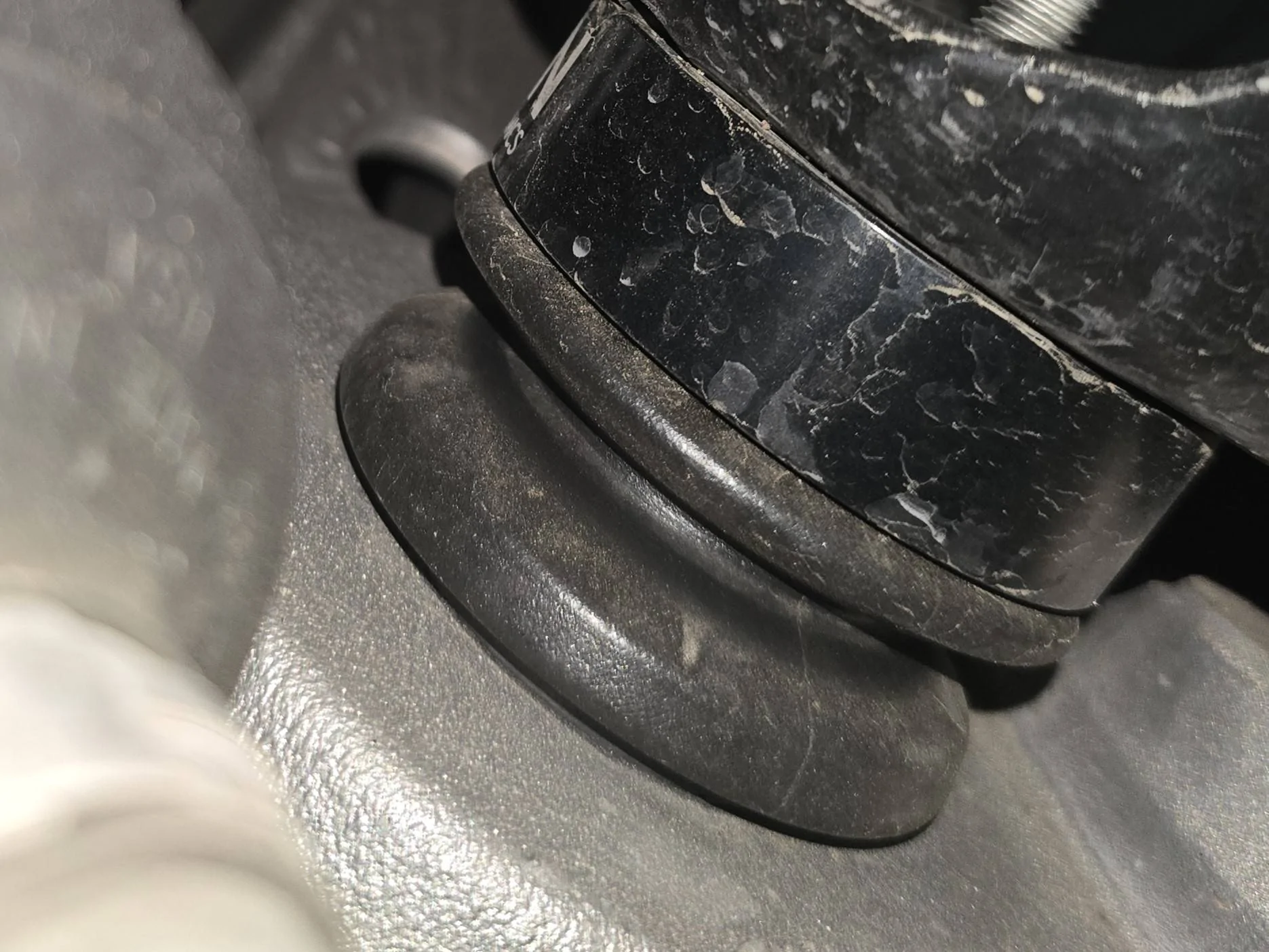

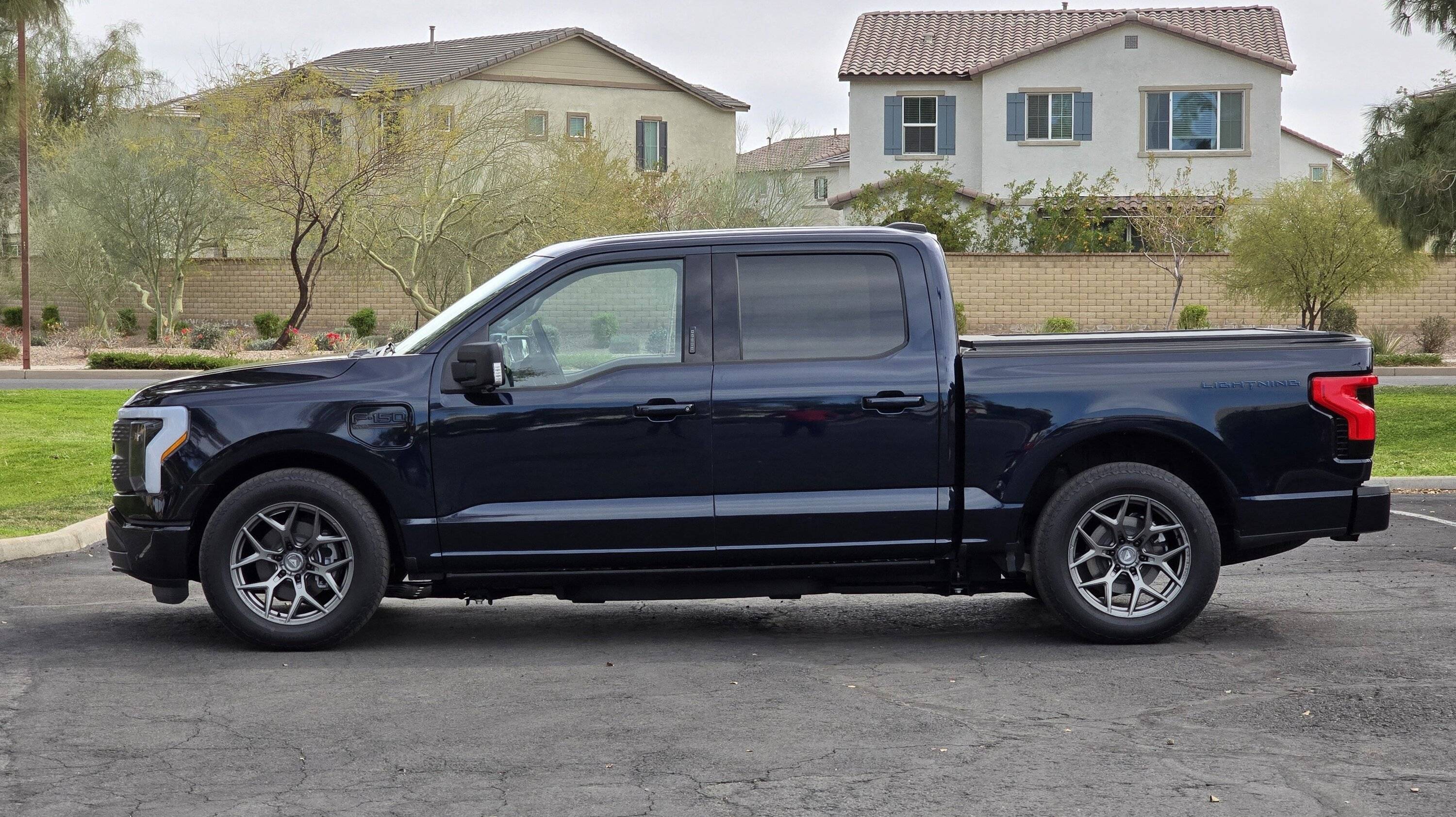

I lowered my truck and also installed the Icon bump stops. They contact the arms just sitting still.
The ride is horrible and I assume this isn't helping. I ordered some universal 1" stops and will try them.
How are other lowered Lightnings dealing with this?

No clue on how to fix it... But that stance with those wheels/tires looks badass. If you could somehow get the rear down another 1.5".... it'd be perfect (at least to me)

You've effectively reduced your suspension travel to the squish of the bump stop. No getting around that without reengineering the suspension.
