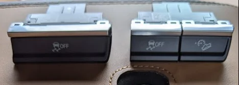

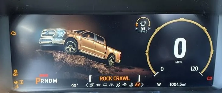

I figured out how to enable HDC (Hill Descent Control) & Rock Crawl driving mode to a non-FX4 4WD. This mod requires the following:

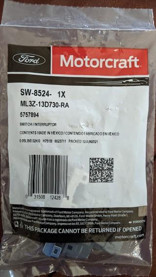

1. The HDC button - in my case it's the split button for HDC & Traction Control p/n: SW8524 / ML3Z-13D730-RA (Note this matches the trim in my Platinum and the p/n for an XLT would be different)

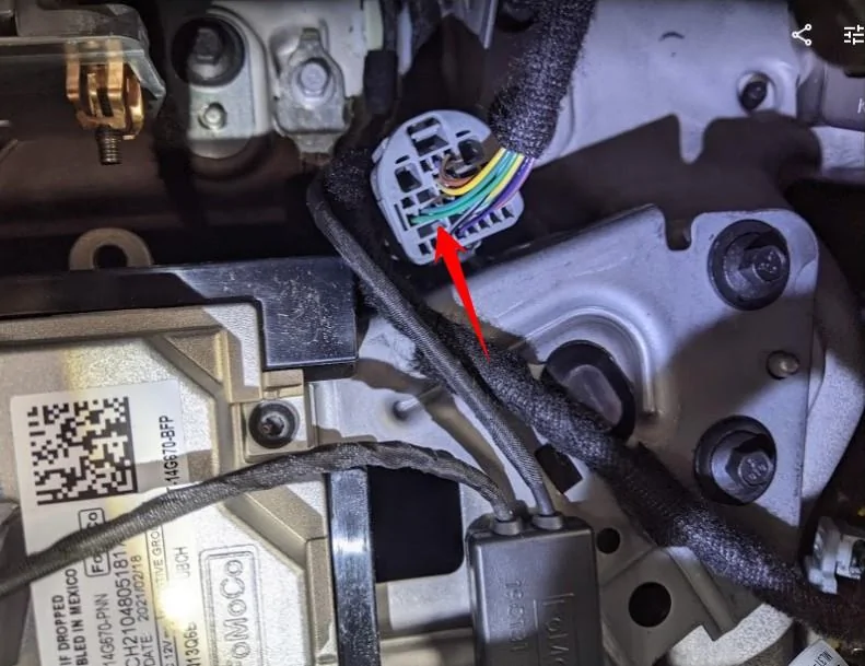

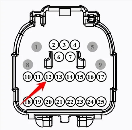

2. Terminals for HDC connector C2304 - pin 4 (female) and inline connector C214 - pin 12 (female) located behind the A/C controls. The Ford part #'s for these terminals are WT1001 & WT1002. These two terminals can be spliced/soldered together and end up being a good length to reach from C2304 to C214.

ABS 760-04-01 xxxx xx8x xx-- enables Rock Crawl drive mode

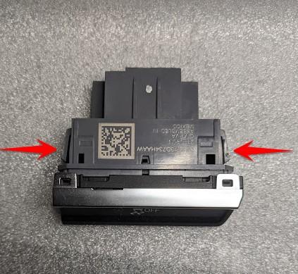

4. Lots of patience removing a lot of trim pieces to access everything. Note: your existing Traction Control Switch is held in place by the protruding prongs on the sides of the switch (see 3rd pic below) and they must be squeezed to push the switch forward out of the trim cutout.
