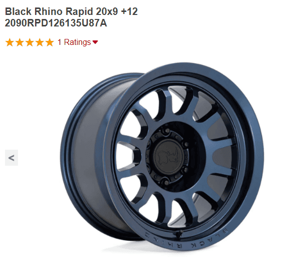

So has anybody figured out what the biggest tire that can fit under the truck without rubbing/cutting? My stock Lariat comes with 275/60R20's.
I've seen where Town & Country Ford put on some 295/60 R20s, but that involved a 2" leveling kit. Tihor managed to get on some 285/65 R20s in another thread, but that also involved a lift after his shock change out didn't go as planned. So is stock as big as you can get without changing out the rims or adding a leveling kit?
I'm planning to change the rims anyway, but was hoping to avoid a lift or level to minimize range loss, as several peeps have commented it isn't so much the tire/wheel combo as changing the aerodynamics from stock that reduces the range. I might be able to put on a more aggressive looking AT tire with a new set of rims and be happy.
Right now I'm thinking:
Ford F-150 Lightning Maximum tire size for F150L - without cutting, lifting or leveling Captur
It might be too "matchy" to my Antimatter blue paint, so we will need to see it in person. On the positive side, it apparently weighs 3 lbs. per rim less than stock Lariat wheels.
I guess I'm asking what the biggest tire anyone has put on that didn't involve a lift? Which just happens to be what the OP was asking...

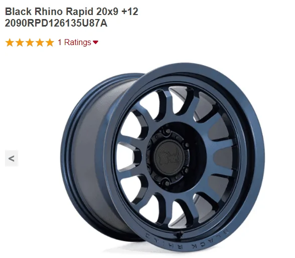

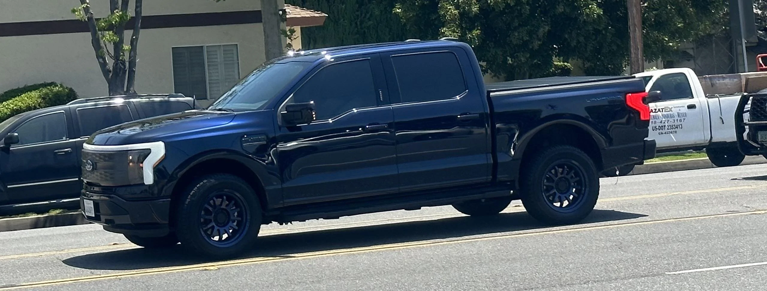

I sold my wheels to my Brother who has an antimatter blue, no lift, stock tire size
Ford F-150 Lightning Maximum tire size for F150L - without cutting, lifting or leveling IMG_2190
Looks sharp! I might have to pull the trigger.
