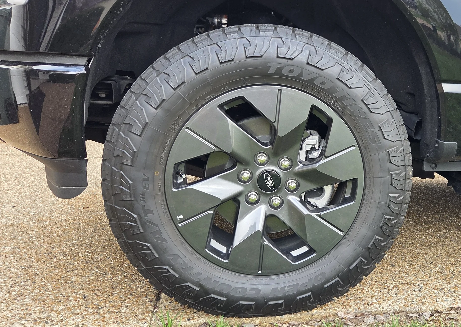

I just installed a RC 2" leveling kit, and put 275/65r20 Toyo AT III EV tires on factory 20" wheels. I would say that is about as big as you can go with 2" lift, very little room at front of fender, but no rubbing. Tire spec says its a 34.1" tire. I can go grab a picture here in a bit. Bottom line - it fits but barely. Looks great though!

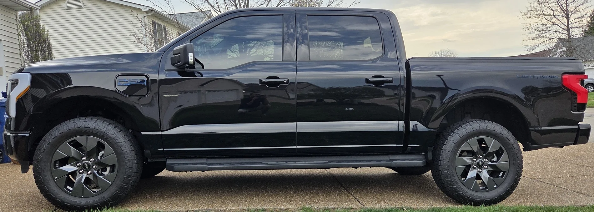

Here are some pics of the 275/65 with a 2" lift, and the wheel well clearance. I think this is about as big as you would want to go, yet still fill the fenders. Others may have gotten away with larger, but happy with my setup. Feels more like a truck for sure. Average about 1.9 to 2.1 miles/kwh. Tires are super light at 43 lbs each, so that helps.
This is the exact setup I was looking to do, nice to see someone has already done it with success. Great looking setup. What lift did you go with and why?
