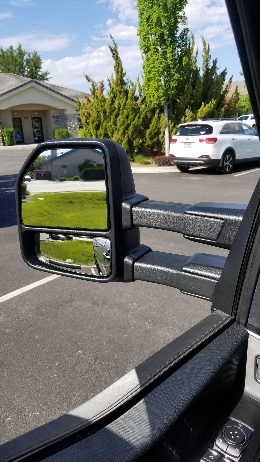

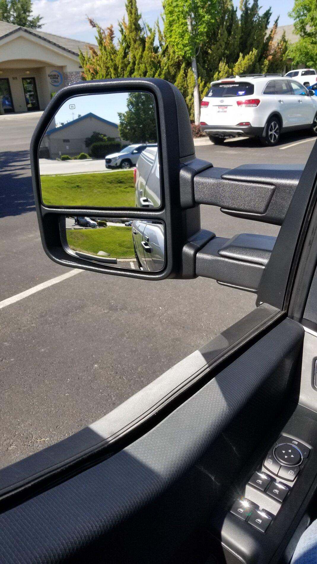

The YouTube vid of 2020 mirrors being altered a bit and fitting a 2021 stx xl (my case) is true. I had to remove more of the plastic structure inside the mirror mount on the driver's side but it's doable. I also used a uni-bit to enlarge the 2 most forward built holes in the door. Also had to make a small notch in the door (¼"x¼) for part of the aluminum rigidity thing. Passenger motor went on with very little alterations.
I don't have any gaps like the YouTube guy did when finished.
These have power mirrors.
